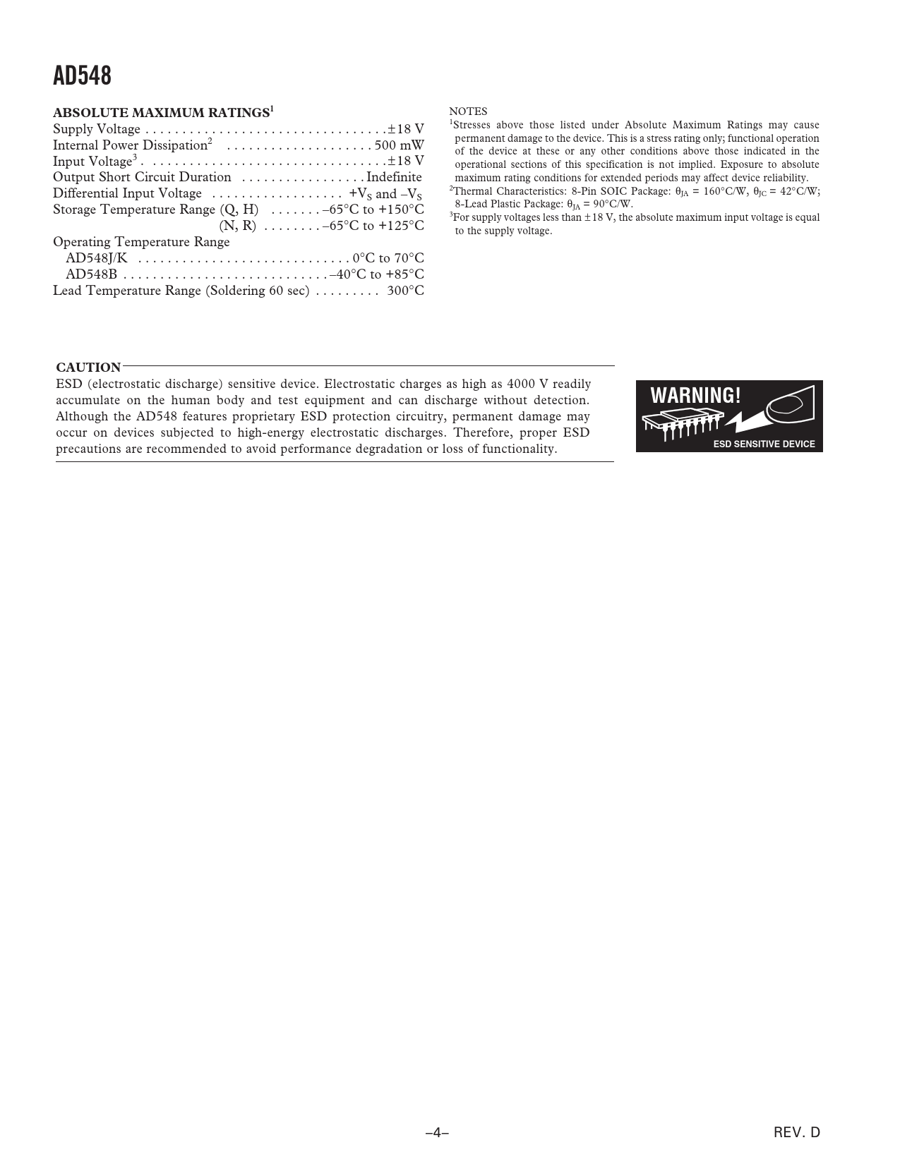

AD548. ABSOLUTE MAXIMUM RATINGSl. CAUTION. WARNING!. ESD SENSITIVE DEVICE
AD548 ABSOLUTE MAXIMUM RATINGSl CAUTION WARNING! ESD SENSITIVE DEVICE
NOTES 1 Supply Voltage . ± 18 V Stresses above those listed under Absolute Maximum Ratings may cause permanent damage to the device. This is a stress rating only; functional operation Internal Power Dissipation2 . 500 mW of the device at these or any other conditions above those indicated in the Input Voltage3 . ± 18 V operational sections of this specification is not implied. Exposure to absolute Output Short Circuit Duration . Indefinite maximum rating conditions for extended periods may affect device reliability. Differential Input Voltage . +V 2Thermal Characteristics: 8-Pin SOIC Package: θ S and –VS JA = 160°C/W, θJC = 42°C/W; Storage Temperature Range (Q, H) . –65°C to +150°C 8-Lead Plastic Package: θJA = 90°C/W. 3For supply voltages less than ±18 V, the absolute maximum input voltage is equal (N, R) . –65°C to +125°C to the supply voltage. Operating Temperature Range AD548J/K . 0°C to 70°C AD548B . –40°C to +85°C Lead Temperature Range (Soldering 60 sec) . 300°C
CAUTION
ESD (electrostatic discharge) sensitive device. Electrostatic charges as high as 4000 V readily accumulate on the human body and test equipment and can discharge without detection.
WARNING!
Although the AD548 features proprietary ESD protection circuitry, permanent damage may occur on devices subjected to high-energy electrostatic discharges. Therefore, proper ESD
precautions are recommended to avoid performance degradation or loss of functionality. –4– REV. D
