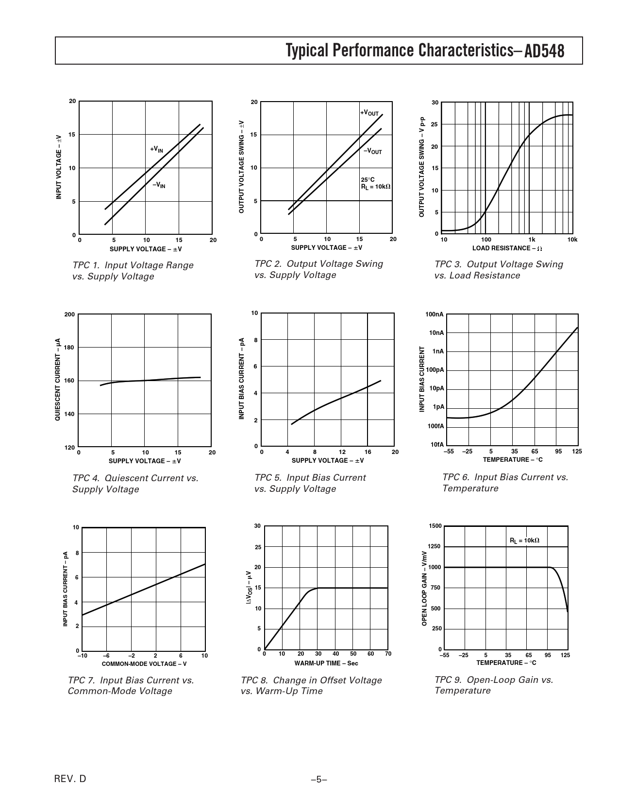

Typical Performance Characteristics– AD548. +VOUT. –VOUT. –VIN. RL = 10k. INPUT VOLTAGE –. OUTPUT VOLTAGE SWING –
Typical Performance Characteristics– AD548 +VOUT –VOUT –VIN RL = 10k INPUT VOLTAGE – OUTPUT VOLTAGE SWING –
Typical Performance Characteristics– AD548 20 20 30 +VOUT 25
V 15 15
V +V 20 IN –VOUT 10 10 15 25
C –VIN RL = 10k 10 INPUT VOLTAGE – 5 5 OUTPUT VOLTAGE SWING – 5 OUTPUT VOLTAGE SWING – V p-p 0 0 0 0 5 10 15 20 0 5 10 15 20 10 100 1k 10k SUPPLY VOLTAGE – V SUPPLY VOLTAGE – V LOAD RESISTANCE –
TPC 1. Input Voltage Range TPC 2. Output Voltage Swing TPC 3. Output Voltage Swing vs. Supply Voltage vs. Supply Voltage vs. Load Resistance
200 10 100nA 10nA 8 180 1nA 6 100pA 160 10pA 4 1pA INPUT BIAS CURRENT 140 QUIESCENT CURRENT – µA INPUT BIAS CURRENT – pA 2 100fA 10fA 120 0 0 5 10 15 20 0 4 8 12 16 20 –55 –25 5 35 65 95 125 SUPPLY VOLTAGE – V SUPPLY VOLTAGE – TEMPERATURE – V
C
TPC 4. Quiescent Current vs. TPC 5. Input Bias Current TPC 6. Input Bias Current vs. Supply Voltage vs. Supply Voltage Temperature
10 30 1500 RL = 10k 25 1250 8 20 1000 V 6
I
– 15 750 OS 4
I∆
V 10 500 INPUT BIAS CURRENT – pA 2 OPEN LOOP GAIN – V/mV 5 250 0 0 0 –10 –6 –2 2 6 10 0 10 20 30 40 50 60 70 –55 –25 5 35 65 95 125 COMMON-MODE VOLTAGE – V WARM-UP TIME – Sec TEMPERATURE –
C
TPC 7. Input Bias Current vs. TPC 8. Change in Offset Voltage TPC 9. Open-Loop Gain vs. Common-Mode Voltage vs. Warm-Up Time Temperature REV. D –5–
