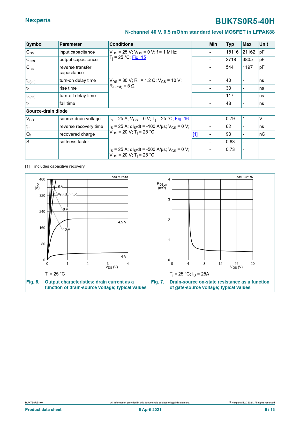

Nexperia. BUK7S0R5-40H. N-channel 40 V, 0.5 mOhm standard level MOSFET in LFPAK88. Symbol. Parameter. Conditions. Min. Typ. Max. Unit
link to page 8 link to page 9 link to page 6
Nexperia BUK7S0R5-40H N-channel 40 V, 0.5 mOhm standard level MOSFET in LFPAK88 Symbol Parameter Conditions Min Typ Max Unit
Ciss input capacitance VDS = 25 V; VGS = 0 V; f = 1 MHz; - 15116 21162 pF C T oss output capacitance j = 25 °C; Fig. 15 - 2718 3805 pF Crss reverse transfer - 544 1197 pF capacitance td(on) turn-on delay time VDS = 30 V; RL = 1.2 Ω; VGS = 10 V; - 40 - ns t R r rise time G(ext) = 5 Ω - 33 - ns td(of ) turn-of delay time - 117 - ns tf fall time - 48 - ns
Source-drain diode
VSD source-drain voltage IS = 25 A; VGS = 0 V; Tj = 25 °C; Fig. 16 - 0.79 1 V trr reverse recovery time IS = 25 A; dIS/dt = -100 A/µs; VGS = 0 V; - 62 - ns Q V r recovered charge DS = 20 V; Tj = 25 °C [1] - 93 - nC S softness factor - 0.83 - IS = 25 A; dIS/dt = -500 A/µs; VGS = 0 V; - 0.73 - VDS = 20 V; Tj = 25 °C [1] includes capacitive recovery aaa-032615 400 aaa-032616 4 ID RD R S D o S n o (A) A 5 5 V (m ( Ω m ) 320 VG V S G = = 5. 5 5 5 V 3 240 6 6 V 2 4. 4 5 . 5 V 160 10 1 0 V 1 80 4 4 V 0 0 0 1 2 3 4 0 4 8 12 16 20 VDS (V) VGS (V) Tj = 25 °C Tj = 25 °C; ID = 25A
Fig. 6. Output characteristics; drain current as a Fig. 7. Drain-source on-state resistance as a function function of drain-source voltage; typical values of gate-source voltage; typical values
