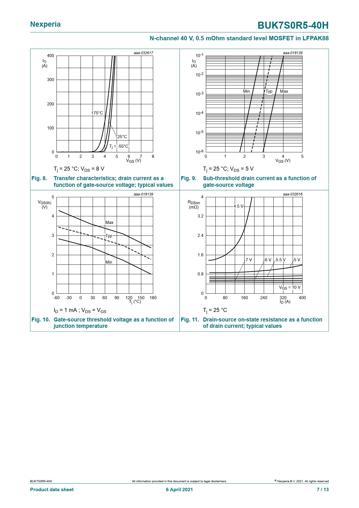

Nexperia. BUK7S0R5-40H. N-channel 40 V, 0.5 mOhm standard level MOSFET in LFPAK88
Nexperia BUK7S0R5-40H N-channel 40 V, 0.5 mOhm standard level MOSFET in LFPAK88
aaa-032617 400 aaa-018138 10-1 ID ID (A) A (A ( ) A 10-2 300 Min Ty T p y Ma M x a 10-3 200 17 1 5 7 °C ° 10-4 100 10-5 25 2 ° 5 C ° Tj T = - 5 - 5° 5 C ° 0 10-6 0 1 2 3 4 5 6 7 8 0 1 2 3 4 5 VGS (V) VGS (V) Tj = 25 °C; VDS = 8 V Tj = 25 °C; VDS = 5 V
Fig. 8. Transfer characteristics; drain current as a Fig. 9. Sub-threshold drain current as a function of function of gate-source voltage; typical values gate-source voltage
aaa-018139 5 aaa-032618 4 VGS( S t(h) h RD R S D o S n o (V) V (m ( Ω m ) 4. 4 5 5 V 4 3.2 Max a 3 Ty T p 2.4 2 1.6 Min 7 7 V 6 6 V 5. 5 5 . 5 V 5 5 V 1 0.8 VGS = 1 0 1 0 V 0 0 -60 -30 0 30 60 90 120 150 180 0 80 160 240 320 400 Tj (°C) ID (A) ID = 1 mA ; VDS = VGS Tj = 25 °C
Fig. 10. Gate-source threshold voltage as a function of Fig. 11. Drain-source on-state resistance as a function junction temperature of drain current; typical values
