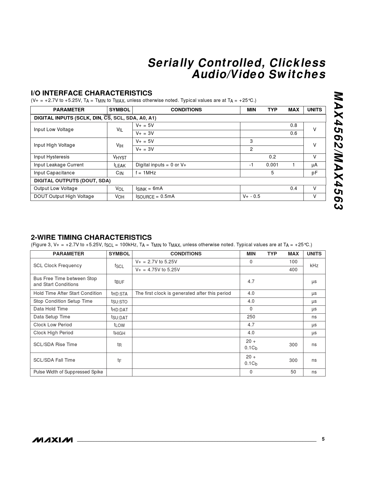

Serially Controlled, Clickless. Audio/Video Switches. MAX4562/MAX4563. I/O INTERFACE CHARACTERISTICS. PARAMETER. SYMBOL. CONDITIONS
Serially Controlled, Clickless Audio/Video Switches MAX4562/MAX4563 I/O INTERFACE CHARACTERISTICS PARAMETER SYMBOL CONDITIONS
(V+ = +2.7V to +5.25V, TA = TMIN to TMAX, unless otherwise noted. Typical values are at TA = +25°C.)
PARAMETER SYMBOL CONDITIONS MIN TYP MAX UNITS DIGITAL INPUTS (SCLK, DIN,
CS
, SCL, SDA, A0, A1)
V+ = 5V 0.8 Input Low Voltage VIL V V+ = 3V 0.6 V+ = 5V 3 Input High Voltage VIH V V+ = 3V 2 Input Hysteresis VHYST 0.2 V Input Leakage Current ILEAK Digital inputs = 0 or V+ -1 0.001 1 µA Input Capacitance CIN f = 1MHz 5 pF
DIGITAL OUTPUTS (DOUT, SDA)
Output Low Voltage VOL ISINK = 6mA 0.4 V DOUT Output High Voltage VOH ISOURCE = 0.5mA V+ - 0.5 V
2-WIRE TIMING CHARACTERISTICS
(Figure 3, V+ = +2.7V to +5.25V, fSCL = 100kHz, TA = TMIN to TMAX, unless otherwise noted. Typical values are at TA = +25°C.)
V+ = 2.7V to 5.25V 0 100 SCL Clock Frequency fSCL kHz V+ = 4.75V to 5.25V 400 Bus Free Time between Stop tBUF 4.7 µs and Start Conditions Hold Time After Start Condition tHD:STA The first clock is generated after this period 4.0 µs Stop Condition Setup Time tSU:STO 4.0 µs Data Hold Time tHD:DAT 0 µs Data Setup Time tSU:DAT 250 ns Clock Low Period tLOW 4.7 µs Clock High Period tHIGH 4.0 µs 20 + SCL/SDA Rise Time tR 300 ns 0.1Cb 20 + SCL/SDA Fall Time tF 300 ns 0.1Cb Pulse Width of Suppressed Spike 0 50 ns
