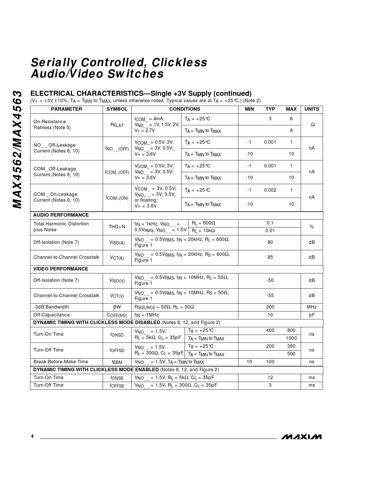

Serially Controlled, Clickless Audio/Video Switches. ELECTRICAL CHARACTERISTICS—Single +3V Supply (continued). PARAMETER
Serially Controlled, Clickless Audio/Video Switches ELECTRICAL CHARACTERISTICS—Single +3V Supply (continued) PARAMETER
(V+ = +3V ±10%, TA = TMIN to TMAX, unless otherwise noted. Typical values are at TA = +25°C.) (Note 2)
PARAMETER SYMBOL CONDITIONS MIN TYP MAX UNITS
ICOM_ = 4mA; TA = +25°C 3 6 On-Resistance R V Ω Flatness (Note 5) FLAT NO_ _ = 1V, 1.5V, 2V; V+ = 2.7V TA = TMIN to TMAX 8 VCOM_ = 0.5V, 3V; TA = +25°C -1 0.001 1 NO_ _ Off-Leakage I V nA Current (Notes 6, 10) NO_ _(OFF) NO_ _ = 3V, 0.5V; V+ = 3.6V TA = TMIN to TMAX -10 10 VCOM_ = 0.5V, 3V; TA = +25°C -1 0.001 1 COM_ Off-Leakage I V nA Current (Notes 6, 10) COM_(OFF) NO_ _ = 3V, 0.5V; V+ = 3.6V TA = TMIN to TMAX -10 10 VCOM_ = 3V, 0.5V; TA = +25°C -1 0.002 1 COM _ On-Leakage V I NO_ _ = 3V, 0.5V, nA Current (Notes 6, 10) COM_(ON) or floating;
MAX4562/MAX4563
TA = TMIN to TMAX -10 10 V+ = 3.6V
AUDIO PERFORMANCE
Total Harmonic Distortion f RL = 600Ω 0.1 THD+N IN = 1kHz, VNO_ _ = % plus Noise 0.5VRMS, VNO_ _ = 1.5V RL = 10kΩ 0.01 V Off-Isolation (Note 7) V NO_ _ = 0.5VRMS, fIN = 20kHz, RL = 600Ω, ISO(A) 80 dB Figure 1 V Channel-to-Channel Crosstalk V NO_ _ = 0.5VRMS, fIN = 20kHz, RS = 600Ω, CT(A) 85 dB Figure 1
VIDEO PERFORMANCE
V Off-Isolation (Note 7) V NO_ _ = 0.5VRMS, fIN = 10MHz, RL = 50Ω, ISO(V) -50 dB Figure 1 V Channel-to-Channel Crosstalk V NO_ _ = 0.5VRMS, fIN = 10MHz, RS = 50Ω, CT(V) -55 dB Figure 1 -3dB Bandwidth BW RSOURCE = 50Ω, RL = 50Ω 200 MHz Off-Capacitance COFF(NO) fIN = 1MHz 10 pF
DYNAMIC TIMING WITH CLICKLESS MODE DISABLED
(Notes 8, 12, and Figure 2) T V A = +25°C 400 800 Turn-On Time t NO_ _ = 1.5V, ONSD ns RL = 5kΩ, CL = 35pF TA = TMIN to TMAX 1000 T V A = +25°C 200 350 Turn-Off Time t NO_ _ = 1.5V, OFFSD ns RL = 300Ω, CL = 35pF TA = TMIN to TMAX 500 Break-Before-Make Time tBBM VNO_ _ = 1.5V, TA = TMIN to TMAX 10 100 ns
DYNAMIC TIMING WITH CLICKLESS MODE ENABLED
(Notes 8, 12, and Figure 2) Turn-On Time tONSE VNO_ _ = 1.5V, RL = 5kΩ, CL = 35pF 12 ms Turn-Off Time tOFFSE VNO_ _ = 1.5V, RL = 300Ω, CL = 35pF 3 ms
