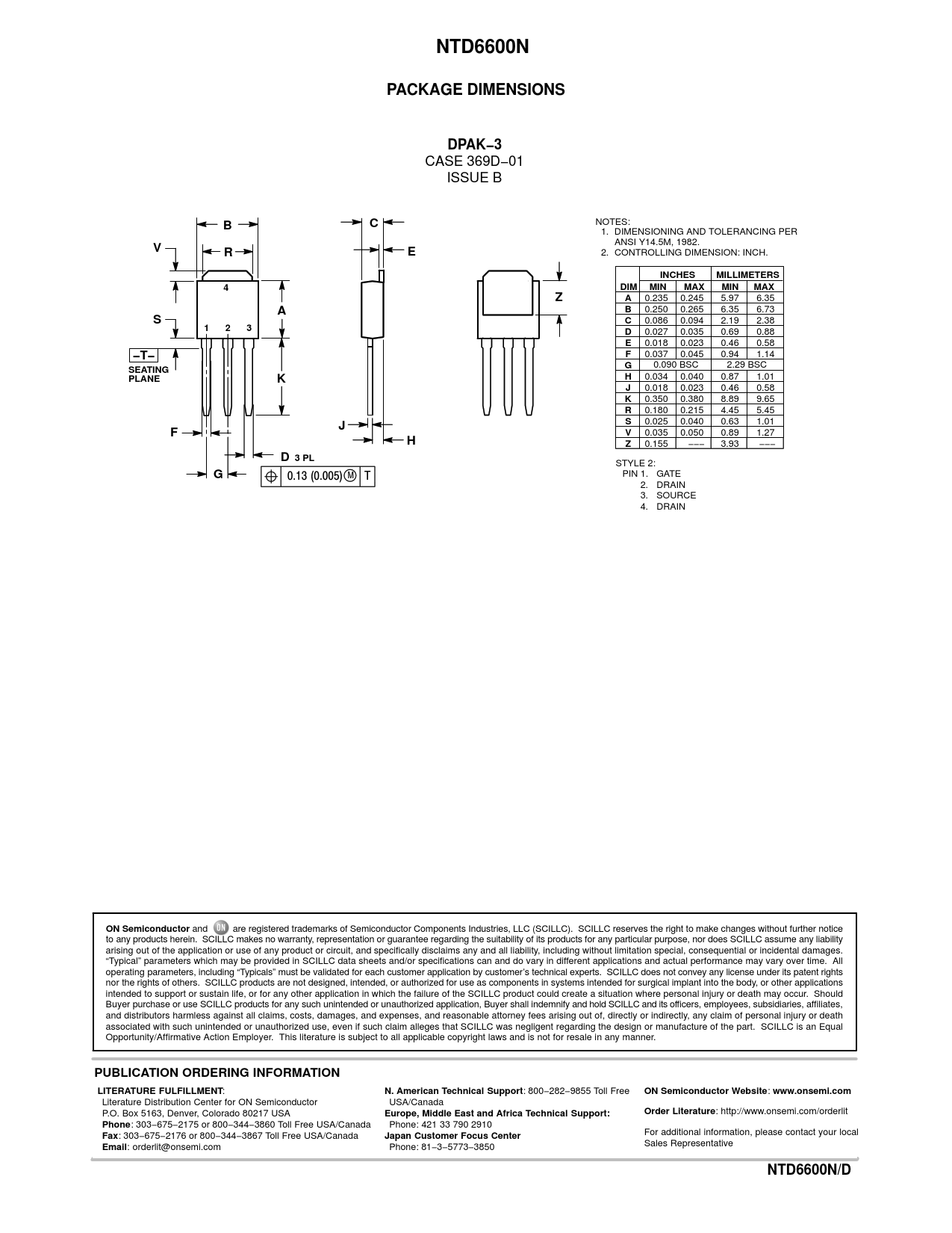

NTD6600N. PACKAGE DIMENSIONS. DPAK−3. INCHES. MILLIMETERS. DIM. MIN. MAX. −T−. SEATING PLANE. D 3 PL. ON Semiconductor
NTD6600N PACKAGE DIMENSIONS DPAK−3 INCHES MILLIMETERS DIM MIN MAX −T− SEATING PLANE D 3 PL ON Semiconductor
CASE 369D−01 ISSUE B
B C
NOTES: 1. DIMENSIONING AND TOLERANCING PER ANSI Y14.5M, 1982.
V R E
2. CONTROLLING DIMENSION: INCH.
INCHES MILLIMETERS 4 DIM MIN MAX MIN MAX Z A
0.235 0.245 5.97 6.35
A B
0.250 0.265 6.35 6.73
S C
0.086 0.094 2.19 2.38
1 2 3 D
0.027 0.035 0.69 0.88
E
0.018 0.023 0.46 0.58
−T− F
0.037 0.045 0.94 1.14
G
0.090 BSC 2.29 BSC
SEATING PLANE K H
0.034 0.040 0.87 1.01
J
K
0.350 0.380 8.89 9.65
R
0.180 0.215 4.45 5.45
J S
0.025 0.040 0.63 1.01
F V
0.035 0.050 0.89 1.27
H Z
0.155 −−− 3.93 −−−
D 3 PL
STYLE 2: PIN 1. GATE
G
0.13 (0.005) M T 2. DRAIN 3. SOURCE 4. DRAIN
