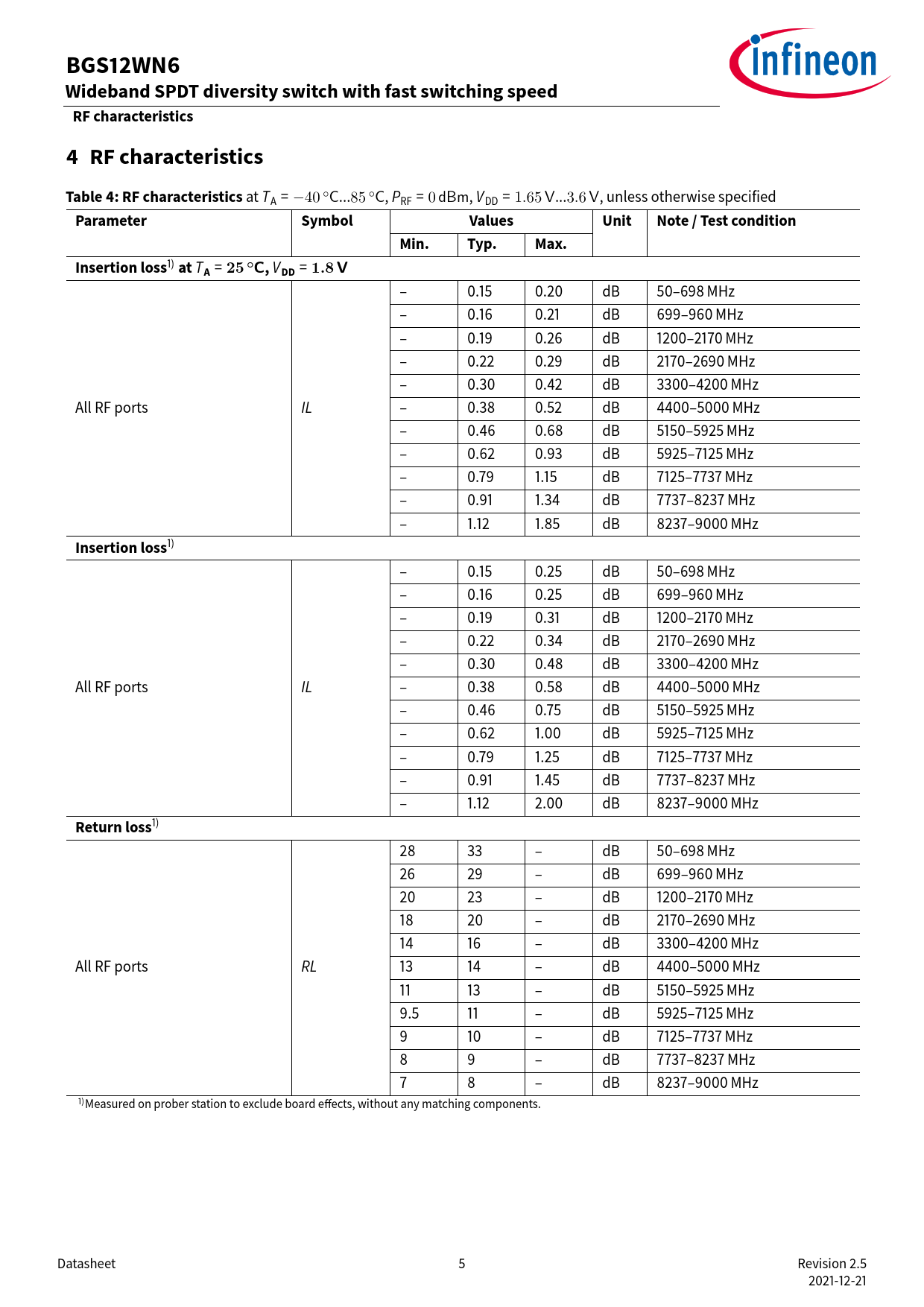

BGS12WN6. Wideband SPDT diversity switch with fast switching speed. RF characteristics. 4 RF characteristics
BGS12WN6 Wideband SPDT diversity switch with fast switching speed RF characteristics 4 RF characteristics Table 4: RF characteristics
at TA = −40 ◦C...85 ◦C, PRF = 0 dBm, VDD = 1.65 V...3.6 V, unless otherwise specified
Parameter Symbol Values Unit Note / Test condition Min. Typ. Max. Insertion loss
1)
at
T = =
A
25 ◦C
V
DD
1.8 V – 0.15 0.20 dB 50–698 MHz – 0.16 0.21 dB 699–960 MHz – 0.19 0.26 dB 1200–2170 MHz – 0.22 0.29 dB 2170–2690 MHz – 0.30 0.42 dB 3300–4200 MHz All RF ports IL – 0.38 0.52 dB 4400–5000 MHz – 0.46 0.68 dB 5150–5925 MHz – 0.62 0.93 dB 5925–7125 MHz – 0.79 1.15 dB 7125–7737 MHz – 0.91 1.34 dB 7737–8237 MHz – 1.12 1.85 dB 8237–9000 MHz
Insertion loss
1) – 0.15 0.25 dB 50–698 MHz – 0.16 0.25 dB 699–960 MHz – 0.19 0.31 dB 1200–2170 MHz – 0.22 0.34 dB 2170–2690 MHz – 0.30 0.48 dB 3300–4200 MHz All RF ports IL – 0.38 0.58 dB 4400–5000 MHz – 0.46 0.75 dB 5150–5925 MHz – 0.62 1.00 dB 5925–7125 MHz – 0.79 1.25 dB 7125–7737 MHz – 0.91 1.45 dB 7737–8237 MHz – 1.12 2.00 dB 8237–9000 MHz
Return loss
1) 28 33 – dB 50–698 MHz 26 29 – dB 699–960 MHz 20 23 – dB 1200–2170 MHz 18 20 – dB 2170–2690 MHz 14 16 – dB 3300–4200 MHz All RF ports RL 13 14 – dB 4400–5000 MHz 11 13 – dB 5150–5925 MHz 9.5 11 – dB 5925–7125 MHz 9 10 – dB 7125–7737 MHz 8 9 – dB 7737–8237 MHz 7 8 – dB 8237–9000 MHz 1)Measured on prober station to exclude board effects, without any matching components. Datasheet 5 Revision 2.5 2021-12-21 Document Outline Titlepage 1 Features 2 Absolute maximum ratings 3 Operation ranges 4 RF characteristics 5 Application information 6 Package information
