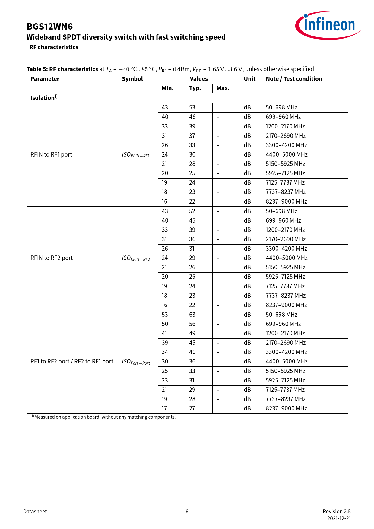

BGS12WN6. Wideband SPDT diversity switch with fast switching speed. RF characteristics. Table 5: RF characteristics. Parameter
BGS12WN6 Wideband SPDT diversity switch with fast switching speed RF characteristics Table 5: RF characteristics
at TA = −40 ◦C...85 ◦C, PRF = 0 dBm, VDD = 1.65 V...3.6 V, unless otherwise specified
Parameter Symbol Values Unit Note / Test condition Min. Typ. Max. Isolation
1) 43 53 – dB 50–698 MHz 40 46 – dB 699–960 MHz 33 39 – dB 1200–2170 MHz 31 37 – dB 2170–2690 MHz 26 33 – dB 3300–4200 MHz RFIN to RF1 port ISORFIN−RF1 24 30 – dB 4400–5000 MHz 21 28 – dB 5150–5925 MHz 20 25 – dB 5925–7125 MHz 19 24 – dB 7125–7737 MHz 18 23 – dB 7737–8237 MHz 16 22 – dB 8237–9000 MHz 43 52 – dB 50–698 MHz 40 45 – dB 699–960 MHz 33 39 – dB 1200–2170 MHz 31 36 – dB 2170–2690 MHz 26 31 – dB 3300–4200 MHz RFIN to RF2 port ISORFIN−RF2 24 29 – dB 4400–5000 MHz 21 26 – dB 5150–5925 MHz 20 25 – dB 5925–7125 MHz 19 24 – dB 7125–7737 MHz 18 23 – dB 7737–8237 MHz 16 22 – dB 8237–9000 MHz 53 63 – dB 50–698 MHz 50 56 – dB 699–960 MHz 41 49 – dB 1200–2170 MHz 39 45 – dB 2170–2690 MHz 34 40 – dB 3300–4200 MHz RF1 to RF2 port / RF2 to RF1 port ISOPort−Port 30 36 – dB 4400–5000 MHz 25 33 – dB 5150–5925 MHz 23 31 – dB 5925–7125 MHz 21 29 – dB 7125–7737 MHz 19 28 – dB 7737–8237 MHz 17 27 – dB 8237–9000 MHz 1)Measured on application board, without any matching components. Datasheet 6 Revision 2.5 2021-12-21 Document Outline Titlepage 1 Features 2 Absolute maximum ratings 3 Operation ranges 4 RF characteristics 5 Application information 6 Package information
