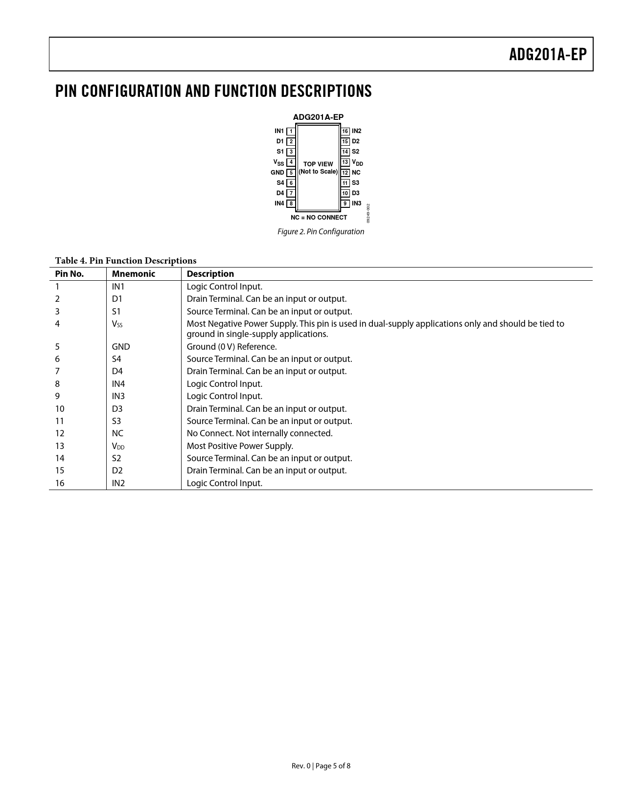

ADG201A-EP. PIN CONFIGURATION AND FUNCTION DESCRIPTIONS. IN1. 16 IN2. 15 D2. 14 S2. VSS 4. 13 VDD. TOP VIEW. GND. (Not to Scale) 12 NC. 11 S3
ADG201A-EP PIN CONFIGURATION AND FUNCTION DESCRIPTIONS IN1 16 IN2 15 D2 14 S2 VSS 4 13 VDD TOP VIEW GND (Not to Scale) 12 NC 11 S3
ADG201A-EP PIN CONFIGURATION AND FUNCTION DESCRIPTIONS ADG201A-EP IN1 1 16 IN2 D1 2 15 D2 S1 3 14 S2 VSS 4 13 VDD TOP VIEW GND 5 (Not to Scale) 12 NC S4 6 11 S3 D4 7 10 D3 IN4 8 9 IN3
002
NC = NO CONNECT
09249- Figure 2. Pin Configuration
Table 4. Pin Function Descriptions Pin No. Mnemonic Description
1 IN1 Logic Control Input. 2 D1 Drain Terminal. Can be an input or output. 3 S1 Source Terminal. Can be an input or output. 4 VSS Most Negative Power Supply. This pin is used in dual-supply applications only and should be tied to ground in single-supply applications. 5 GND Ground (0 V) Reference. 6 S4 Source Terminal. Can be an input or output. 7 D4 Drain Terminal. Can be an input or output. 8 IN4 Logic Control Input. 9 IN3 Logic Control Input. 10 D3 Drain Terminal. Can be an input or output. 11 S3 Source Terminal. Can be an input or output. 12 NC No Connect. Not internally connected. 13 VDD Most Positive Power Supply. 14 S2 Source Terminal. Can be an input or output. 15 D2 Drain Terminal. Can be an input or output. 16 IN2 Logic Control Input. Rev. 0 | Page 5 of 8 Document Outline Features Enhanced Product Features Functional Block Diagram General Description Product Highlights Revision History Specifications Dual Supply Absolute Maximum Ratings ESD Caution Pin Configuration and Function Descriptions Test Circuits Outline Dimensions Ordering Guide
