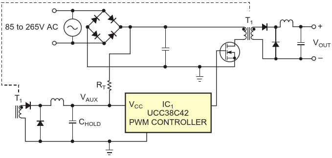

An auxiliary winding supplies power to the supply's PWM controller

Shunt regulator eases power-supply-start-up woes
Figure 1. An uncomplicated block diagram (a) conceals the TL431's internal complexity, but you need only three external resistors to use the TL431 in a basic shunt-regulator circuit (b)
Figure 2. An auxiliary winding supplies power to the supply's PWM controller
Figure 3. In this improved design, pulse-width-controller IC
1
derives its power from R
T
for start-up, auxiliary winding W
AUX
for normal operation, and shunt-regulator circuit IC
2
and Q
1
for low-load operation
