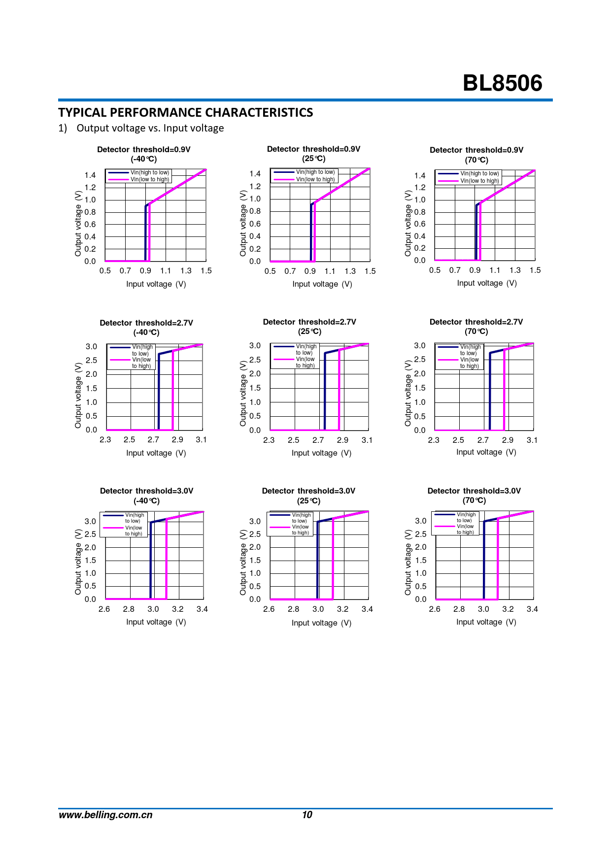

BL8506 TYPICAL PERFORMANCE CHARACTERISTICS
1) Output voltage vs. Input voltage
Detector threshold=0.9V Detector threshold=0.9V Detector threshold=0.9V (-40°C) (25°C) (70°C)
1.4 Vin(high to low) 1.4 Vin(high to low) 1.4 Vin(high to low) Vin(low to high) Vin(low to high) Vin(low to high) 1.2 1.2 1.2 (V) 1.0 (V) 1.0 (V) 1.0 e e e g 0.8 g 0.8 g a 0.8 t a a l tl tl o 0.6 o o v 0.6 0.6 v v t t t u 0.4 u 0.4 u 0.4 pt pt pt u 0.2 u 0.2 u 0.2 O O O 0.0 0.0 0.0 0.5 0.7 0.9 1.1 1.3 1.5 0.5 0.7 0.9 1.1 1.3 1.5 0.5 0.7 0.9 1.1 1.3 1.5 Input voltage (V) Input voltage (V) Input voltage (V)
Detector threshold=2.7V Detector threshold=2.7V Detector threshold=2.7V (-40°C) (25°C) (70°C)
3.0 Vin(high 3.0 Vin(high 3.0 Vin(high to low) to low) to low) 2.5 Vin(low 2.5 Vin(low 2.5 Vin(low to high) to high) to high) (V) (V) (V) 2.0 2.0 2.0 e e e g g g a a a t 1.5 t l tl 1.5 l 1.5 o o o v v v 1.0 t t 1.0 t 1.0 u u u p p p t 0.5 t t u u 0.5 u 0.5 O O O 0.0 0.0 0.0 2.3 2.5 2.7 2.9 3.1 2.3 2.5 2.7 2.9 3.1 2.3 2.5 2.7 2.9 3.1 Input voltage (V) Input voltage (V) Input voltage (V)
Detector threshold=3.0V Detector threshold=3.0V Detector threshold=3.0V (-40°C) (25°C) (70°C)
Vin(high Vin(high Vin(high 3.0 to low) 3.0 to low) 3.0 to low) Vin(low Vin(low Vin(low 2.5 to high) to high) (V) to high) 2.5 2.5 (V) (V) e 2.0 e e g 2.0 2.0 g a g t a l a t 1.5 t l o l 1.5 1.5 v o o v v t 1.0 t t u 1.0 u 1.0 u pt pt pt u 0.5 u 0.5 u 0.5 O O O 0.0 0.0 0.0 2.6 2.8 3.0 3.2 3.4 2.6 2.8 3.0 3.2 3.4 2.6 2.8 3.0 3.2 3.4 Input voltage (V) Input voltage (V) Input voltage (V)
