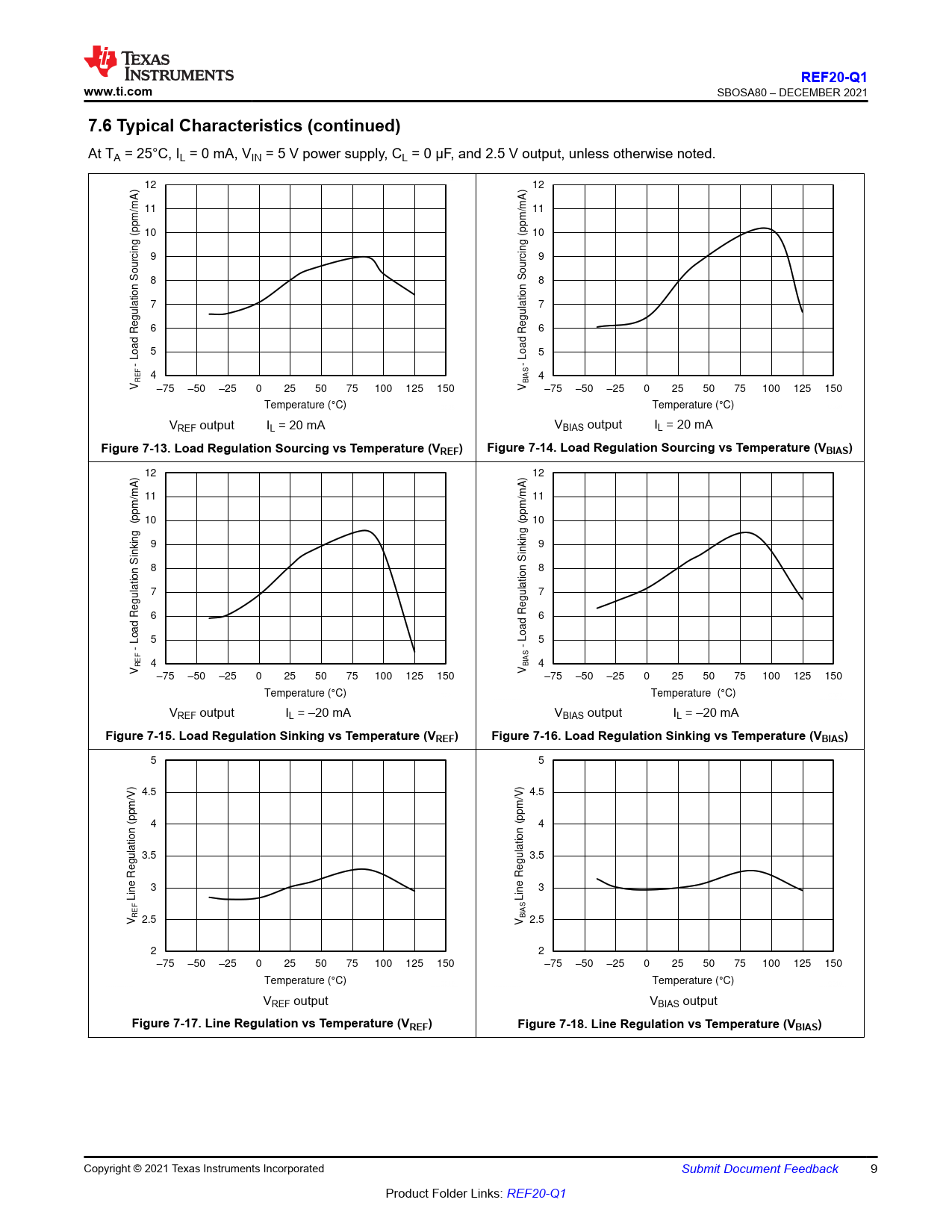

REF20-Q1. www.ti.com. 7.6 Typical Characteristics (continued). Figure 7-13. Load Regulation Sourcing vs Temperature (VREF)
REF20-Q1 www.ti.com 7.6 Typical Characteristics (continued) Figure 7-13 Load Regulation Sourcing vs Temperature (VREF)
REF20-Q1 www.ti.com
SBOSA80 – DECEMBER 2021
At TA = 25°C, IL = 0 mA, VIN = 5 V power supply, CL = 0 µF, and 2.5 V output, unless otherwise noted. 12 ) 12 ) A A /m 11 /m 11 m m p p 10 (p 10 (p g g in in rc 9 rc 9 u u o o S 8 S 8 n n tio tio la 7 la 7 u u g g e e 6 6 R R d d a a o 5 o 5 L - L - F S E 4 IA 4 R B V ±75 ±50 ±25 0 25 50 75 100 125 150 V ±75 ±50 ±25 0 25 50 75 100 125 150 Temperature (ƒC) Temperature ( C025 ƒC) C020 VREF output IL = 20 mA VBIAS output IL = 20 mA
Figure 7-13. Load Regulation Sourcing vs Temperature (VREF) Figure 7-14. Load Regulation Sourcing vs Temperature (VBIAS)
12 ) 12 ) A A /m 11 /m 11 m m p p 10 10 (p (p g g in in k 9 k 9 in in S S n 8 n 8 tio tio la la 7 u u 7 g g e e R 6 R 6 d d a a o o 5 5 - L - L F S E IA R 4 B 4 V V ±75 ±50 ±25 0 25 50 75 100 125 150 ±75 ±50 ±25 0 25 50 75 100 125 150 Temperature (ƒC) C021 Temperature (ƒC) C022 VREF output IL = –20 mA VBIAS output IL = –20 mA
Figure 7-15. Load Regulation Sinking vs Temperature (VREF) Figure 7-16. Load Regulation Sinking vs Temperature (VBIAS)
5 5 ) 4.5 /V 4.5 /V m m p p (p 4 (p 4 n n tio tio la la u 3.5 u 3.5 g g e e R R e 3 e in 3 in L L F S E IA R B V 2.5 2.5 V 2 2 ±75 ±50 ±25 0 25 50 75 100 125 150 ±75 ±50 ±25 0 25 50 75 100 125 150 Temperature (ƒC) C019 Temperature (ƒC) C018 VREF output VBIAS output
Figure 7-17. Line Regulation vs Temperature (VREF) Figure 7-18. Line Regulation vs Temperature (VBIAS)
