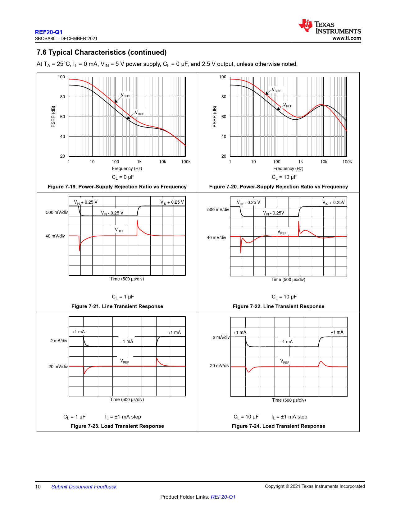

REF20-Q1. www.ti.com. 7.6 Typical Characteristics (continued). Figure 7-19. Power-Supply Rejection Ratio vs Frequency
REF20-Q1 www.ti.com 7.6 Typical Characteristics (continued) Figure 7-19 Power-Supply Rejection Ratio vs Frequency
REF20-Q1
SBOSA80 – DECEMBER 2021
At TA = 25°C, IL = 0 mA, VIN = 5 V power supply, CL = 0 µF, and 2.5 V output, unless otherwise noted. 100 100 VBIAS 80 VBIAS 80 ) VREF B B (d VREF (d R 60 R 60 R R S S P P 40 40 20 20 1 10 100 1k 10k 100k 1 10 100 1k 10k 100k Frequency (Hz) Frequency (Hz) C026 C027 CL = 0 µF CL = 10 µF
Figure 7-19. Power-Supply Rejection Ratio vs Frequency Figure 7-20. Power-Supply Rejection Ratio vs Frequency
V V IN + 0.25 V IN + 0.25 V V V IN + 0.25 V IN + 0.25V 500 mV/div 500 mV/div VIN - 0.25 V VIN - 0.25V VREF VREF 40 mV/div 40 mV/div Time (500 µs/div) Time (500 µs/div) C006 C006 CL = 1 µF CL = 10 µF
Figure 7-21. Line Transient Response Figure 7-22. Line Transient Response
+1 mA +1 mA +1 mA +1 mA 2 mA/div 2 mA/div - 1 mA - 1 mA VREF VREF 20 mV/div 20 mV/div Time (500 µs/div) Time (500 µs/div) C032 C037 CL = 1 µF IL = ±1-mA step CL = 10 µF IL = ±1-mA step
Figure 7-23. Load Transient Response Figure 7-24. Load Transient Response
