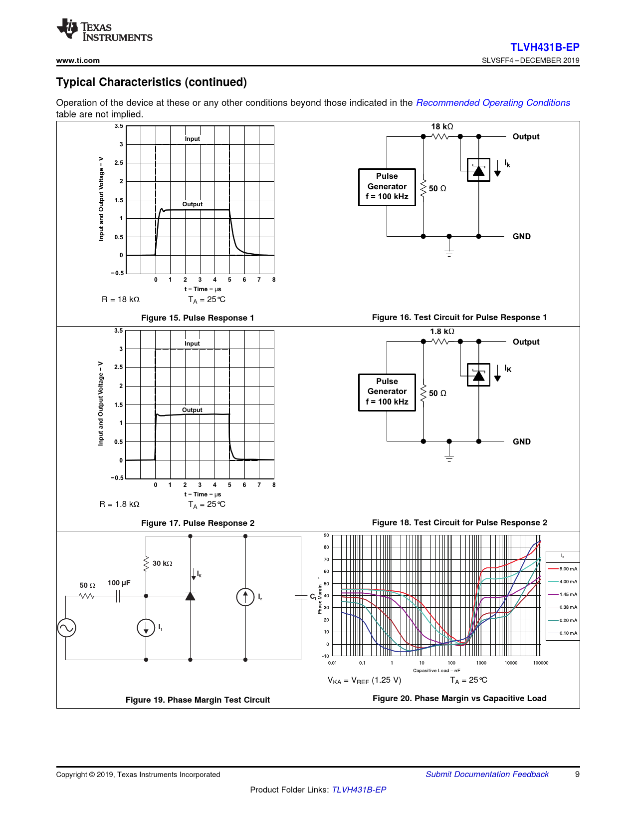

Typical Characteristics (continued)
Operation of the device at these or any other conditions beyond those indicated in the Recommended Operating Conditions table are not implied.
3.5 18 k
Ω
Input Output 3 V − 2.5 Ik e g Pulse lta o 2 V Generator t 50
Ω
u f = 100 kHz tp 1.5 u Output O d n 1 a t u p In 0.5 GND 0 − 0.5 0 1 2 3 4 5 6 7 8 t − Time −
µ
s
R = 18 kΩ TA = 25°C
Figure 15. Pulse Response 1 Figure 16. Test Circuit for Pulse Response 1 3.5 1.8 k
Ω
Input Output 3 V − 2.5 IK e g Pulse lta o 2 V Generator t 50
Ω
µ
s
R = 1.8 kΩ TA = 25°C
Figure 17. Pulse Response 2 Figure 18. Test Circuit for Pulse Response 2 IK 30 k
W
IK 50
W
100 µF I C 2 L I1
VKA = VREF (1.25 V) TA = 25°C
Figure 19. Phase Margin Test Circuit Figure 20. Phase Margin vs Capacitive Load
