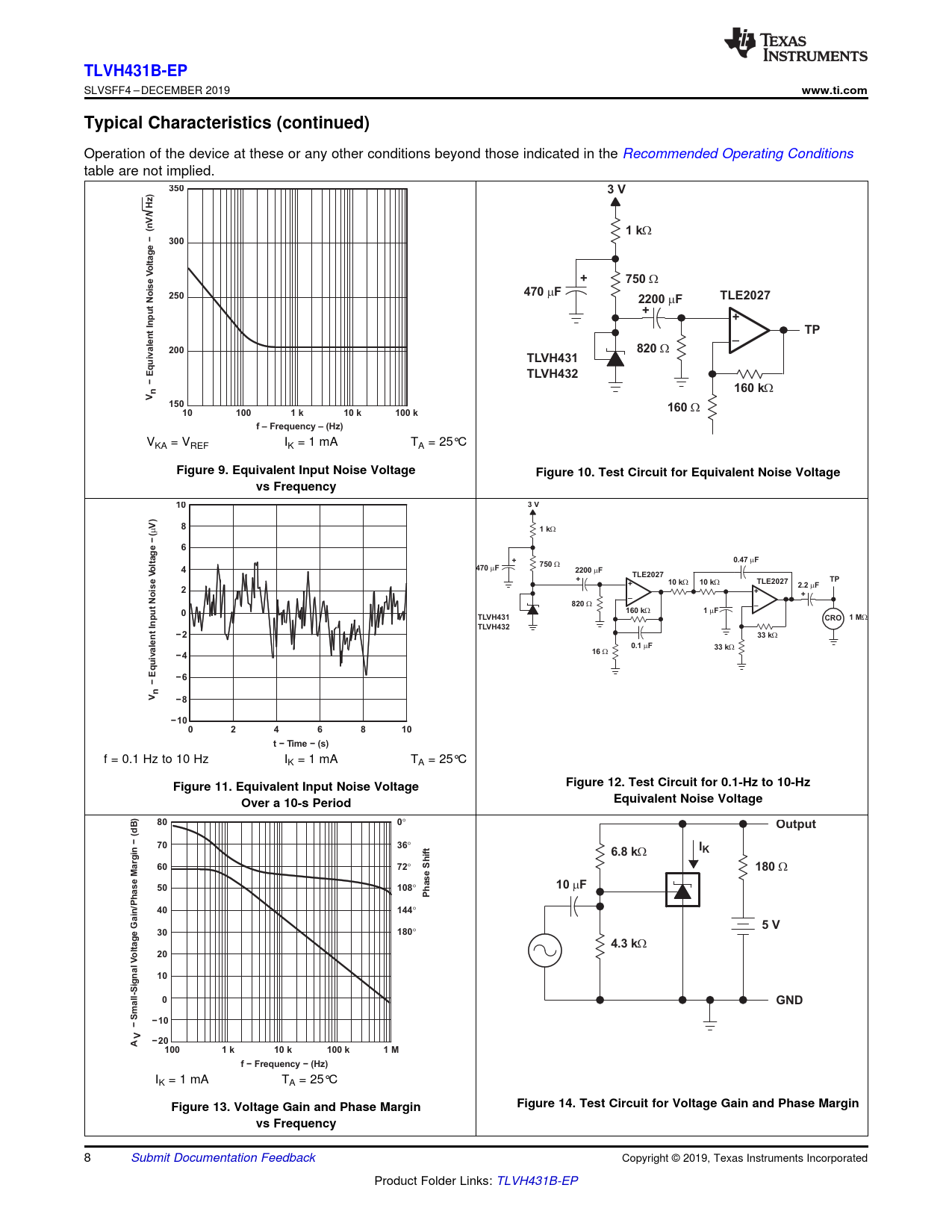

Pages / Page29 / 8 — TLVH431B-EP. www.ti.com. Typical Characteristics (continued). 350. 3 V. …
TLVH431B-EP. www.ti.com. Typical Characteristics (continued). 350. 3 V. Hz). (nV/. 1 k. 300. e g lta o e V. 750. is o. 470. 250. 2200. TLE2027. t N u
TLVH431B-EP www.ti.com Typical Characteristics (continued) 350 3 V Hz) (nV/ 1 k 300 e g lta o e V 750 is o 470 250 2200 TLE2027 t N u

TLVH431B-EP
SLVSFF4 – DECEMBER 2019
W
− 300 e g lta o e V + 750
W
is o 470
m
F 250 2200
m
F TLE2027 t N u + p + n t I n _ TP le a 200 820
W
iv TLVH431 u q E TLVH432 − n 160 k
W
V 150 160
W
10 100 1 k 10 k 100 k f – Frequency – (Hz)
VKA = VREF IK = 1 mA TA = 25°C
Figure 9. Equivalent Input Noise Voltage Figure 10. Test Circuit for Equivalent Noise Voltage vs Frequency 10 3 V V) 8 1 k (
m W
− e 6 g lta + 0.47
m
F 750 o
W
4 470
m
F 2200
m
F TLE2027 e V + TP + 10 k
W
10 k
W
TLE2027 is 2.2
m
F 2 o + _ + _ t N 820
W
u 0 160 k
W
1
m
F p TLVH431 CRO 1 M
W
n TLVH432 t I −2 n 33 k
W
le a 0.1
m
F 33 k
W
16
W
iv −4 u q E −6 − nV −8 −100 2 4 6 8 10 t − Time − (s)
f = 0.1 Hz to 10 Hz IK = 1 mA TA = 25°C
Figure 11. Equivalent Input Noise Voltage Figure 12. Test Circuit for 0.1-Hz to 10-Hz Over a 10-s Period Equivalent Noise Voltage ) B 80 0
Output (d − 70 36
I in ift K 6.8 k
W
rg h a 60 72
180
W
e S e M s s a 10
m
F a 50 108
h h P /P in 40 144
a 5 V e G 30 180
g 4.3 k
W
lta o 20 l V a n 10 ig ll-S a 0 GND m S − −10 VA −20100 1 k 10 k 100 k 1 M f − Frequency − (Hz)
IK = 1 mA TA = 25°C
Figure 13. Voltage Gain and Phase Margin Figure 14. Test Circuit for Voltage Gain and Phase Margin vs Frequency
