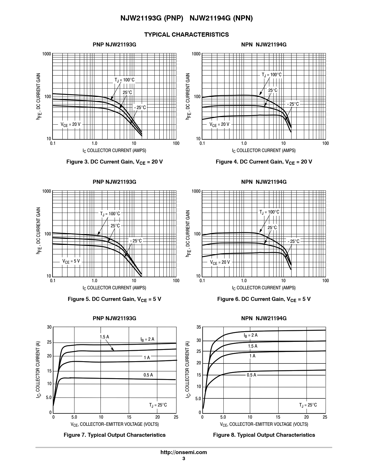

NJW21193G (PNP) NJW21194G (NPN). TYPICAL CHARACTERISTICS. PNP NJW21193G. NPN NJW21194G. Figure 3. DC Current Gain, VCE = 20 V
NJW21193G (PNP) NJW21194G (NPN) TYPICAL CHARACTERISTICS PNP NJW21193G NPN NJW21194G Figure 3 DC Current Gain, VCE = 20 V
1000 1000 TJ = 100°C GAIN TJ = 100°C GAIN 25°C 25°C 100 100 -25°C -25°C , DC CURRENT , DC CURRENT h FE h FE VCE = 20 V VCE = 20 V 10 10 0.1 1.0 10 100 0.1 1.0 10 100 IC COLLECTOR CURRENT (AMPS) IC COLLECTOR CURRENT (AMPS)
Figure 3. DC Current Gain, VCE = 20 V Figure 4. DC Current Gain, VCE = 20 V PNP NJW21193G NPN NJW21194G
1000 1000 T TJ = 100°C GAIN J = 100°C GAIN 25°C 25°C 100 100 -25°C -25°C , DC CURRENT , DC CURRENT h FE h FE VCE = 5 V VCE = 20 V 10 10 0.1 1.0 10 100 0.1 1.0 10 100 IC COLLECTOR CURRENT (AMPS) IC COLLECTOR CURRENT (AMPS)
Figure 5. DC Current Gain, VCE = 5 V Figure 6. DC Current Gain, VCE = 5 V PNP NJW21193G NPN NJW21194G
30 35 1.5 A IB = 2 A I 25 B = 2 A 30 (A) (A) 1.5 A 25 20 1 A 1 A 20 OR CURRENT 15 OR CURRENT 0.5 A 15 0.5 A 10 10 , COLLECT , COLLECT I C I C 5.0 5.0 TJ = 25°C TJ = 25°C 0 0 0 5.0 10 15 20 25 0 5.0 10 15 20 25 VCE, COLLECTOR-EMITTER VOLTAGE (VOLTS) VCE, COLLECTOR-EMITTER VOLTAGE (VOLTS)
Figure 7. Typical Output Characteristics Figure 8. Typical Output Characteristics http://onsemi.com 3
