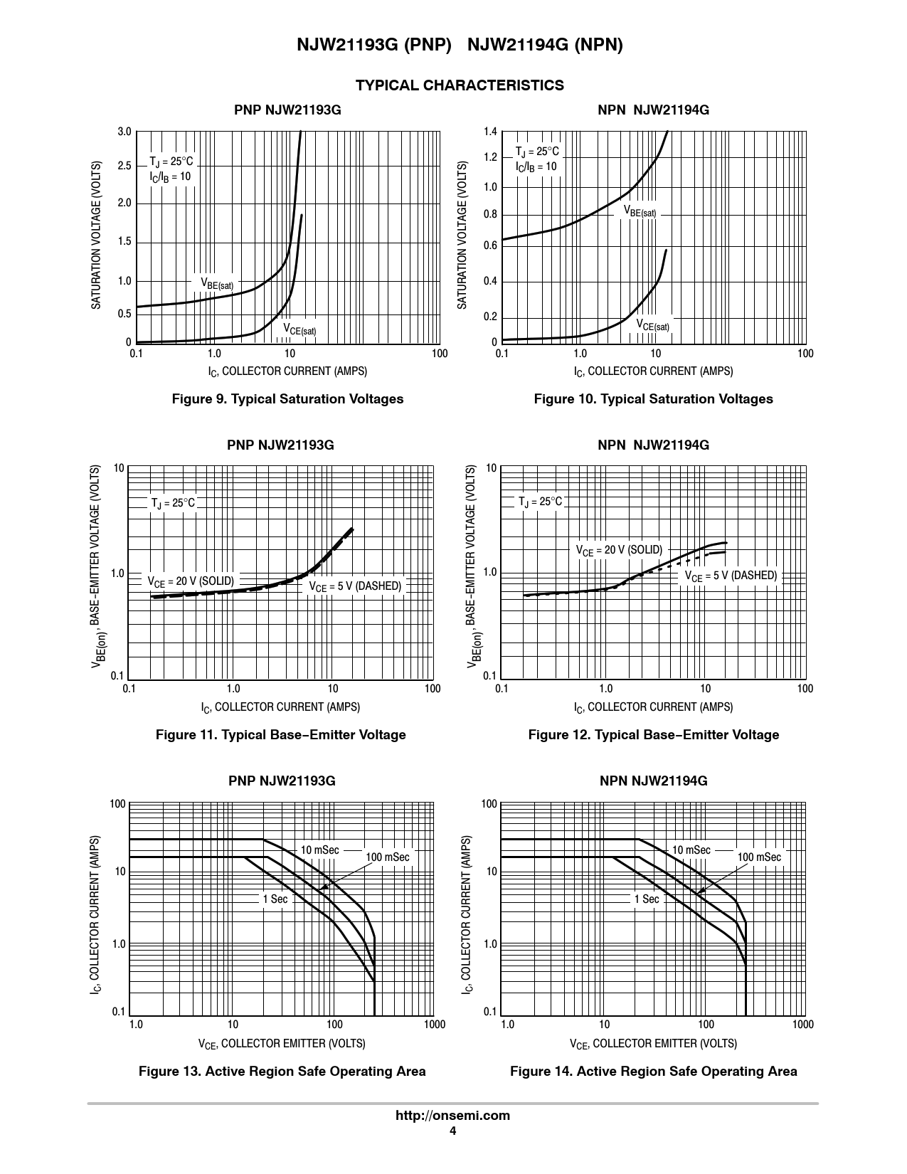

NJW21193G (PNP) NJW21194G (NPN). TYPICAL CHARACTERISTICS. PNP NJW21193G. NPN NJW21194G. Figure 9. Typical Saturation Voltages
NJW21193G (PNP) NJW21194G (NPN) TYPICAL CHARACTERISTICS PNP NJW21193G NPN NJW21194G Figure 9 Typical Saturation Voltages
3.0 1.4 T 1.2 J = 25°C 2.5 TJ = 25°C I TS) TS) C/IB = 10 IC/IB = 10 1.0 2.0 0.8 VBE(sat) TAGE (VOL TAGE (VOL 1.5 0.6 TION VOL TION VOL 1.0 V 0.4 BE(sat) TURA TURA SA SA 0.5 0.2 V V CE(sat) CE(sat) 0 0 0.1 1.0 10 100 0.1 1.0 10 100 IC, COLLECTOR CURRENT (AMPS) IC, COLLECTOR CURRENT (AMPS)
Figure 9. Typical Saturation Voltages Figure 10. Typical Saturation Voltages PNP NJW21193G NPN NJW21194G
10 10 TS) TS) T T J = 25°C J = 25°C TAGE (VOL TAGE (VOL VCE = 20 V (SOLID) 1.0 1.0 V V CE = 5 V (DASHED) CE = 20 V (SOLID) VCE = 5 V (DASHED) , BASE-EMITTER VOL , BASE-EMITTER VOL BE(on) BE(on) V V 0.1 0.1 0.1 1.0 10 100 0.1 1.0 10 100 IC, COLLECTOR CURRENT (AMPS) IC, COLLECTOR CURRENT (AMPS)
Figure 11. Typical Base−Emitter Voltage Figure 12. Typical Base−Emitter Voltage PNP NJW21193G NPN NJW21194G
100 100 10 mSec 10 mSec 100 mSec 100 mSec 10 10 1 Sec 1 Sec OR CURRENT (AMPS) OR CURRENT (AMPS) 1.0 1.0 , COLLECT , COLLECT I C I C 0.1 0.1 1.0 10 100 1000 1.0 10 100 1000 VCE, COLLECTOR EMITTER (VOLTS) VCE, COLLECTOR EMITTER (VOLTS)
Figure 13. Active Region Safe Operating Area Figure 14. Active Region Safe Operating Area http://onsemi.com 4
