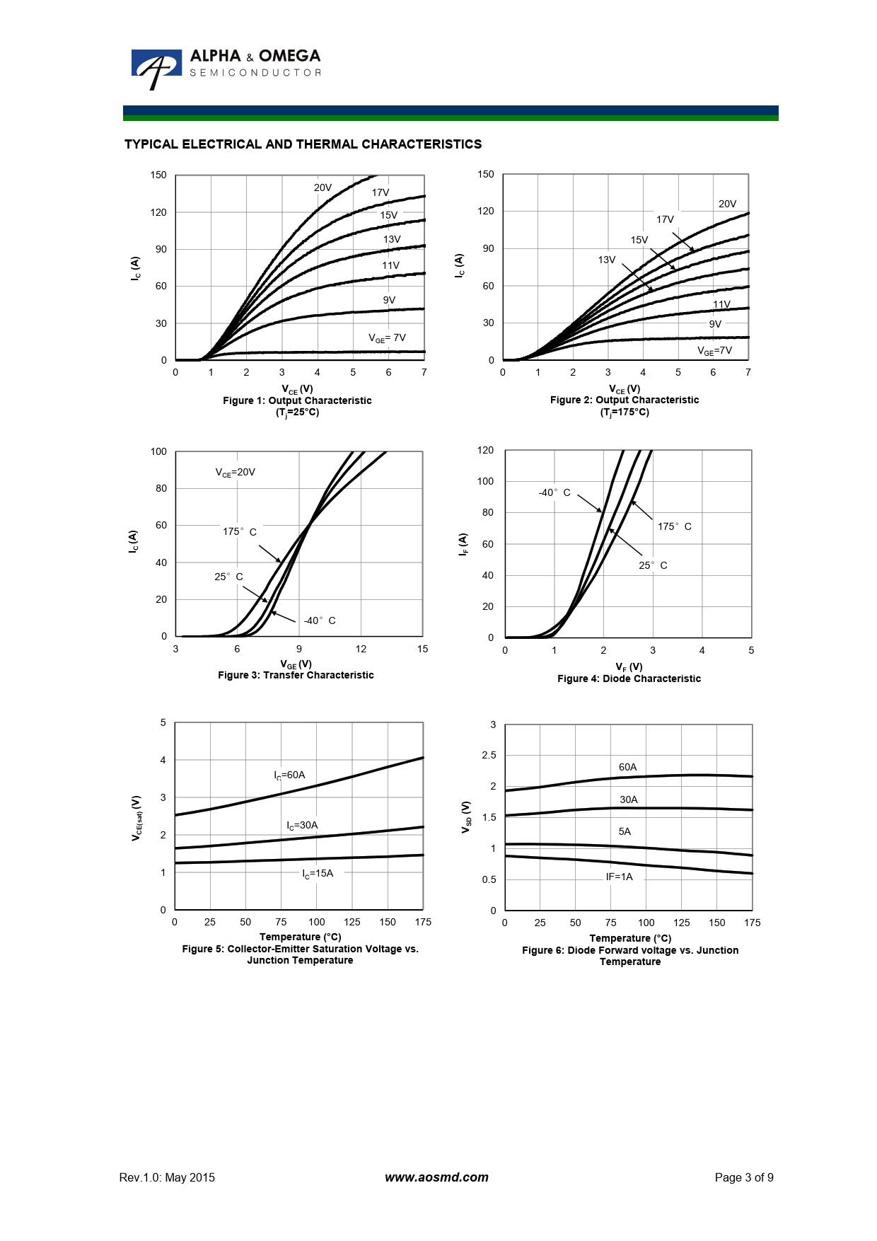

Pages / Page9 / 3 — TYPICAL ELECTRICAL AND THERMAL CHARACTERISTICS. I C. (V). Figure 1: …
TYPICAL ELECTRICAL AND THERMAL CHARACTERISTICS. I C. (V). Figure 1: Output Characteristic. Figure 2: Output Characteristic
TYPICAL ELECTRICAL AND THERMAL CHARACTERISTICS I C (V) Figure 1: Output Characteristic Figure 2: Output Characteristic
150 150 20V 17V 20V 120 15V 120 17V 13V 15V 90 90
13V
(A
11V
(A I C I C
60 60 9V 11V 30 30 9V V = 7V GE V =7V GE 0 0 0 1 2 3 4 5 6 7 0 1 2 3 4 5 6 7
V (V) V (V) CE CE Figure 1: Output Characteristic Figure 2: Output Characteristic (T =25°C) (T =175°C) j j
100 120 V =20V CE 100 80 -40 C ° 80 60 175 C °
175 C °
) (A (A
60
I C I F
40 25 C ° 25 C ° 40 20 20 -40 C ° 0 0 3 6 9 12 15 0 1 2 3 4 5
V (V) GE E V (V) F Figure 3: Transfer Characteristic Figure 4: Diode Characteristic
5 3 4 2.5 60A I =60A C 2 3 30A
(V) t) (V) a D
1.5
(s S E
I =30A C
C V
2 5A
V
1 1 I =15A C 0.5 IF=1A 0 0 0 25 50 75 100 125 150 175 0 25 50 75 100 125 150 175
Temperature (°C) Temperature (°C) Figure 5: Collector-Emitter Saturation Voltage vs. Figure 6: Diode Forward voltage vs. Junction Junction Temperature Temperature
