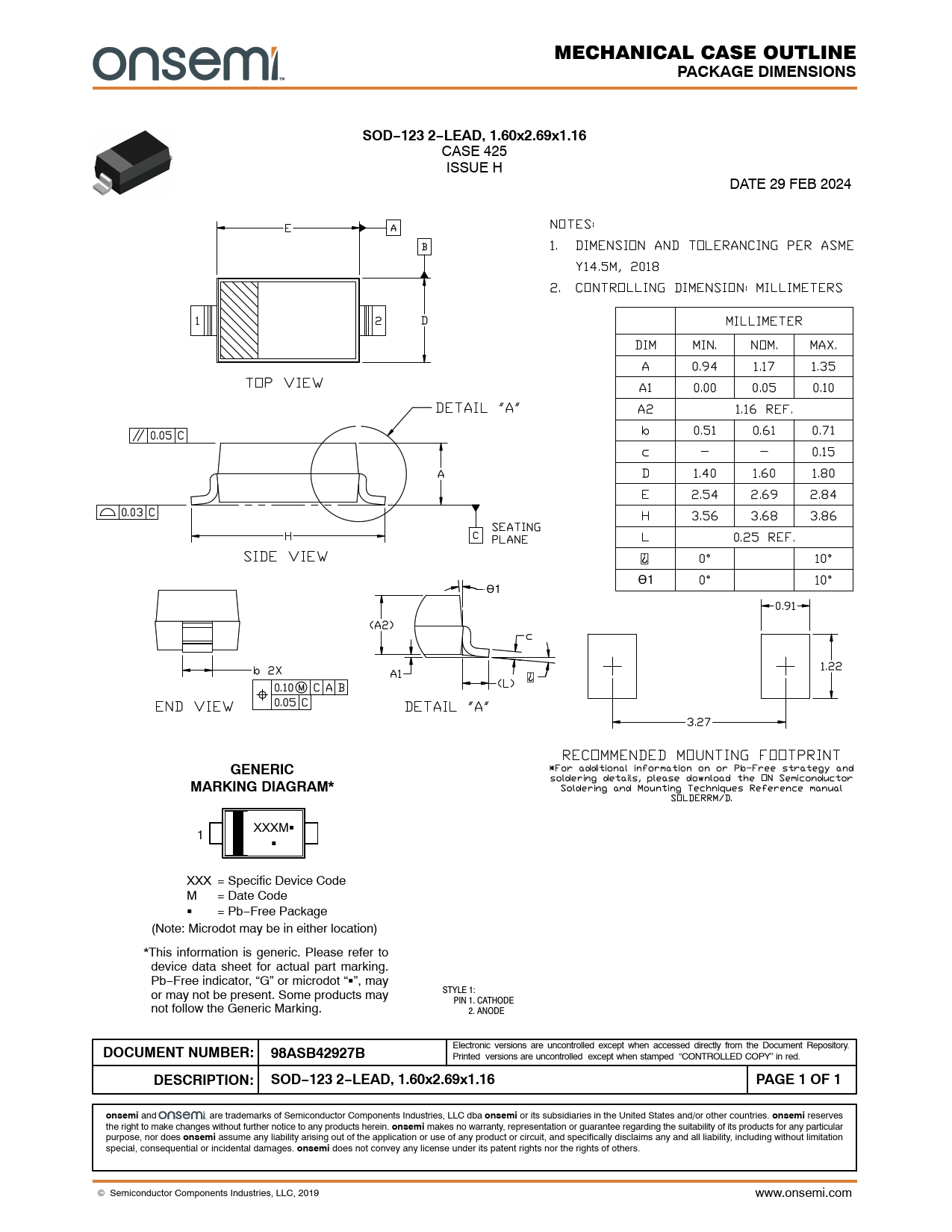

Pages / Page8 / 7 — PACKAGE DIMENSIONS. SOD−123 2−LEAD, 1.60x2.69x1.16. GENERIC. MARKING …
File Format / SizePDF / 221 Kb
PACKAGE DIMENSIONS. SOD−123 2−LEAD, 1.60x2.69x1.16. GENERIC. MARKING DIAGRAM*. DOCUMENT NUMBER: 98ASB42927B. DESCRIPTION:
PACKAGE DIMENSIONS SOD−123 2−LEAD, 1.60x2.69x1.16 GENERIC MARKING DIAGRAM* DOCUMENT NUMBER: 98ASB42927B DESCRIPTION:
MECHANICAL CASE OUTLINE
CASE 425 ISSUE H DATE 29 FEB 2024 Ө1 Ө1
XXXMG 1 G XXX = Specific Device Code M = Date Code G = Pb−Free Package (Note: Microdot may be in either location) *This information is generic. Please refer to device data sheet for actual part marking. Pb−Free indicator, “G” or microdot “G”, may STYLE 1: or may not be present. Some products may PIN 1. CATHODE not follow the Generic Marking. 2. ANODE
