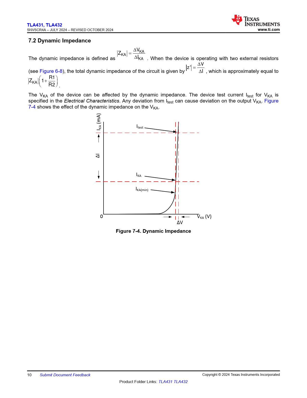

TLA431, TLA432. www.ti.com. 7.2 Dynamic Impedance. Figure 7-4. Dynamic Impedance
TLA431, TLA432 www.ti.com 7.2 Dynamic Impedance Figure 7-4 Dynamic Impedance
link to page 7 link to page 10 link to page 10
TLA431, TLA432
SNVSCR4A – JULY 2024 – REVISED OCTOBER 2024
' K V A K Z A The dynamic impedance is defined as ' K I A . When the device is operating with two external resistors 'V z' (see Figure 6-8), the total dynamic impedance of the circuit is given by 'I , which is approximately equal to § R1 · K Z A ¨1 ¸ © R2 ¹ . The VKA of the device can be affected by the dynamic impedance. The device test current Itest for VKA is specified in the Electrical Characteristics. Any deviation from Itest can cause deviation on the output VKA. Figure 7-4 shows the effect of the dynamic impedance on the VKA. ) A (m A I I K test / P IKA IKA(min) 0 VKA (V) Ps
