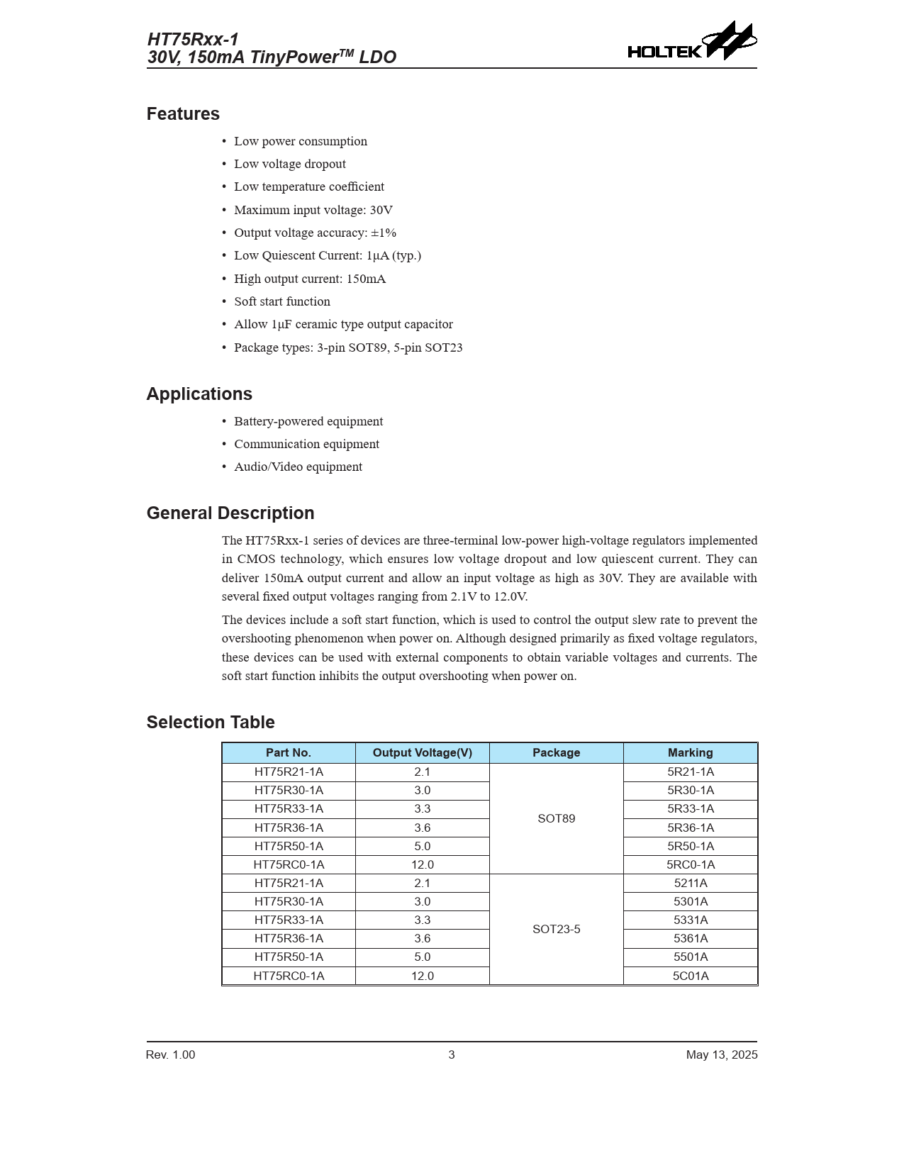

HT75Rxx-1 30V, 150mA TinyPowerTM LDO Features
• Low power consumption • Low voltage dropout • Low temperature coefficient • Maximum input voltage: 30V • Output voltage accuracy: ±1% • Low Quiescent Current: 1μA (typ.) • High output current: 150mA • Soft start function • Allow 1μF ceramic type output capacitor • Package types: 3-pin SOT89, 5-pin SOT23
Applications
• Battery-powered equipment • Communication equipment • Audio/Video equipment
General Description
The HT75Rxx-1 series of devices are three-terminal low-power high-voltage regulators implemented in CMOS technology, which ensures low voltage dropout and low quiescent current. They can deliver 150mA output current and allow an input voltage as high as 30V. They are available with several fixed output voltages ranging from 2.1V to 12.0V. The devices include a soft start function, which is used to control the output slew rate to prevent the overshooting phenomenon when power on. Although designed primarily as fixed voltage regulators, these devices can be used with external components to obtain variable voltages and currents. The soft start function inhibits the output overshooting when power on.
Selection Table Part No. Output Voltage(V) Package Marking
HT75R21-1A 2.1 5R21-1A HT75R30-1A 3.0 5R30-1A HT75R33-1A 3.3 5R33-1A SOT89 HT75R36-1A 3.6 5R36-1A HT75R50-1A 5.0 5R50-1A HT75RC0-1A 12.0 5RC0-1A HT75R21-1A 2.1 5211A HT75R30-1A 3.0 5301A HT75R33-1A 3.3 5331A SOT23-5 HT75R36-1A 3.6 5361A HT75R50-1A 5.0 5501A HT75RC0-1A 12.0 5C01A Rev. 1.00 3 May 13, 2025 Document Outline Features Applications General Description Selection Table Block Diagram Pin Assignment Pin Description Absolute Maximum Ratings Recommended Operating Range Electrical Characteristics Typical Performance Characteristic Application Circuits Basic Circuit High Output Current Positive Voltage Regulator Short-Circuit Protection by Tr1 Circuit for Increasing Output Voltage Constant Current Regulator Dual Supply Circuit Application Information External Circuit Input Capacitor CIN Considerations Output Capacitor COUT Considerations Thermal Considerations Power Dissipation Calculation Package Information 3-pin SOT89 Outline Dimensions 5-pin SOT23 Outline Dimensions
