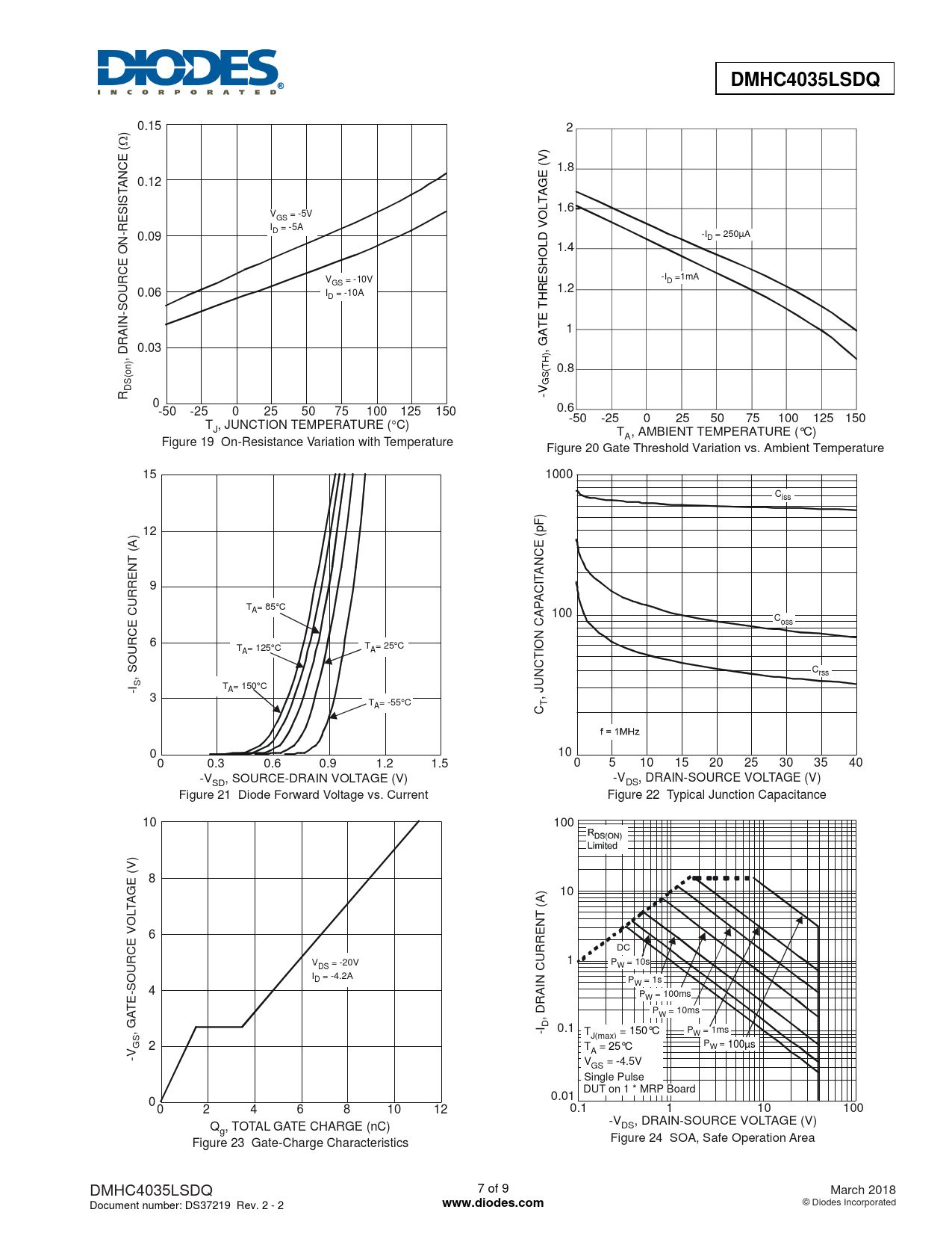

Description40V Complementary Enhancement Mode MOSFET H-Bridge

Figure 19 On-Resistance Variation with Temperature A Figure 20 Gate Threshold Variation vs. Ambient Temperature

F p ) 12 ( A( E C T N N E A T R 9 I R C U A P C T = 85 C A A 100 E C C oss C N R 6 O U T = 125 C T = 25 C A A I O T S C C , N rss I S U - T = 150 C A J 3 , T = -55 C A TC 0 10 0 0.3 0.6 0.9 1.2 1.5 0 5 10 15 20 25 30 35 40 -V , SOURCE-DRAIN VOLTAGE (V) -V , DRAIN-SOURCE VOLTAGE (V) SD DS Figure 21 Diode Forward Voltage vs. Current Figure 22 Typical Junction Capacitance 10 100 ) V( E 8 G ) 10 A A T ( L T O N V 6 E E R C R DC R U V = -20V 1 P = 10s U DS C W O I = -4.2A D N P = 1s S I W - 4 A E P = 100ms R W T A D P = 10ms , W G D , I- 0.1 T = 150癈 P = 1ms 150°C W S J(max) G 2 T = 2 25癈 P = 100祍 °C W 100µs V A - V = -4.5V GS Single Pulse DUT on 1 * MRP Board 0.01 0 0 2 4 6 8 10 12 0.1 1 10 100 Q , TOTAL GATE CHARGE (nC) -V , DRAIN-SOURCE VOLTAGE (V) DS g Figure 23 Gate-Charge Characteristics Figure 24 SOA, Safe Operation Area DMHC4035LSDQ 7 of 9 March 2018 Document number: DS37219 Rev. 2 - 2
