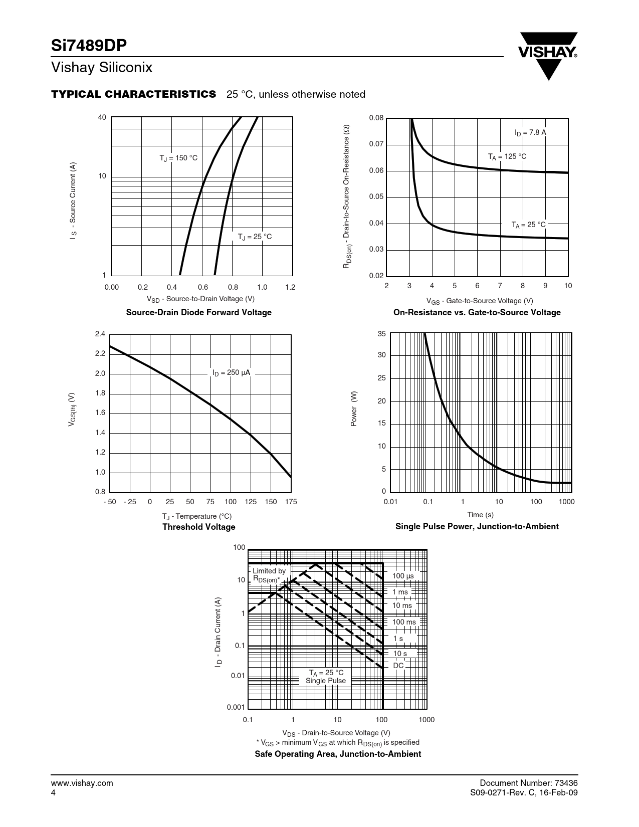

Si7489DP. TYPICAL CHARACTERISTICS. Source-Drain Diode Forward Voltage. On-Resistance vs. Gate-to-Source Voltage
Si7489DP TYPICAL CHARACTERISTICS Source-Drain Diode Forward Voltage On-Resistance vs Gate-to-Source Voltage
Si7489DP
Vishay Siliconix
25 °C, unless otherwise noted 40 0.08 ) Ω ID = 7.8 A 0.07 T T J = 150 °C A = 125 °C 0.06 10 0.05 - Source Current (A) 0.04 T ain-to-Source On-Resistance ( A = 25 °C SI TJ = 25 °C - Dr 0.03 DS(on)R 1 0.02 0.00 0.2 0.4 0.6 0.8 1.0 1.2 2 3 4 5 6 7 8 9 10 VSD - Source-to-Drain Voltage (V) VGS - Gate-to-Source Voltage (V)
Source-Drain Diode Forward Voltage On-Resistance vs. Gate-to-Source Voltage
2.4 35 2.2 30 2.0 ID = 250 µA 25 1.8 (V) 20 ) h (t 1.6 er (W) w GS o V P 15 1.4 10 1.2 1.0 5 0.8 0 - 50 - 25 0 25 50 75 100 125 150 175 0.01 0.1 1 10 100 1000 T Time (s) J - Temperature (°C)
Threshold Voltage Single Pulse Power, Junction-to-Ambient
100 Limited by 100 µs 10 RDS(on)* 1 ms 10 ms 1 100 ms 1 s ain Current (A) 0.1 - Dr 10 s I D DC 0.01 TA = 25 °C Single Pulse 0.001 0.1 1 10 100 1000 VDS - Drain-to-Source Voltage (V) * VGS > minimum VGS at which RDS(on) is specified
Safe Operating Area, Junction-to-Ambient
