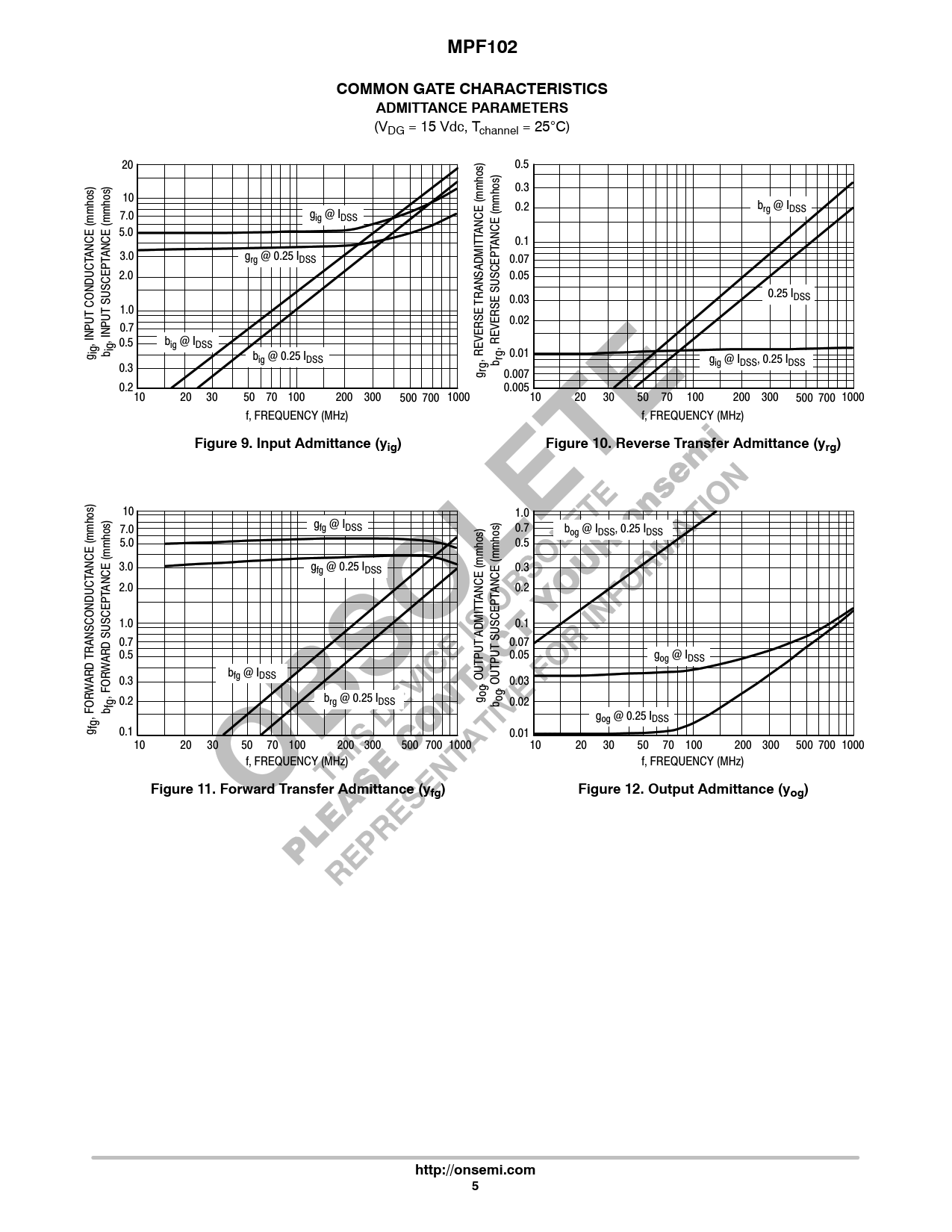

Pages / Page7 / 5 — MPF102. COMMON GATE CHARACTERISTICS. ADMITTANCE PARAMETERS. Figure 9. …
File Format / SizePDF / 363 Kb
MPF102. COMMON GATE CHARACTERISTICS. ADMITTANCE PARAMETERS. Figure 9. Input Admittance (yig)
MPF102 COMMON GATE CHARACTERISTICS ADMITTANCE PARAMETERS Figure 9 Input Admittance (yig)
(VDG = 15 Vdc, Tchannel = 25C) 20 0.5 0.3 10 0.2 brg @ IDSS 7.0 gig @ IDSS 5.0 ANCE (mmhos) ANCE (mmhos) 0.1 ANCE (mmhos) ANCE (mmhos) 3.0 grg @ 0.25 IDSS 0.07 2.0 0.05 0.25 I 0.03 DSS CONDUCT SUSCEPT TRANSADMITT 1.0 0.02 0.7 , INPUT , INPUT 0.5 b ig ig ig @ IDSS , REVERSE SUSCEPT g b big @ 0.25 IDSS , REVERSE rg 0.01 b g 0.3 rg ig @ IDSS, 0.25 IDSS g 0.007 0.2 0.005 10 20 30 50 70 100 200 300 500 700 1000 10 20 30 50 70 100 200 300 500 700 1000 f, FREQUENCY (MHz) f, FREQUENCY (MHz)
Figure 9. Input Admittance (yig) Figure 10. Reverse Transfer Admittance (yrg)
10 1.0 7.0 gfg @ IDSS 0.7 bog @ IDSS, 0.25 IDSS 5.0 0.5 ANCE (mmhos) 3.0 g 0.3 fg @ 0.25 IDSS ANCE (mmhos) 2.0 ANCE (mmhos) 0.2 ANCE (mmhos) 1.0 0.1 ADMITT 0.7 SUSCEPT 0.07 TRANSCONDUCT ARD SUSCEPT 0.5 0.05 gog @ IDSS W b ARD 0.3 fg @ IDSS , OUTPUT 0.03 W , OUTPUT , FOR og b og fg 0.2 rg @ 0.25 IDSS g b 0.02 b , FOR gog @ 0.25 IDSS fgg 0.1 0.01 10 20 30 50 70 100 200 300 500 700 1000 10 20 30 50 70 100 200 300 500 700 1000 f, FREQUENCY (MHz) f, FREQUENCY (MHz)
Figure 11. Forward Transfer Admittance (yfg) Figure 12. Output Admittance (yog) http://onsemi.com 5
