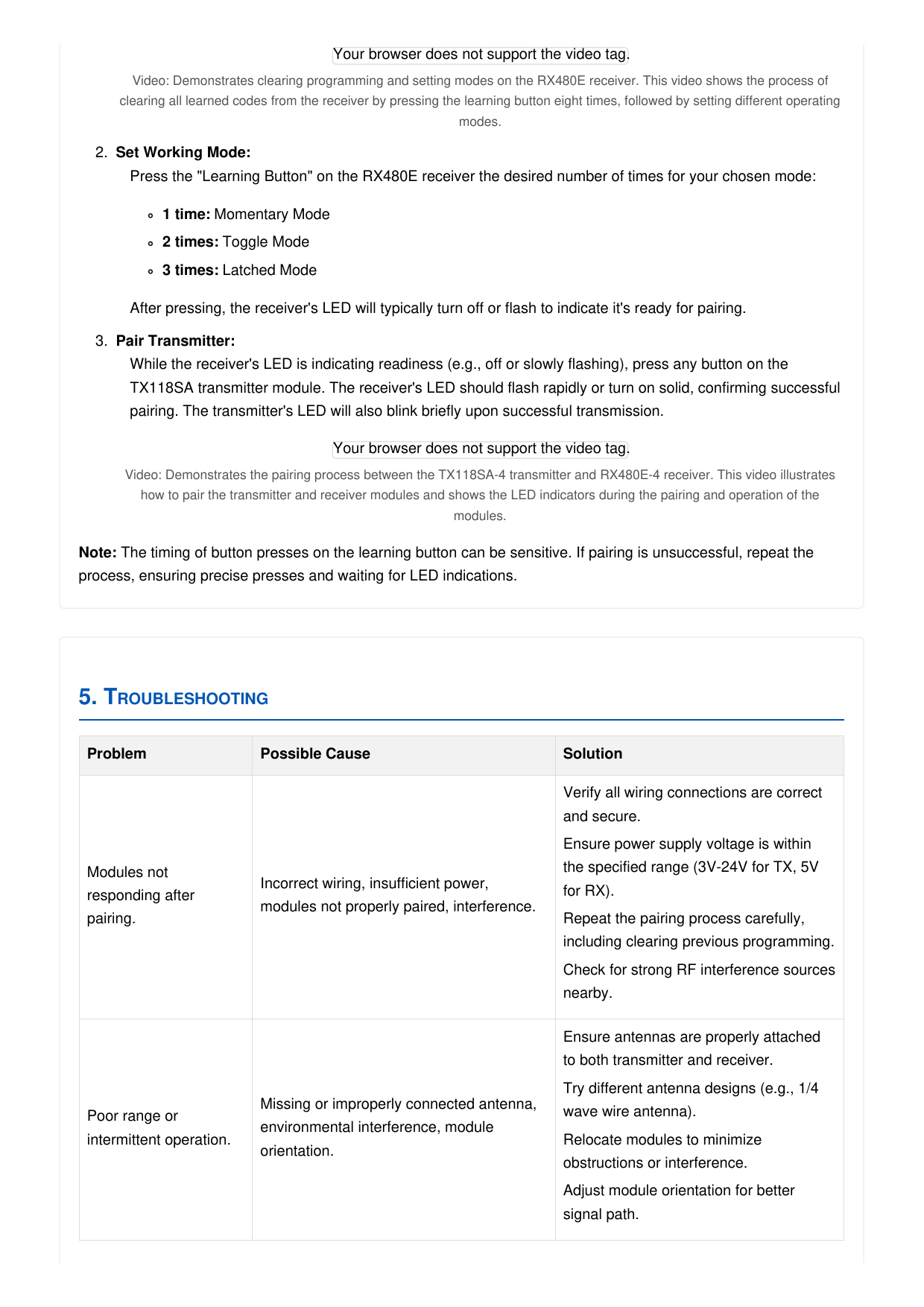

Your browser does not support the video tag. Video: Demonstrates clearing programming and setting modes on the RX480E receiver. This video shows the process of clearing all learned codes from the receiver by pressing the learning button eight times, followed by setting different operating modes. 2.
Set Working Mode:
Press the "Learning Button" on the RX480E receiver the desired number of times for your chosen mode:
1 time:
Momentary Mode
2 times:
Toggle Mode
3 times:
Latched Mode After pressing, the receiver's LED will typically turn off or flash to indicate it's ready for pairing. 3.
Pair Transmitter:
While the receiver's LED is indicating readiness (e.g., off or slowly flashing), press any button on the TX118SA transmitter module. The receiver's LED should flash rapidly or turn on solid, confirming successful pairing. The transmitter's LED will also blink briefly upon successful transmission. Your browser does not support the video tag. Video: Demonstrates the pairing process between the TX118SA-4 transmitter and RX480E-4 receiver. This video illustrates how to pair the transmitter and receiver modules and shows the LED indicators during the pairing and operation of the modules.
Note:
The timing of button presses on the learning button can be sensitive. If pairing is unsuccessful, repeat the process, ensuring precise presses and waiting for LED indications.
5. TROUBLESHOOTING Problem Possible Cause Solution
