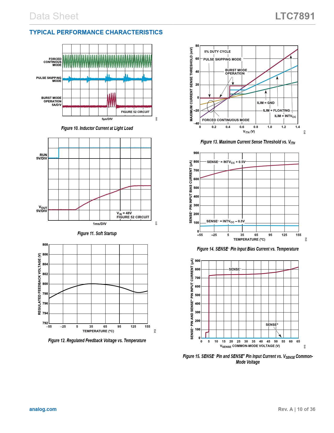

Pages / Page36 / 10 — LTC7891. TYPICAL PERFORMANCE CHARACTERISTICS. Figure 10. Inductor Current …
LTC7891. TYPICAL PERFORMANCE CHARACTERISTICS. Figure 10. Inductor Current at Light Load
LTC7891 TYPICAL PERFORMANCE CHARACTERISTICS Figure 10 Inductor Current at Light Load
Data Sheet
LTC7891 TYPICAL PERFORMANCE CHARACTERISTICS Figure 10. Inductor Current at Light Load Figure 13. Maximum Current Sense Threshold vs. VITH Figure 11. Soft Startup Figure 14. SENSE– Pin Input Bias Current vs. Temperature Figure 12. Regulated Feedback Voltage vs. Temperature Figure 15. SENSE– Pin and SENSE+ Pin Input Current vs. VSENSE Common- Mode Voltage analog.com Rev. A | 10 of 36
