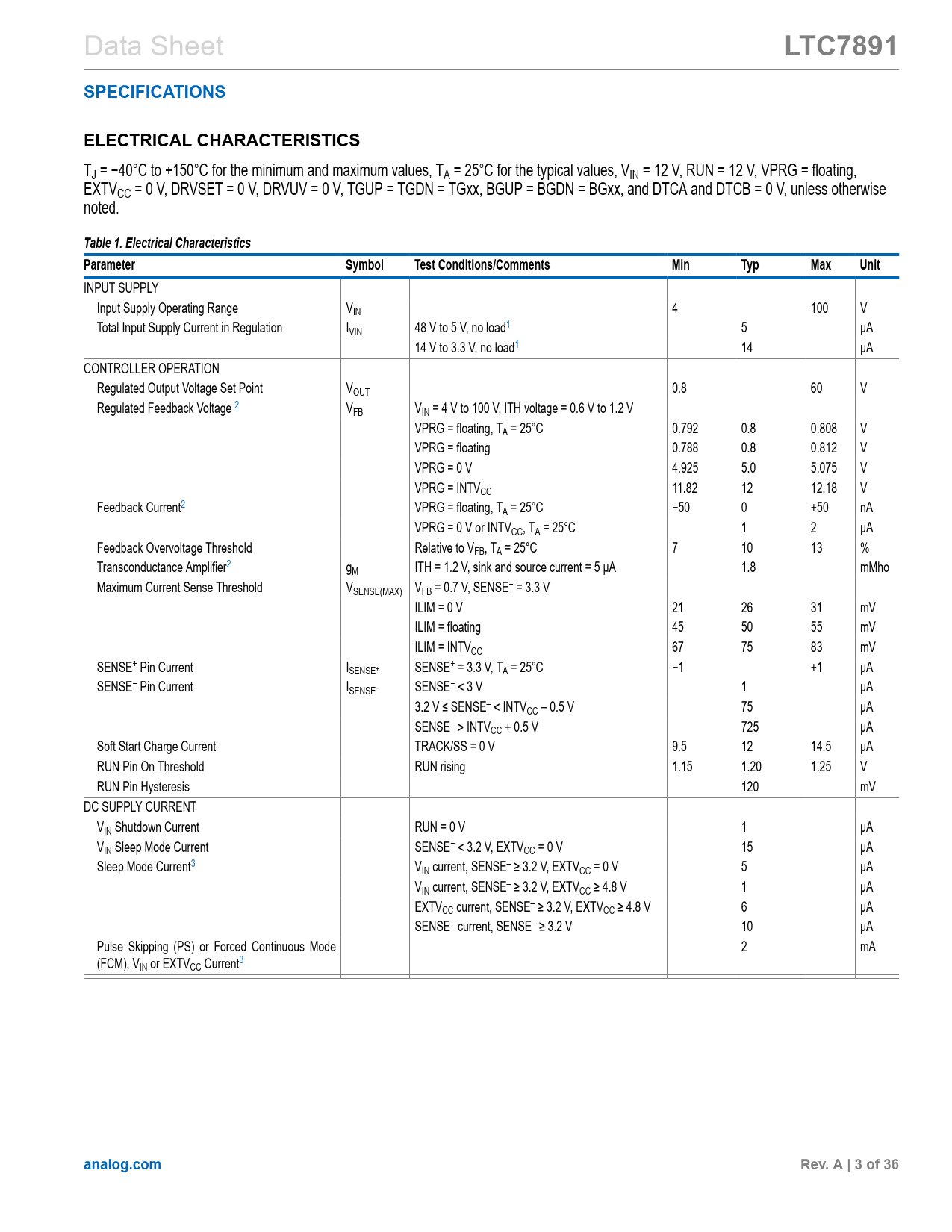

LTC7891 SPECIFICATIONS ELECTRICAL CHARACTERISTICS
TJ = −40°C to +150°C for the minimum and maximum values, TA = 25°C for the typical values, VIN = 12 V, RUN = 12 V, VPRG = floating, EXTVCC = 0 V, DRVSET = 0 V, DRVUV = 0 V, TGUP = TGDN = TGxx, BGUP = BGDN = BGxx, and DTCA and DTCB = 0 V, unless otherwise noted.
Table 1. Electrical Characteristics Parameter Symbol Test Conditions/Comments Min Typ Max Unit
INPUT SUPPLY Input Supply Operating Range VIN 4 100 V Total Input Supply Current in Regulation IVIN 48 V to 5 V, no load1 5 μA 14 V to 3.3 V, no load1 14 μA CONTROLLER OPERATION Regulated Output Voltage Set Point VOUT 0.8 60 V Regulated Feedback Voltage 2 VFB VIN = 4 V to 100 V, ITH voltage = 0.6 V to 1.2 V VPRG = floating, TA = 25°C 0.792 0.8 0.808 V VPRG = floating 0.788 0.8 0.812 V VPRG = 0 V 4.925 5.0 5.075 V VPRG = INTVCC 11.82 12 12.18 V Feedback Current2 VPRG = floating, TA = 25°C −50 0 +50 nA VPRG = 0 V or INTVCC, TA = 25°C 1 2 µA Feedback Overvoltage Threshold Relative to VFB, TA = 25°C 7 10 13 % Transconductance Amplifier2 gM ITH = 1.2 V, sink and source current = 5 μA 1.8 mMho Maximum Current Sense Threshold VSENSE(MAX) VFB = 0.7 V, SENSE− = 3.3 V ILIM = 0 V 21 26 31 mV ILIM = floating 45 50 55 mV ILIM = INTVCC 67 75 83 mV SENSE+ Pin Current ISENSE+ SENSE+ = 3.3 V, TA = 25°C −1 +1 μA SENSE− Pin Current ISENSE− SENSE− < 3 V 1 μA 3.2 V ≤ SENSE– < INTVCC – 0.5 V 75 μA SENSE– > INTVCC + 0.5 V 725 μA Soft Start Charge Current TRACK/SS = 0 V 9.5 12 14.5 μA RUN Pin On Threshold RUN rising 1.15 1.20 1.25 V RUN Pin Hysteresis 120 mV DC SUPPLY CURRENT VIN Shutdown Current RUN = 0 V 1 μA VIN Sleep Mode Current SENSE− < 3.2 V, EXTVCC = 0 V 15 µA Sleep Mode Current3 VIN current, SENSE– ≥ 3.2 V, EXTVCC = 0 V 5 µA VIN current, SENSE– ≥ 3.2 V, EXTVCC ≥ 4.8 V 1 µA EXTVCC current, SENSE– ≥ 3.2 V, EXTVCC ≥ 4.8 V 6 µA SENSE– current, SENSE– ≥ 3.2 V 10 µA Pulse Skipping (PS) or Forced Continuous Mode 2 mA (FCM), VIN or EXTVCC Current3
