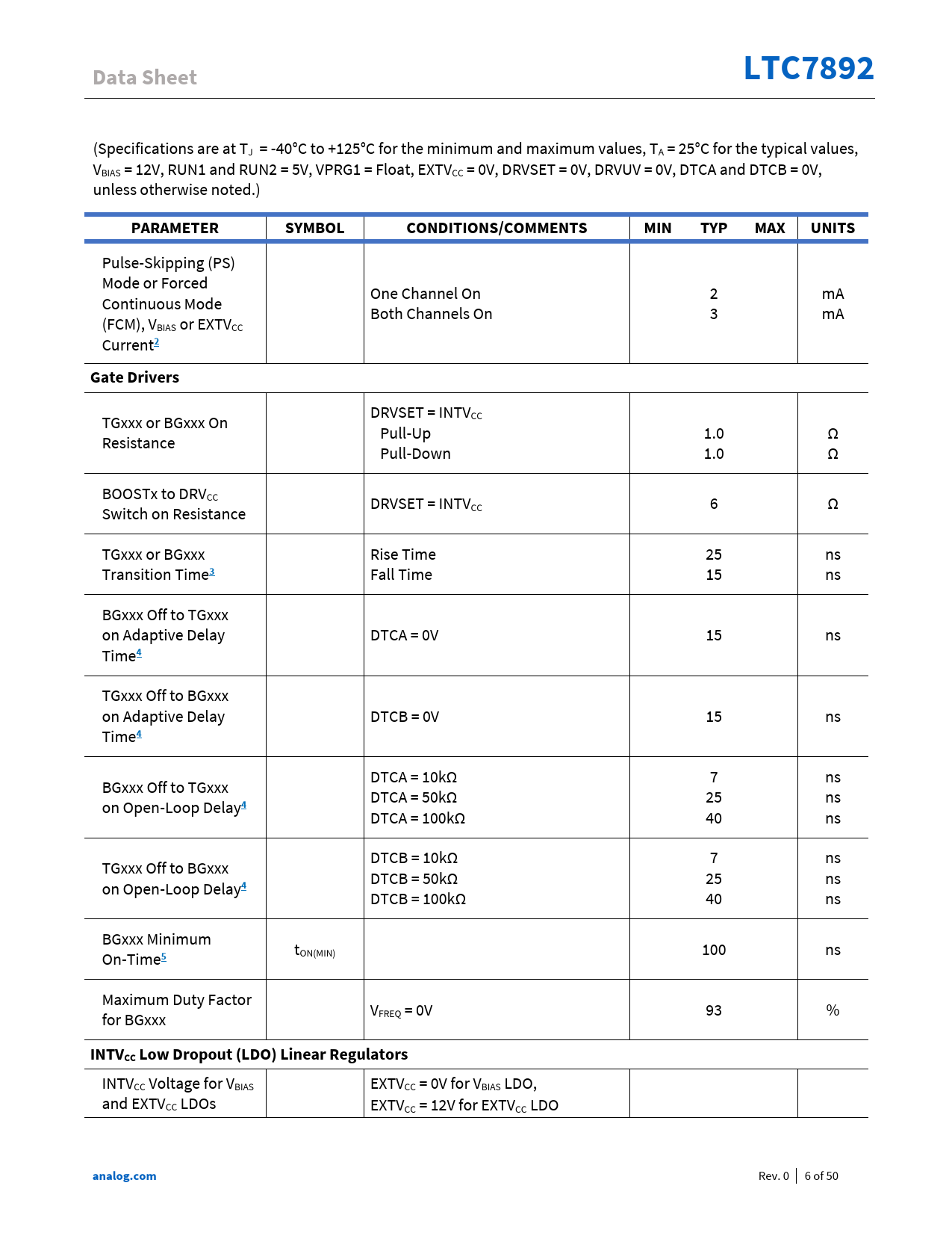

Data Sheet. LTC7892. PARAMETER. SYMBOL. CONDITIONS/COMMENTS. MIN. TYP. MAX. UNITS. Gate Drivers. INTVCC Low Dropout (LDO) Linear Regulators
Data Sheet LTC7892 PARAMETER SYMBOL CONDITIONS/COMMENTS MIN TYP MAX UNITS Gate Drivers INTVCC Low Dropout (LDO) Linear Regulators
link to page 8 link to page 8 link to page 8 link to page 8 link to page 8 link to page 8 link to page 8
Data Sheet LTC7892
(Specifications are at TJ = -40°C to +125°C for the minimum and maximum values, TA = 25°C for the typical values, VBIAS = 12V, RUN1 and RUN2 = 5V, VPRG1 = Float, EXTVCC = 0V, DRVSET = 0V, DRVUV = 0V, DTCA and DTCB = 0V, unless otherwise noted.)
Pulse-Skipping (PS) Mode or Forced One Channel On 2 mA Continuous Mode Both Channels On 3 mA (FCM), VBIAS or EXTVCC Current
2 Gate Drivers
DRVSET = INTV TGxxx or BGxxx On CC Pull-Up 1.0 Ω Resistance Pull-Down 1.0 Ω BOOSTx to DRVCC DRVSET = INTV Switch on Resistance CC 6 Ω TGxxx or BGxxx Rise Time 25 ns Transition Time
3
Fall Time 15 ns BGxxx Off to TGxxx on Adaptive Delay DTCA = 0V 15 ns Time
4
TGxxx Off to BGxxx on Adaptive Delay DTCB = 0V 15 ns Time
4
DTCA = 10kΩ 7 ns BGxxx Off to TGxxx DTCA = 50kΩ 25 ns on Open-Loop Delay
4
DTCA = 100kΩ 40 ns DTCB = 10kΩ 7 ns TGxxx Off to BGxxx DTCB = 50kΩ 25 ns on Open-Loop Delay
4
DTCB = 100kΩ 40 ns BGxxx Minimum t On-Time
5
ON(MIN) 100 ns Maximum Duty Factor V for BGxxx FREQ = 0V 93 %
INTVCC Voltage for VBIAS EXTV CC = 0V for VBIAS LDO, and EXTVCC LDOs EXTVCC = 12V for EXTVCC LDO
