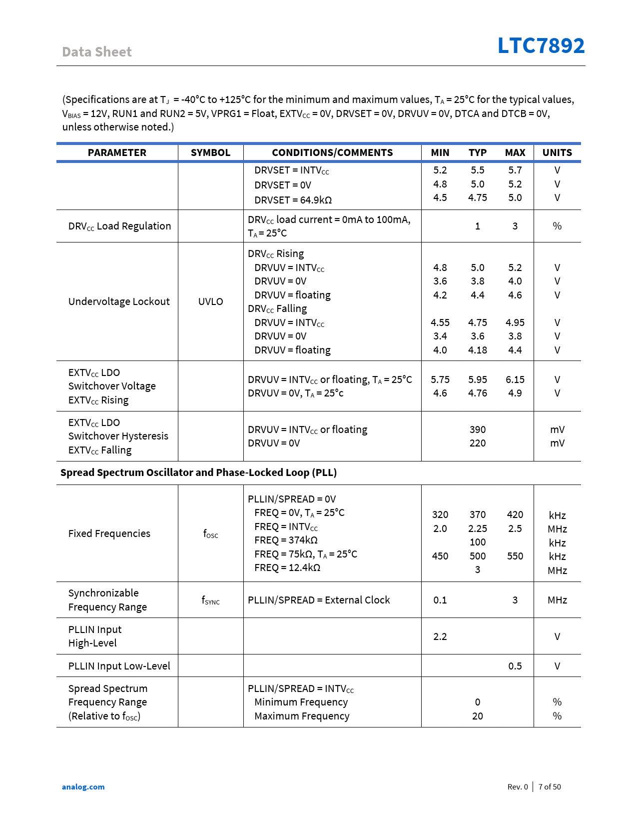

Data Sheet. LTC7892. PARAMETER. SYMBOL. CONDITIONS/COMMENTS. MIN. TYP. MAX. UNITS. Spread Spectrum Oscillator and Phase-Locked Loop (PLL)
Data Sheet LTC7892 PARAMETER SYMBOL CONDITIONS/COMMENTS MIN TYP MAX UNITS Spread Spectrum Oscillator and Phase-Locked Loop (PLL)
Data Sheet LTC7892
(Specifications are at TJ = -40°C to +125°C for the minimum and maximum values, TA = 25°C for the typical values, VBIAS = 12V, RUN1 and RUN2 = 5V, VPRG1 = Float, EXTVCC = 0V, DRVSET = 0V, DRVUV = 0V, DTCA and DTCB = 0V, unless otherwise noted.)
DRVSET = INTVCC 5.2 5.5 5.7 V DRVSET = 0V 4.8 5.0 5.2 V DRVSET = 64.9kΩ 4.5 4.75 5.0 V DRV DRV CC load current = 0mA to 100mA, CC Load Regulation 1 3 % TA = 25°C DRVCC Rising DRVUV = INTVCC 4.8 5.0 5.2 V DRVUV = 0V 3.6 3.8 4.0 V DRVUV = floating 4.2 4.4 4.6 V Undervoltage Lockout UVLO DRVCC Falling DRVUV = INTVCC 4.55 4.75 4.95 V DRVUV = 0V 3.4 3.6 3.8 V DRVUV = floating 4.0 4.18 4.4 V EXTVCC LDO DRVUV = INTV 5.75 5.95 6.15 V Switchover Voltage CC or floating, TA = 25°C DRVUV = 0V, T 4.6 4.76 4.9 V EXTV A = 25°c CC Rising EXTVCC LDO DRVUV = INTV 390 mV Switchover Hysteresis CC or floating DRVUV = 0V 220 mV EXTVCC Falling
PLLIN/SPREAD = 0V FREQ = 0V, TA = 25°C 320 370 420 kHz FREQ = INTV Fixed Frequencies f CC 2.0 2.25 2.5 MHz OSC FREQ = 374kΩ 100 kHz FREQ = 75kΩ, TA = 25°C 450 500 550 kHz FREQ = 12.4kΩ 3 MHz Synchronizable f Frequency Range SYNC PLLIN/SPREAD = External Clock 0.1 3 MHz PLLIN Input 2.2 V High-Level PLLIN Input Low-Level 0.5 V Spread Spectrum PLLIN/SPREAD = INTVCC Frequency Range Minimum Frequency 0 % (Relative to fOSC) Maximum Frequency 20 %
