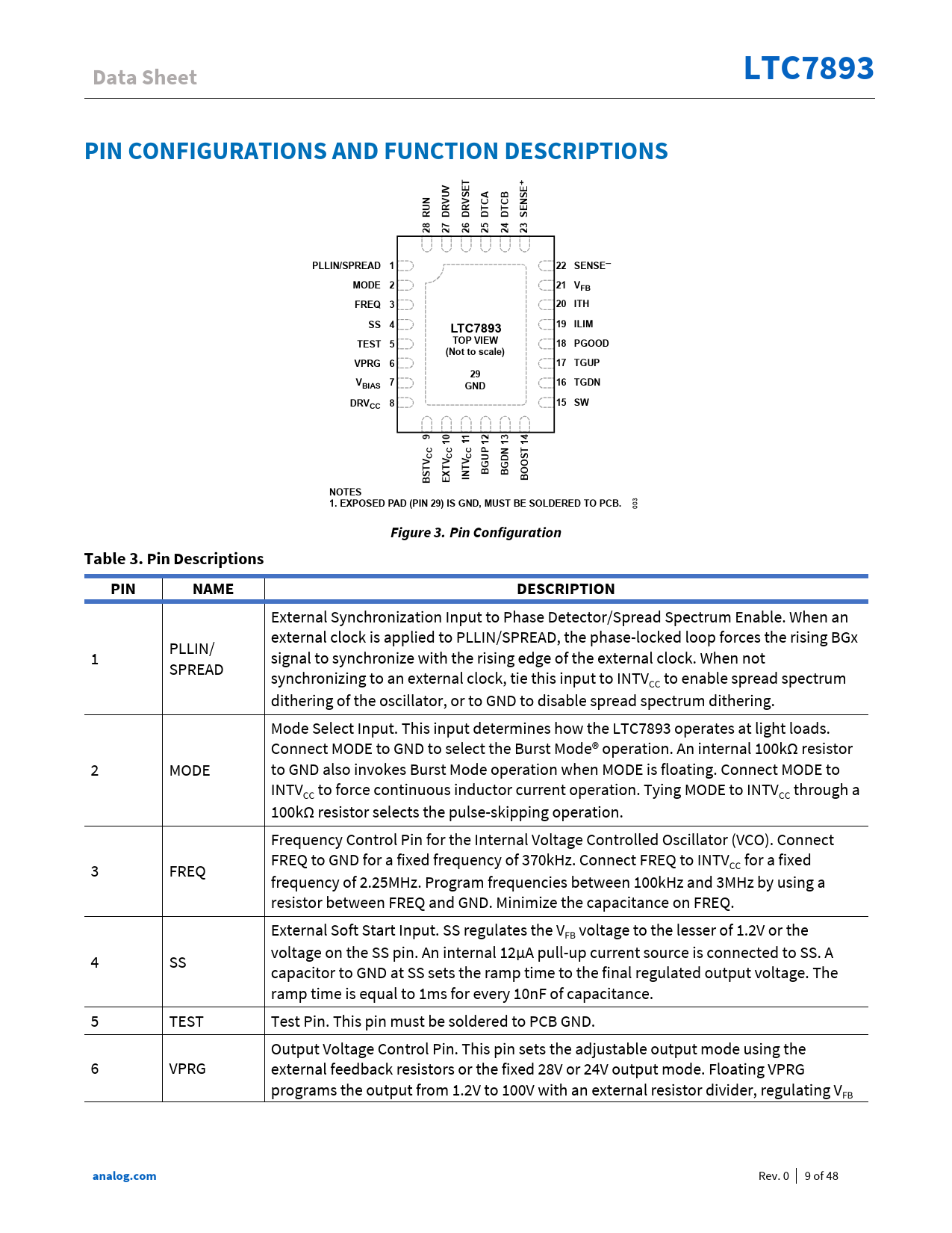

Data Sheet. LTC7893. PIN CONFIGURATIONS AND FUNCTION DESCRIPTIONS. VSET. RUN. SEN. PLLIN/SPREAD 1. 22 SENSE–. MODE 2. 21 VFB. FREQ 3. 20 ITH
Data Sheet LTC7893 PIN CONFIGURATIONS AND FUNCTION DESCRIPTIONS VSET RUN SEN PLLIN/SPREAD 1 22 SENSE– MODE 2 21 VFB FREQ 3 20 ITH
Data Sheet LTC7893 PIN CONFIGURATIONS AND FUNCTION DESCRIPTIONS + V A B SE VU VSET C C R R T T RUN D D D D SEN 28 27 26 25 24 23 PLLIN/SPREAD 1 22 SENSE– MODE 2 21 VFB FREQ 3 20 ITH SS 4 19 ILIM LTC7893 TEST 5 TOP VIEW 18 PGOOD (Not to scale) VPRG 6 17 TGUP 29 V 7 BIAS 16 TGDN GND DRV 8 CC 15 SW 9 10 11 12 13 14 P N CC CC CC ST V V V U D T G G O ST N B B O B EXT I B NOTES 1. EXPOSED PAD (PIN 29) IS GND, MUST BE SOLDERED TO PCB.
003
Figure 3. Pin Configuration Table 3. Pin Descriptions PIN NAME DESCRIPTION
External Synchronization Input to Phase Detector/Spread Spectrum Enable. When an external clock is applied to PLLIN/SPREAD, the phase-locked loop forces the rising BGx PLLIN/ 1 signal to synchronize with the rising edge of the external clock. When not SPREAD synchronizing to an external clock, tie this input to INTVCC to enable spread spectrum dithering of the oscillator, or to GND to disable spread spectrum dithering. Mode Select Input. This input determines how the LTC7893 operates at light loads. Connect MODE to GND to select the Burst Mode® operation. An internal 100kΩ resistor 2 MODE to GND also invokes Burst Mode operation when MODE is floating. Connect MODE to INTVCC to force continuous inductor current operation. Tying MODE to INTVCC through a 100kΩ resistor selects the pulse-skipping operation. Frequency Control Pin for the Internal Voltage Controlled Oscillator (VCO). Connect FREQ to GND for a fixed frequency of 370kHz. Connect FREQ to INTV 3 FREQ CC for a fixed frequency of 2.25MHz. Program frequencies between 100kHz and 3MHz by using a resistor between FREQ and GND. Minimize the capacitance on FREQ. External Soft Start Input. SS regulates the VFB voltage to the lesser of 1.2V or the 4 SS voltage on the SS pin. An internal 12μA pull-up current source is connected to SS. A capacitor to GND at SS sets the ramp time to the final regulated output voltage. The ramp time is equal to 1ms for every 10nF of capacitance. 5 TEST Test Pin. This pin must be soldered to PCB GND. Output Voltage Control Pin. This pin sets the adjustable output mode using the 6 VPRG external feedback resistors or the fixed 28V or 24V output mode. Floating VPRG programs the output from 1.2V to 100V with an external resistor divider, regulating VFB
