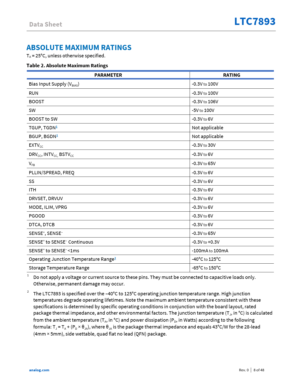

Data Sheet LTC7893 ABSOLUTE MAXIMUM RATINGS
TA = 25°C, unless otherwise specified.
Table 2. Absolute Maximum Ratings PARAMETER RATING
Bias Input Supply (VBIAS) -0.3V to 100V RUN -0.3V to 100V BOOST -0.3V to 106V SW -5V to 100V BOOST to SW -0.3V to 6V TGUP, TGDN
1
Not applicable BGUP, BGDN
1
Not applicable EXTVCC -0.3V to 30V DRVCC, INTVCC, BSTVCC -0.3V to 6V VFB -0.3V to 65V PLLIN/SPREAD, FREQ -0.3V to 6V SS -0.3V to 6V ITH -0.3V to 6V DRVSET, DRVUV -0.3V to 6V MODE, ILIM, VPRG -0.3V to 6V PGOOD -0.3V to 6V DTCA, DTCB -0.3V to 6V SENSE+, SENSE– -0.3V to 65V SENSE+ to SENSE– Continuous -0.3V to +0.3V SENSE+ to SENSE– <1ms -100mA to 100mA Operating Junction Temperature Range
2
-40°C to 125°C Storage Temperature Range -65°C to 150°C .1 Do not apply a voltage or current source to these pins. They must be connected to capacitive loads only. Otherwise, permanent damage may occur. 2 The LTC7893 is specified over the –40°C to 125°C operating junction temperature range. High junction temperatures degrade operating lifetimes. Note the maximum ambient temperature consistent with these specifications is determined by specific operating conditions in conjunction with the board layout, rated package thermal impedance, and other environmental factors. The junction temperature (TJ, in °C) is calculated from the ambient temperature (TA, in °C) and power dissipation (PD, in Watts) according to the following formula: TJ = TA + (PD × θJA), where θJA is the package thermal impedance and equals 43°C/W for the 28-lead (4mm × 5mm), side wettable, quad flat no lead (QFN) package.
