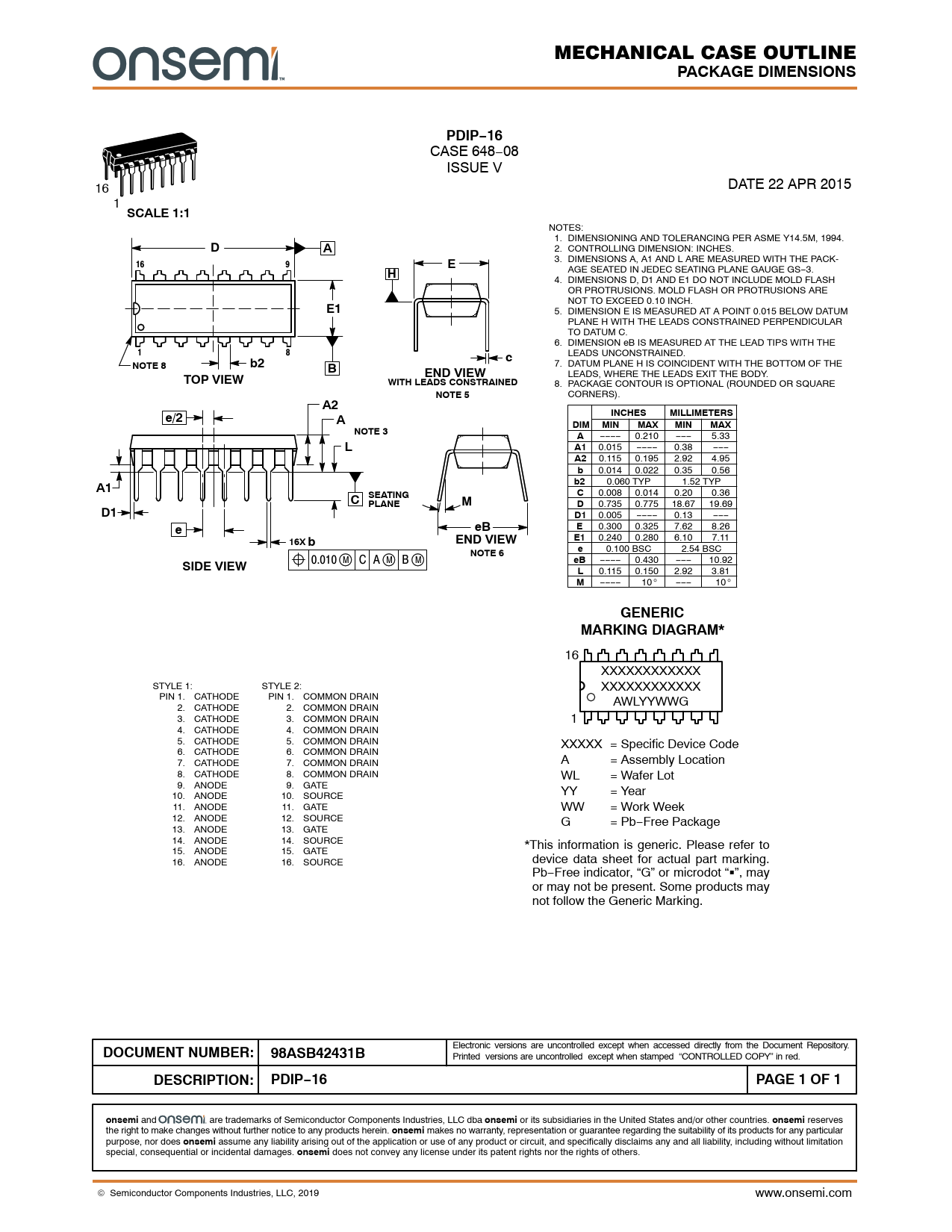

PACKAGE DIMENSIONS. PDIP−16. SCALE 1:1. NOTE 8. TOP VIEW. END VIEW. WITH LEADS CONSTRAINED. NOTE 5. e/2. INCHES. MILLIMETERS. DIM. MIN. MAX. NOTE 3
PACKAGE DIMENSIONS PDIP−16 SCALE 1:1 NOTE 8 TOP VIEW END VIEW WITH LEADS CONSTRAINED NOTE 5 e/2 INCHES MILLIMETERS DIM MIN MAX NOTE 3
MECHANICAL CASE OUTLINE
CASE 648−08 ISSUE V DATE 22 APR 2015 16 1
SCALE 1:1
NOTES: 1. DIMENSIONING AND TOLERANCING PER ASME Y14.5M, 1994.
D A
2. CONTROLLING DIMENSION: INCHES. 3. DIMENSIONS A, A1 AND L ARE MEASURED WITH THE PACK-
16 9 E
AGE SEATED IN JEDEC SEATING PLANE GAUGE GS−3.
H
4. DIMENSIONS D, D1 AND E1 DO NOT INCLUDE MOLD FLASH OR PROTRUSIONS. MOLD FLASH OR PROTRUSIONS ARE NOT TO EXCEED 0.10 INCH.
E1
5. DIMENSION E IS MEASURED AT A POINT 0.015 BELOW DATUM PLANE H WITH THE LEADS CONSTRAINED PERPENDICULAR TO DATUM C. 6. DIMENSION eB IS MEASURED AT THE LEAD TIPS WITH THE
1 8
LEADS UNCONSTRAINED.
c NOTE 8 b2 B
7. DATUM PLANE H IS COINCIDENT WITH THE BOTTOM OF THE
TOP VIEW END VIEW
LEADS, WHERE THE LEADS EXIT THE BODY.
8. PACKAGE CONTOUR IS OPTIONAL (ROUNDED OR SQUARE
NOTE 5
CORNERS).
A2 e/2 A INCHES MILLIMETERS DIM MIN MAX MIN MAX NOTE 3 A
−−−− 0.210 −−− 5.33
L A1
0.015 −−−− 0.38 −−−
A2
0.115 0.195 2.92 4.95
b
0.014 0.022 0.35 0.56
A1 b2
0.060 TYP 1.52 TYP
C SEATING C
0.008 0.014 0.20 0.36
PLANE M D
0.735 0.775 18.67 19.69
D1 D1
0.005 −−−− 0.13 −−−
e eB E
0.300 0.325 7.62 8.26
16X b END VIEW E1
0.240 0.280 6.10 7.11
e
0.100 BSC 2.54 BSC
NOTE 6
0.010 C A
SIDE VIEW
M M B M
eB
−−−− 0.430 −−− 10.92
L
0.115 0.150 2.92 3.81
M
−−−− 10 ° −−− 10 °
GENERIC MARKING DIAGRAM*
16 XXXXXXXXXXXX STYLE 1: STYLE 2: XXXXXXXXXXXX PIN 1. CATHODE PIN 1. COMMON DRAIN AWLYYWWG 2. CATHODE 2. COMMON DRAIN 3. CATHODE 3. COMMON DRAIN 1 4. CATHODE 4. COMMON DRAIN 5. CATHODE 5. COMMON DRAIN XXXXX = Specific Device Code 6. CATHODE 6. COMMON DRAIN 7. CATHODE 7. COMMON DRAIN A = Assembly Location 8. CATHODE 8. COMMON DRAIN WL = Wafer Lot 9. ANODE 9. GATE YY = Year 10. ANODE 10. SOURCE 11. ANODE 11. GATE WW = Work Week 12. ANODE 12. SOURCE G = Pb−Free Package 13. ANODE 13. GATE 14. ANODE 14. SOURCE *This information is generic. Please refer to 15. ANODE 15. GATE 16. ANODE 16. SOURCE device data sheet for actual part marking. Pb−Free indicator, “G” or microdot “G”, may or may not be present. Some products may not follow the Generic Marking.
