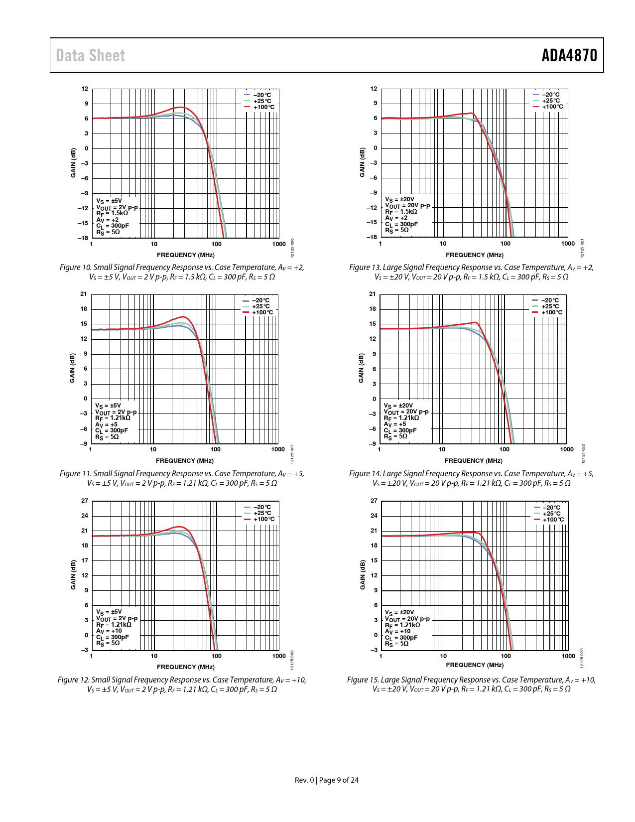

Data Sheet. ADA4870. –20°C. +25°C. +100°C. N (. S = ±5V. S = ±20V. –12. OUT = 2V p-p. OUT = 20V p-p. F = 1.5kΩ. AV = +2. –15. V = +2. L = 300pF. S = 5Ω
 Download PDF
Model Line for this Datasheet Text Version of Document Data Sheet  ADA4870  12  12  –20°C  –20°C  9  +25°C  9  +25°C  +100°C  +100°C  6  6  3  3  0  0  B)  B)  d  d  N (  –3  –3  N (  AI  AI  G  –6  G  –6  –9  –9  V  V  S = ±5V  S = ±20V  –12  V  V  OUT = 2V p-p  –12  OUT = 20V p-p  R  R  F = 1.5kΩ  F = 1.5kΩ  A  AV = +2  –15  V = +2  –15  C  C  L = 300pF  L = 300pF  R  R  S = 5Ω  S = 5Ω  –18  –18  1  10  100  1000  0061  10  100  1000  021FREQUENCY (MHz)  12125-FREQUENCY (MHz)  12125- Figure 10. Small Signal Frequency Response vs. Case Temperature, AV = +2, Figure 13. Large Signal Frequency Response vs. Case Temperature, AV = +2, VS = ±5 V, VOUT = 2 V p-p, RF = 1.5 kΩ, CL = 300 pF, RS = 5 Ω VS = ±20 V, VOUT = 20 V p-p, RF = 1.5 kΩ, CL = 300 pF, RS = 5 Ω21  21  –20°C  –20°C  18  +25°C  18  +25°C  +100°C  +100°C  15  15  12  12  9  9  B)  B)  d  d  N (  6  N (  6  AI  AI  G  3  G  3  0  0  VS = ±5V  VS = ±20V  –3  VOUT = 2V p-p  –3  VOUT = 20V p-p  RF = 1.21kΩ  RF = 1.21kΩ  A  A  –6  V = +5  V = +5  C  –6  L = 300pF  CL = 300pF  RS = 5Ω  RS = 5Ω  –9  –9  1  10  100  1000  0071  10  100  1000  022FREQUENCY (MHz)  FREQUENCY (MHz)  12125- 12125- Figure 11. Small Signal Frequency Response vs. Case Temperature, AV = +5, Figure 14. Large Signal Frequency Response vs. Case Temperature, AV = +5, VS = ±5 V, VOUT = 2 V p-p, RF = 1.21 kΩ, CL = 300 pF, RS = 5 Ω VS = ±20 V, VOUT = 20 V p-p, RF = 1.21 kΩ, CL = 300 pF, RS = 5 Ω27  27  –20°C  –20°C  24  +25°C  24  +25°C  +100°C  +100°C  21  21  18  18  17  15  B)  B)  d  d  N (  12  N (  12  AI  AI  G  9  G  9  6  6  VS = ±5V  VS = ±20V  3  VOUT = 2V p-p  3  VOUT = 20V p-p  RF = 1.21kΩ  RF = 1.21kΩ  A  A  0  V = +10  V = +10  C  0  L = 300pF  CL = 300pF  RS = 5Ω  RS = 5Ω  –3  –3  1  10  100  1000  023 0081  10  100  1000  FREQUENCY (MHz)  FREQUENCY (MHz)  12125- 12125- Figure 12. Small Signal Frequency Response vs. Case Temperature, AV = +10, Figure 15. Large Signal Frequency Response vs. Case Temperature, AV = +10, VS = ±5 V, VOUT = 2 V p-p, RF = 1.21 kΩ, CL = 300 pF, RS = 5 Ω VS = ±20 V, VOUT = 20 V p-p, RF = 1.21 kΩ, CL = 300 pF, RS = 5 Ω Rev. 0 | Page 9 of 24 Document Outline Features Applications Functional Block Diagram General Description Revision History Specifications ±20 V Supply ±5 V Supply Absolute Maximum Ratings Maximum Power Dissipation ESD Caution Pin Configuration and Function Descriptions Typical Performance Characteristics Applications Information , Initial Power-Up, and Short-Circuit Thermal Protection Shutdown () Feedback Resistor Selection Capacitive Load Driving Heat and Thermal Management Power Dissipation Safe Operating Area Printed Circuit Board (PCB) Thermal Modeling Heat Sink Selection Power Supplies and Decoupling Composite Amplifier Outline Dimensions Ordering Guide
