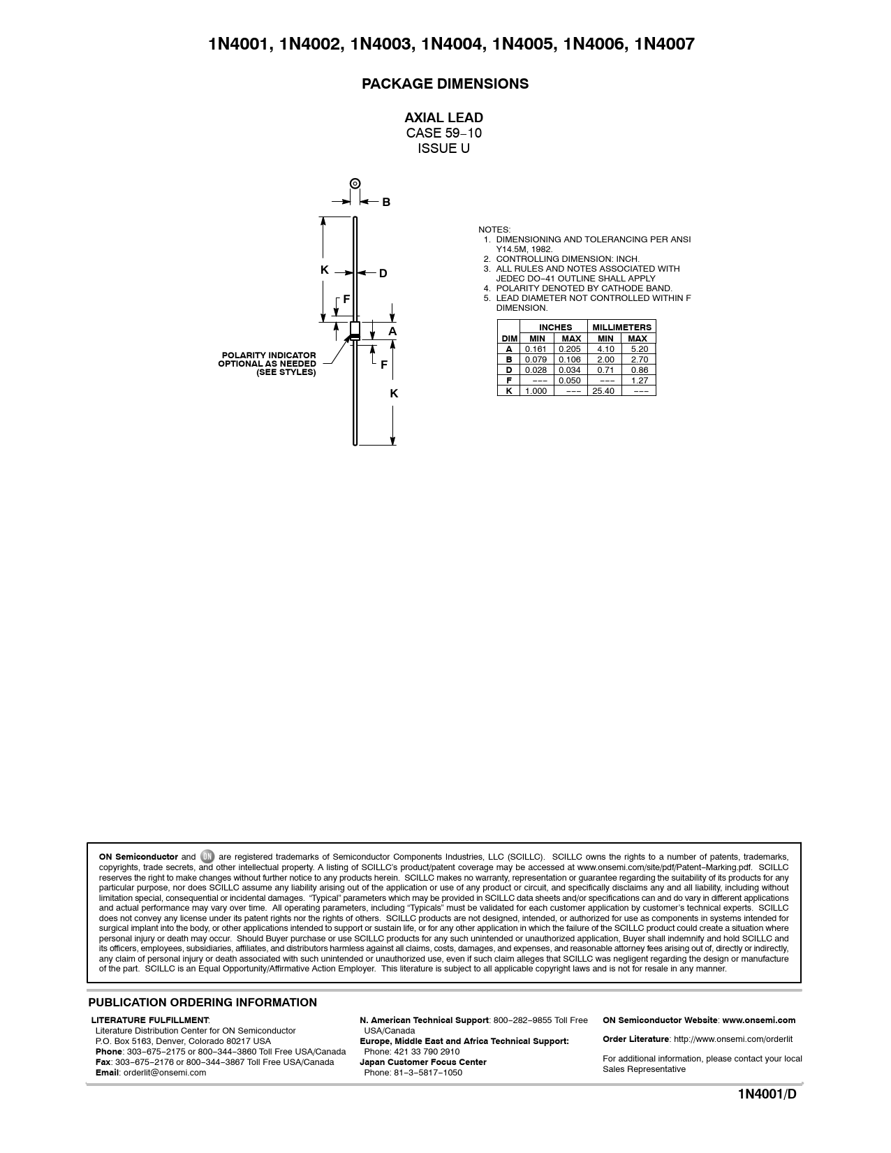

1N4001, 1N4002, 1N4003, 1N4004, 1N4005, 1N4006, 1N4007 PACKAGE DIMENSIONS AXIAL LEAD
CASE 59−10 ISSUE U
B
NOTES: 1. DIMENSIONING AND TOLERANCING PER ANSI Y14.5M, 1982. 2. CONTROLLING DIMENSION: INCH.
K D
3. ALL RULES AND NOTES ASSOCIATED WITH JEDEC DO−41 OUTLINE SHALL APPLY 4. POLARITY DENOTED BY CATHODE BAND.
F
5. LEAD DIAMETER NOT CONTROLLED WITHIN F DIMENSION.
A INCHES MILLIMETERS DIM MIN MAX MIN MAX A
0.161 0.205 4.10 5.20
POLARITY INDICATOR OPTIONAL AS NEEDED F B
0.079 0.106 2.00 2.70
D
0.028 0.034 0.71 0.86
(SEE STYLES) F
−−− 0.050 −−− 1.27
K K
1.000 −−− 25.40 −−−
