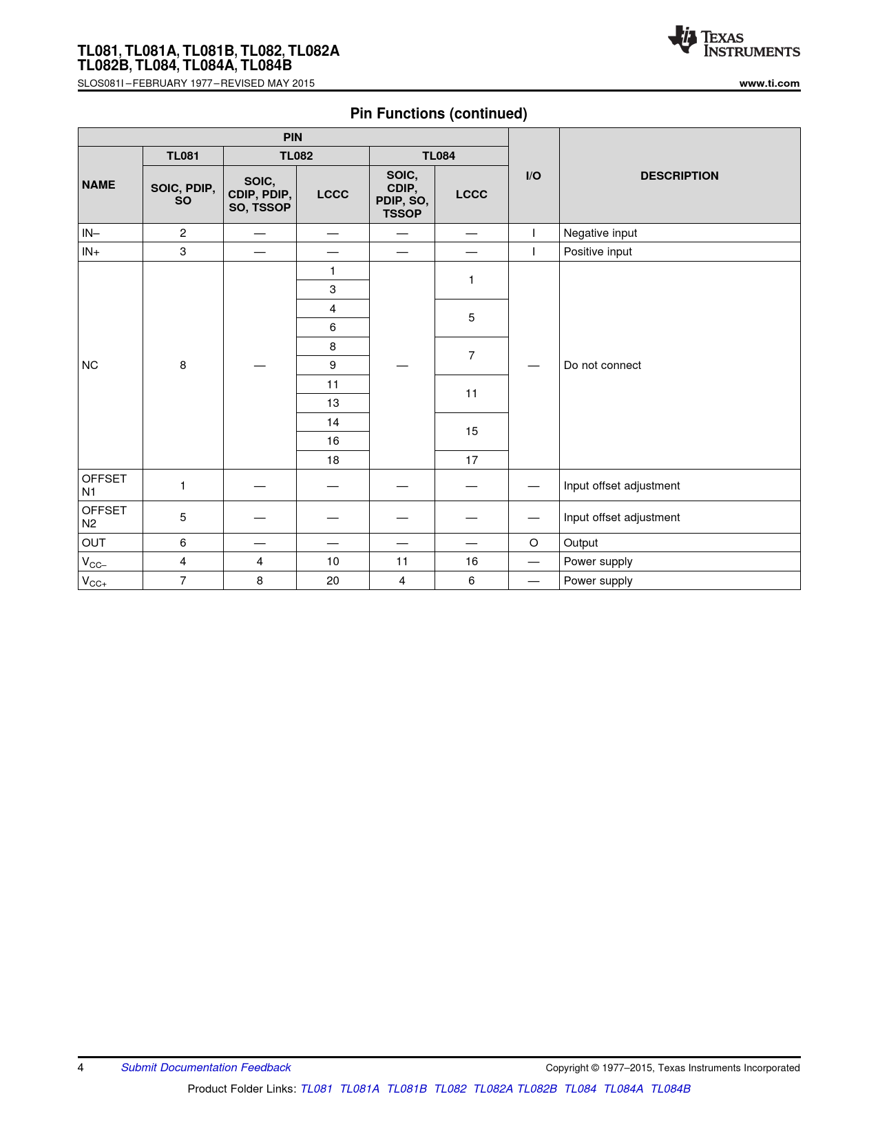

TL081. , TL081A,. TL081B. , TL082,. TL082A. TL082B. , TL084,. TL084A. , TL084B. www.ti.com. Pin Functions (continued). PIN. TL082. TL084. SOIC,. I/O
TL081 , TL081A, TL081B , TL082, TL082A TL082B , TL084, TL084A , TL084B www.ti.com Pin Functions (continued) PIN TL082 TL084 SOIC, I/O
SLOS081I – FEBRUARY 1977 – REVISED MAY 2015
www.ti.com Pin Functions (continued) PIN TL081 TL082 TL084 SOIC, I/O DESCRIPTION SOIC, NAME SOIC, PDIP, CDIP, CDIP, PDIP, LCCC LCCC SO PDIP, SO, SO, TSSOP TSSOP
IN– 2 — — — — I Negative input IN+ 3 — — — — I Positive input 1 1 3 4 5 6 8 7 NC 8 — 9 — — Do not connect 11 11 13 14 15 16 18 17 OFFSET 1 — — — — — Input offset adjustment N1 OFFSET 5 — — — — — Input offset adjustment N2 OUT 6 — — — — O Output VCC– 4 4 10 11 16 — Power supply VCC+ 7 8 20 4 6 — Power supply 4 Submit Documentation Feedback Copyright © 1977–2015, Texas Instruments Incorporated Product Folder Links: TL081 TL081A TL081B TL082 TL082A TL082B TL084 TL084A TL084B Document Outline 1 Features 2 Applications 3 Description Table of Contents 4 Revision History 5 Pin Configuration and Functions 6 Specifications 6.1 Absolute Maximum Ratings 6.2 ESD Ratings 6.3 Recommended Operating Conditions 6.4 Thermal Information 6.5 Electrical Characteristics for TL08xC, TL08xxC, and TL08xI 6.6 Electrical Characteristics for TL08xM and TL084x 6.7 Operating Characteristics 6.8 Dissipation Rating Table 6.9 Typical Characteristics 7 Parameter Measurement Information 8 Detailed Description 8.1 Overview 8.2 Functional Block Diagram 8.3 Feature Description 8.3.1 Total Harmonic Distortion 8.3.2 Slew Rate 8.4 Device Functional Modes 9 Applications and Implementation 9.1 Application Information 9.2 Typical Applications 9.2.1 Inverting Amplifier Application 9.2.1.1 Design Requirements 9.2.1.2 Detailed Design Procedure 9.2.1.3 Application Curve 9.3 System Examples 9.3.1 General Applications 10 Power Supply Recommendations 11 Layout 11.1 Layout Guidelines 11.2 Layout Examples 12 Device and Documentation Support 12.1 Documentation Support 12.1.1 Related Documentation 12.2 Related Links 12.3 Community Resources 12.4 Trademarks 12.5 Electrostatic Discharge Caution 12.6 Glossary 13 Mechanical, Packaging, and Orderable Information
