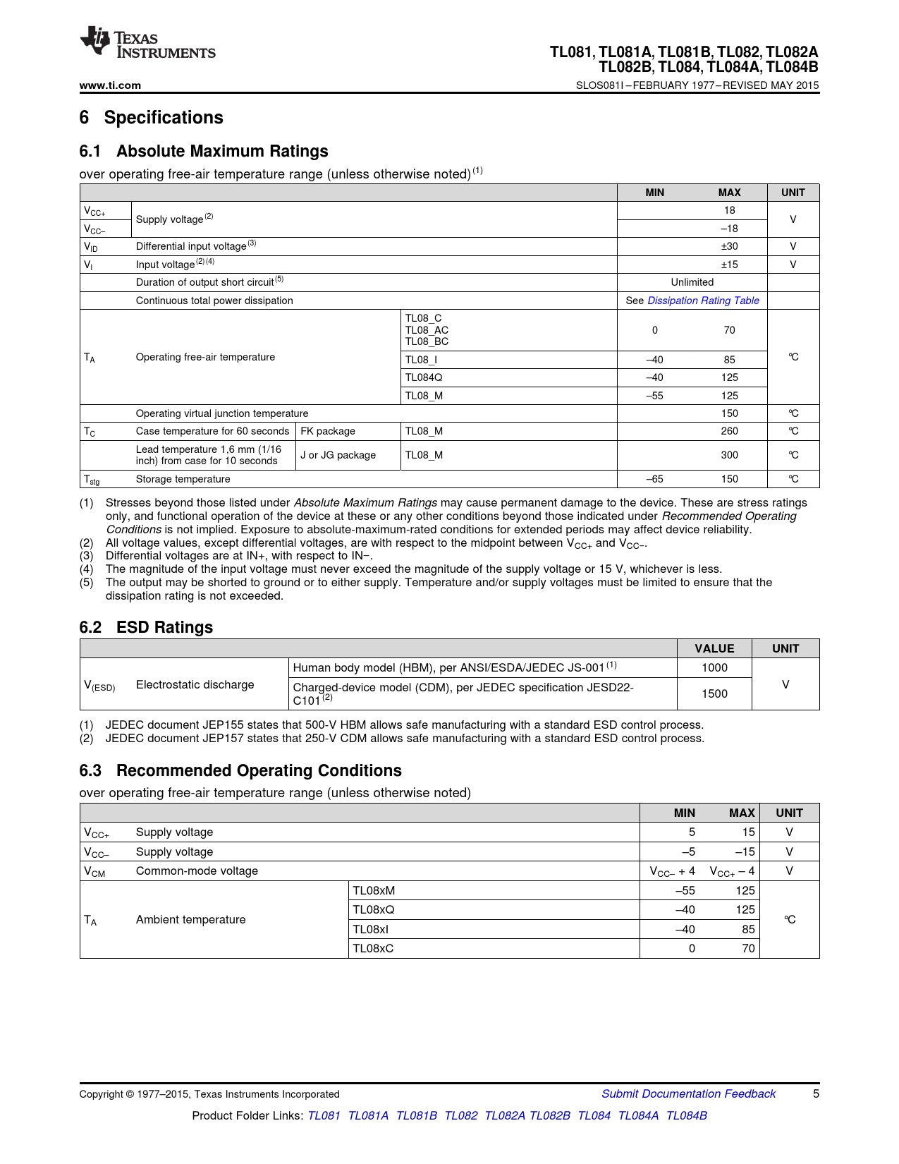

TL081. , TL081A,. TL081B. , TL082,. TL082A. TL082B,. TL084. , TL084A,. TL084B. www.ti.com. 6 Specifications. 6.1 Absolute Maximum Ratings. MIN
TL081 , TL081A, TL081B , TL082, TL082A TL082B, TL084 , TL084A, TL084B www.ti.com 6 Specifications 6.1 Absolute Maximum Ratings MIN
link to page 8
SLOS081I – FEBRUARY 1977 – REVISED MAY 2015
over operating free-air temperature range (unless otherwise noted)(1)
MIN MAX UNIT
VCC+ 18 Supply voltage(2) V VCC– –18 VID Differential input voltage(3) ±30 V VI Input voltage(2)(4) ±15 V Duration of output short circuit(5) Unlimited Continuous total power dissipation See Dissipation Rating Table TL08_C TL08_AC 0 70 TL08_BC TA Operating free-air temperature °C TL08_I –40 85 TL084Q –40 125 TL08_M –55 125 Operating virtual junction temperature 150 °C TC Case temperature for 60 seconds FK package TL08_M 260 °C Lead temperature 1,6 mm (1/16 J or JG package TL08_M 300 °C inch) from case for 10 seconds Tstg Storage temperature –65 150 °C (1) Stresses beyond those listed under Absolute Maximum Ratings may cause permanent damage to the device. These are stress ratings only, and functional operation of the device at these or any other conditions beyond those indicated under Recommended Operating Conditions is not implied. Exposure to absolute-maximum-rated conditions for extended periods may affect device reliability. (2) All voltage values, except differential voltages, are with respect to the midpoint between VCC+ and VCC−. (3) Differential voltages are at IN+, with respect to IN−. (4) The magnitude of the input voltage must never exceed the magnitude of the supply voltage or 15 V, whichever is less. (5) The output may be shorted to ground or to either supply. Temperature and/or supply voltages must be limited to ensure that the dissipation rating is not exceeded.
6.2 ESD Ratings VALUE UNIT
Human body model (HBM), per ANSI/ESDA/JEDEC JS-001(1) 1000 V(ESD) Electrostatic discharge V Charged-device model (CDM), per JEDEC specification JESD22- 1500 C101(2) (1) JEDEC document JEP155 states that 500-V HBM allows safe manufacturing with a standard ESD control process. (2) JEDEC document JEP157 states that 250-V CDM allows safe manufacturing with a standard ESD control process.
6.3 Recommended Operating Conditions
MIN MAX UNIT
VCC+ Supply voltage 5 15 V VCC– Supply voltage –5 –15 V VCM Common-mode voltage VCC– + 4 VCC+ – 4 V TL08xM –55 125 TL08xQ –40 125 TA Ambient temperature °C TL08xI –40 85 TL08xC 0 70 Copyright © 1977–2015, Texas Instruments Incorporated Submit Documentation Feedback 5 Product Folder Links: TL081 TL081A TL081B TL082 TL082A TL082B TL084 TL084A TL084B Document Outline 1 Features 2 Applications 3 Description Table of Contents 4 Revision History 5 Pin Configuration and Functions 6 Specifications 6.1 Absolute Maximum Ratings 6.2 ESD Ratings 6.3 Recommended Operating Conditions 6.4 Thermal Information 6.5 Electrical Characteristics for TL08xC, TL08xxC, and TL08xI 6.6 Electrical Characteristics for TL08xM and TL084x 6.7 Operating Characteristics 6.8 Dissipation Rating Table 6.9 Typical Characteristics 7 Parameter Measurement Information 8 Detailed Description 8.1 Overview 8.2 Functional Block Diagram 8.3 Feature Description 8.3.1 Total Harmonic Distortion 8.3.2 Slew Rate 8.4 Device Functional Modes 9 Applications and Implementation 9.1 Application Information 9.2 Typical Applications 9.2.1 Inverting Amplifier Application 9.2.1.1 Design Requirements 9.2.1.2 Detailed Design Procedure 9.2.1.3 Application Curve 9.3 System Examples 9.3.1 General Applications 10 Power Supply Recommendations 11 Layout 11.1 Layout Guidelines 11.2 Layout Examples 12 Device and Documentation Support 12.1 Documentation Support 12.1.1 Related Documentation 12.2 Related Links 12.3 Community Resources 12.4 Trademarks 12.5 Electrostatic Discharge Caution 12.6 Glossary 13 Mechanical, Packaging, and Orderable Information
