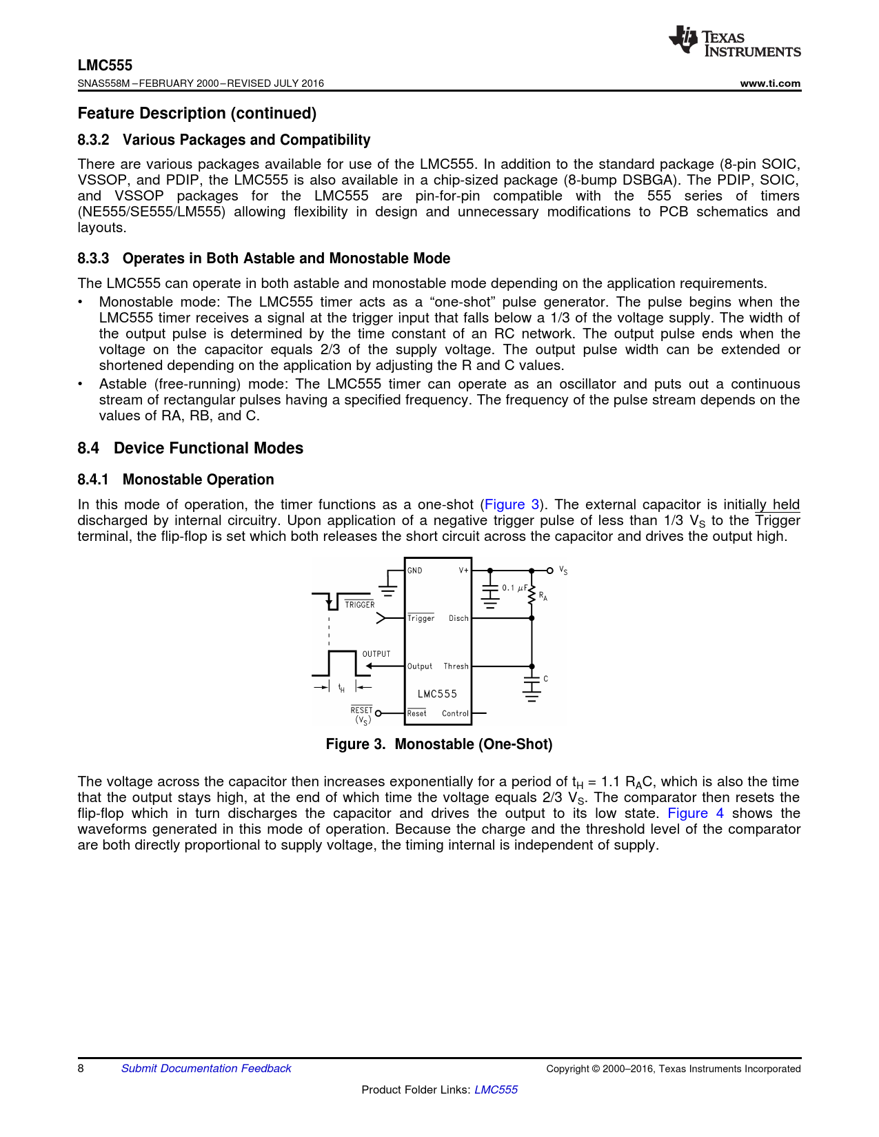

8.4 Device Functional Modes 8.4.1 Monostable Operation
In this mode of operation, the timer functions as a one-shot (Figure 3). The external capacitor is initially held discharged by internal circuitry. Upon application of a negative trigger pulse of less than 1/3 VS to the Trigger terminal, the flip-flop is set which both releases the short circuit across the capacitor and drives the output high.
Figure 3. Monostable (One-Shot)
The voltage across the capacitor then increases exponentially for a period of tH = 1.1 RAC, which is also the time that the output stays high, at the end of which time the voltage equals 2/3 VS. The comparator then resets the flip-flop which in turn discharges the capacitor and drives the output to its low state. Figure 4 shows the waveforms generated in this mode of operation. Because the charge and the threshold level of the comparator are both directly proportional to supply voltage, the timing internal is independent of supply. 8 Submit Documentation Feedback Copyright © 2000–2016, Texas Instruments Incorporated Product Folder Links: LMC555 Document Outline 1 Features 2 Applications 3 Description Table of Contents 4 Revision History 5 Pin Configuration and Functions 6 Specifications 6.1 Absolute Maximum Ratings 6.2 ESD Ratings 6.3 Recommended Operating Conditions 6.4 Thermal Information 6.5 Electrical Characteristics 7 Parameter Measurement Information 8 Detailed Description 8.1 Overview 8.2 Functional Block Diagram 8.3 Feature Description 8.3.1 Low-Power Dissipation 8.3.2 Various Packages and Compatibility 8.3.3 Operates in Both Astable and Monostable Mode 8.4 Device Functional Modes 8.4.1 Monostable Operation 8.4.2 Astable Operation 9 Application and Implementation 9.1 Application Information 9.2 Typical Application 9.2.1 Design Requirements 9.2.2 Detailed Design Procedure 9.2.3 Application Curve 9.3 Frequency Divider 9.3.1 Design Requirements 9.3.2 Application Curve 9.4 Pulse Width Modulator 9.4.1 Design Requirements 9.4.2 Application Curve 9.5 Pulse Position Modulator 9.5.1 Design Requirements 9.5.2 Application Curve 9.6 50% Duty Cycle Oscillator 9.6.1 Design Requirements 10 Power Supply Recommendations 11 Layout 11.1 Layout Guidelines 11.2 Layout Example 12 Device and Documentation Support 12.1 Receiving Notification of Documentation Updates 12.2 Community Resources 12.3 Trademarks 12.4 Electrostatic Discharge Caution 12.5 Glossary 13 Mechanical, Packaging, and Orderable Information
