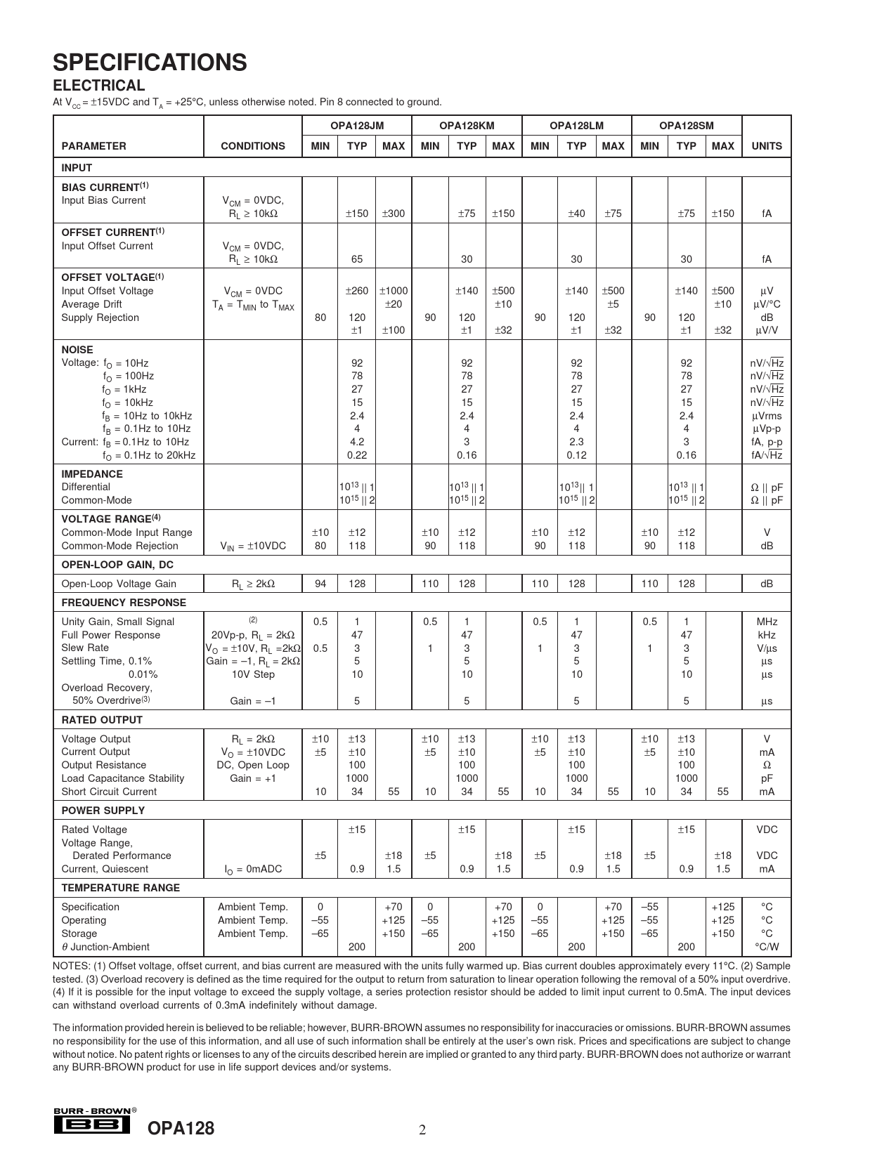

SPECIFICATIONS ELECTRICAL. OPA128JM. OPA128KM. OPA128LM. OPA128SM. PARAMETER. CONDITIONS. MIN. TYP. MAX. UNITS. INPUT. BIAS CURRENT(1)
SPECIFICATIONS ELECTRICAL OPA128JM OPA128KM OPA128LM OPA128SM PARAMETER CONDITIONS MIN TYP MAX UNITS INPUT BIAS CURRENT(1)
At V = ±15VDC and T = +25°C, unless otherwise noted. Pin 8 connected to ground. CC A
OPA128JM OPA128KM OPA128LM OPA128SM PARAMETER CONDITIONS MIN TYP MAX MIN TYP MAX MIN TYP MAX MIN TYP MAX UNITS INPUT BIAS CURRENT(1)
Input Bias Current VCM = 0VDC, RL ≥ 10kΩ ±150 ±300 ±75 ±150 ±40 ±75 ±75 ±150 fA
OFFSET CURRENT(1)
Input Offset Current VCM = 0VDC, RL ≥ 10kΩ 65 30 30 30 fA
OFFSET VOLTAGE(1)
Input Offset Voltage VCM = 0VDC ±260 ±1000 ±140 ±500 ±140 ±500 ±140 ±500 µV Average Drift T ± A = TMIN to TMAX 20 ±10 ±5 ±10 µV/°C Supply Rejection 80 120 90 120 90 120 90 120 dB ±1 ±100 ±1 ±32 ±1 ±32 ±1 ±32 µV/V
NOISE
Voltage: fO = 10Hz 92 92 92 92 nV/√Hz fO = 100Hz 78 78 78 78 nV/√Hz fO = 1kHz 27 27 27 27 nV/√Hz fO = 10kHz 15 15 15 15 nV/√Hz fB = 10Hz to 10kHz 2.4 2.4 2.4 2.4 µVrms fB = 0.1Hz to 10Hz 4 4 4 4 µVp-p Current: fB = 0.1Hz to 10Hz 4.2 3 2.3 3 fA, p-p fO = 0.1Hz to 20kHz 0.22 0.16 0.12 0.16 fA/√Hz
IMPEDANCE
Differential 1013 || 1 1013 || 1 1013 || 1 1013 || 1 Ω || pF Common-Mode 1015 || 2 1015 || 2 1015 || 2 1015 || 2 Ω || pF
VOLTAGE RANGE(4)
Common-Mode Input Range ±10 ±12 ±10 ±12 ±10 ±12 ±10 ±12 V Common-Mode Rejection VIN = ±10VDC 80 118 90 118 90 118 90 118 dB
OPEN-LOOP GAIN, DC
Open-Loop Voltage Gain RL ≥ 2kΩ 94 128 110 128 110 128 110 128 dB
FREQUENCY RESPONSE
Unity Gain, Small Signal (2) 0.5 1 0.5 1 0.5 1 0.5 1 MHz Full Power Response 20Vp-p, RL = 2kΩ 47 47 47 47 kHz Slew Rate VO = ±10V, RL = 2kΩ 0.5 3 1 3 1 3 1 3 V/µs Settling Time, 0.1% Gain = –1, RL = 2kΩ 5 5 5 5 µs 0.01% 10V Step 10 10 10 10 µs Overload Recovery, 50% Overdrive(3) Gain = –1 5 5 5 5 µs
RATED OUTPUT
Voltage Output RL = 2kΩ ±10 ±13 ±10 ±13 ±10 ±13 ±10 ±13 V Current Output VO = ±10VDC ±5 ±10 ±5 ±10 ±5 ±10 ±5 ±10 mA Output Resistance DC, Open Loop 100 100 100 100 Ω Load Capacitance Stability Gain = +1 1000 1000 1000 1000 pF Short Circuit Current 10 34 55 10 34 55 10 34 55 10 34 55 mA
POWER SUPPLY
Rated Voltage ±15 ±15 ±15 ±15 VDC Voltage Range, Derated Performance ±5 ±18 ±5 ±18 ±5 ±18 ±5 ±18 VDC Current, Quiescent IO = 0mADC 0.9 1.5 0.9 1.5 0.9 1.5 0.9 1.5 mA
TEMPERATURE RANGE
Specification Ambient Temp. 0 +70 0 +70 0 +70 –55 +125 °C Operating Ambient Temp. –55 +125 –55 +125 –55 +125 –55 +125 °C Storage Ambient Temp. –65 +150 –65 +150 –65 +150 –65 +150 °C θ Junction-Ambient 200 200 200 200 °C/W NOTES: (1) Offset voltage, offset current, and bias current are measured with the units fully warmed up. Bias current doubles approximately every 11°C. (2) Sample tested. (3) Overload recovery is defined as the time required for the output to return from saturation to linear operation following the removal of a 50% input overdrive. (4) If it is possible for the input voltage to exceed the supply voltage, a series protection resistor should be added to limit input current to 0.5mA. The input devices can withstand overload currents of 0.3mA indefinitely without damage. The information provided herein is believed to be reliable; however, BURR-BROWN assumes no responsibility for inaccuracies or omissions. BURR-BROWN assumes no responsibility for the use of this information, and all use of such information shall be entirely at the user’s own risk. Prices and specifications are subject to change without notice. No patent rights or licenses to any of the circuits described herein are implied or granted to any third party. BURR-BROWN does not authorize or warrant any BURR-BROWN product for use in life support devices and/or systems. ®
