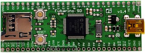

The Fubarino SD board brings affordable, breadboard compatible high speed computing power to the Arduino-compatible chipKIT/MPIDE platform.
Detailed Description
It is able to run almost all Arduino sketches right out of the box at a great price, and includes more memory, speed, and I/O pins than a typical Arduino or clone. And it includes a microSD card slot for easy sketch access to huge file storage.
Development Board Microchip chipKIT Fubarino SD (TCHIP010)
Features
  •     PIC32MX440F256H - 256K Flash, 32K RAM @ 80MHz 32-bit MIPS core
  •     MPIDE (Mulit Platform IDE - a fork of the Arduino IDE) supports Fubarino SD board out of the box
  •     45 Digital IO (many are 5V tolerant)
  •     15 Analog inputs (10-bit)
  •     2 hardware serial ports (UARTs) - one accessible on pins 28 (rx) and 29 (tx), the other on pins 8 and 9, plus a serial connection over USB (12Mbps)
  •     Comes with headers for easy mounting on a breadboard
  •     Directly compatible with 3.3V devices. No level converting necessary.
  •     Small form factor - easy to integrate into your project
  •     Great for projects that need two hardware serial ports plus a USB connection and file storage
  •     Easy to program, no additional hardware is required to load sketches – just plug into a USB port and run MPIDE
  •     Can be used as USB to microSD adapter
  •     ICSP Header for use with optional Microchip hardware programmer/debuggers (like PICKit3, ICD3 or REAL ICE)
  •     Can be powered through USB, or 2.3V to 13V DC input power
  •     Extra power and ground pins for ease of wiring into your project
  •     microSD slot connected to the PIC32 hardware SPI port
  •     microSD card accessible for large file access from your sketches
  •     USB bootloader (avrdude compatible) for seemless sketch uploading within MPIDE
