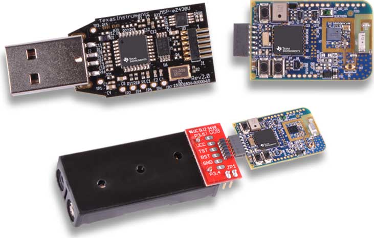

The eZ430-RF2560 is a complete TI Bluetooth evaluation and software development tool for the MSP430 and CC2560 that includes all the necessary hardware and software in a convenient USB stick.
Detailed Description
The tool includes a USB-powered emulator to program and debug your application and two CC2560-based Bluetooth target boards featuring the highly integrated MSP430BT5190 ultra-low-power MCU. The required embedded software comes pre-flashed on the MSP430 device for ease of use out of the box. The tool also comes with a sample PC game that you can play using the CC2560 target board as a remote controller. Users may download the eZ430-RF2560 Software Development Kit (SDK) to develop and instantly demonstrate Bluetooth applications using the included battery expansion board and AAA batteries. The eZ430-RF2560 SDK includes MindTree's Ethermind Bluetooth stack, Serial Port Profile (SPP) and embedded sample applications running on FreeRTOS.
NOTE: The eZ430-RF2560 SDK license requires that the MSP430BT5190 must be used only in combination with TI Bluetooth solutions such as the CC2560.
Texas Instruments EZ430-RF2560
Features
  • CC2560 – TI single-chip Bluetooth v2.1+EDR solution
  • MSP430BT5190 – 25MHz, 256KB Flash, 16KB RAM, 12 Bit ADC, 4 USCIs, 32-bit HW Multi
  • Pre-flashed eZ430-RF2560 SDK with MindTree’s Ethermind Bluetooth stack, Serial Port Profile (SPP) and embedded sample applications running on FreeRTOS
  • Interactive sample PC game for demonstration of Bluetooth use in a remote control application
  • VTI’s 3 axis accelerometer (CMA3000-D01) with user selectable 2 g and 8 g measurement range and capable of sub-10 uA current consumption at 40 Hz sample rate.
  • Temperature sensors with accuracy as low as +/- 2 degrees Celsius from -40C to +85C.
  • Supports software development with the MSP430BT5190 microcontroller
  • Removable USB stick enclosure
  • 2 LEDs
  • 3 pushbuttons
