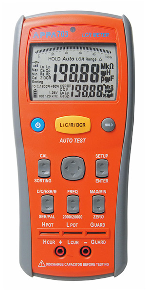

LCR Meter APPA 703
| Manufacturer | APPA |
| Series | 700 |
| Part Number | APPA 703 |
Features
Detailed Description
- Auto ON/OFF backlit
- Automatically measuring L, C and R with Q, D, and θ (703)
- Safe and easy used USB interface
- Unscrew only one screw to remove battery door for battery replacement
- Ergonomically designed slim shape protective holster
- Ergonomically designed test clip with comfort-grip
