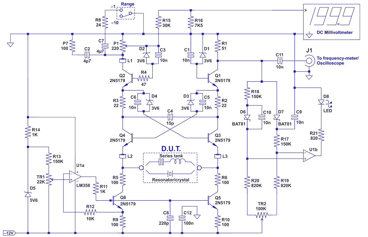

The circuit is based on the cross-quad topology [2]: Q1 to Q4 form the quadruplet, and the circuit normally synthesizes a zero resistance between the emitters of Q3 and Q4, by cancelling parasitic parameters (Figure 1).

Here, to use the circuit as an oscillator, some modifications have been made: the Zeners D1 to D4 ensure the transistors have enough C-E dynamic to “breathe” properly, and an adjustable positive feedback is introduced via pot P1 (yes, positive feedback is introduced from the collector of Q2 to its base; that’s how things work in the strange and inverted world of the cross-quad).
With this modification, the resistance between the wiper of P1 and ground appears with an opposite sign between the emitters of Q3 and Q4. When the magnitude of this resistance equals that of the tank circuit, the circuit starts to oscillate. The current in the other arm of the quad is intercepted by R1, and results in a voltage appearing on the diode detector D6/D7, and the output J1. D7 is a peak detector compensated by D6. When a signal is detected, it increases the voltage on the (–) input of U1b, and pulls the output down, lighting D8.
The cross-quad is biased by two current sources, Q5 and Q6, delivering precisely 5 mA thanks to U1a. This bias current also flows through P1, and generates a voltage drop equal to the setting of the potentiometer times 5 mA.
This voltage is divided by five by R15/R16, and sent to a millivoltmeter; the value displayed in mV now reflects exactly the potentiometer’s value in ohms. Thanks to this trick, the actual value can be displayed accurately, without having to resort to approximate scales or further calculations. The resonant frequency can be measured by connecting a frequency meter to J1.
The ×1/×10 switch can reduce the potentiometer’s apparent value by paralleling R8, bringing the full scale value to 22 Ω instead of 220 Ω. Because C7 blocks the DC, the displayed value is unaffected and retains its full resolution.
The role of many components has remained unexplained so far: L1 to L3, R2 to R7, C2, C4. They all contribute to the stability of the circuit, and suppress unwanted oscillations. Without them, the circuit could oscillate at UHF frequencies; the few centimetres of the test terminals form an open transmission line having resonant frequencies of its own, and since it has a very high Q, it would invariably dominate.
The additional components constrain the frequency range: here, the maximum usable frequency is about 100 MHz (to keep an acceptable accuracy). It is a trade-off between performance and usability. L1 to L3 are ferrite beads of ~80 nH (50 Ω). Needless to say that careful layout techniques are a must for a stable, proper operation.
