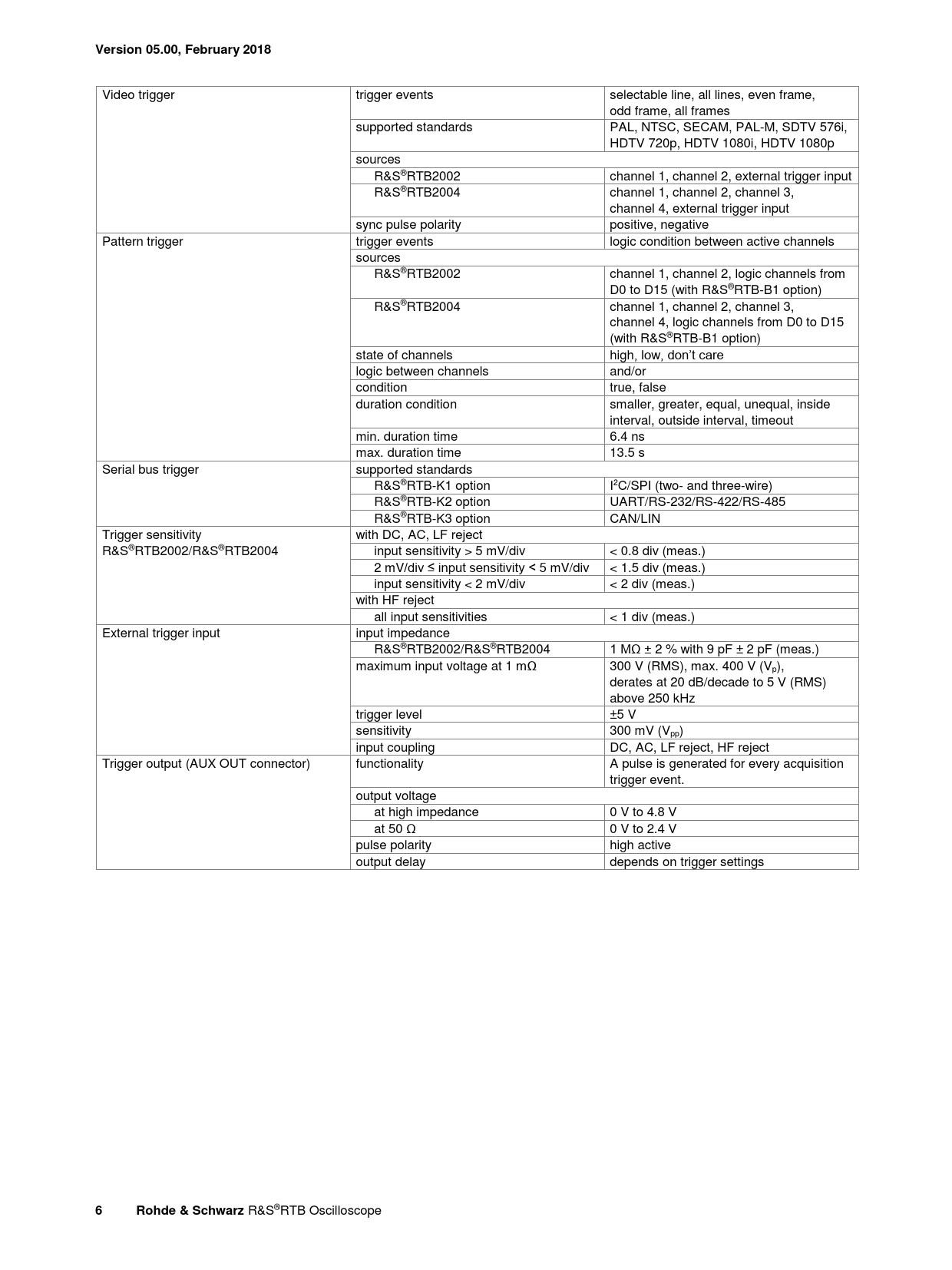

Video trigger trigger events selectable line, all lines, even frame, odd frame, all frames supported standards PAL, NTSC, SECAM, PAL-M, SDTV 576i, HDTV 720p, HDTV 1080i, HDTV 1080p sources R&S®RTB2002 channel 1, channel 2, external trigger input R&S®RTB2004 channel 1, channel 2, channel 3, channel 4, external trigger input sync pulse polarity positive, negative Pattern trigger trigger events logic condition between active channels sources R&S®RTB2002 channel 1, channel 2, logic channels from D0 to D15 (with R&S®RTB-B1 option) R&S®RTB2004 channel 1, channel 2, channel 3, channel 4, logic channels from D0 to D15 (with R&S®RTB-B1 option) state of channels high, low, don’t care logic between channels and/or condition true, false duration condition smaller, greater, equal, unequal, inside interval, outside interval, timeout min. duration time 6.4 ns max. duration time 13.5 s Serial bus trigger supported standards R&S®RTB-K1 option I2C/SPI (two- and three-wire) R&S®RTB-K2 option UART/RS-232/RS-422/RS-485 R&S®RTB-K3 option CAN/LIN Trigger sensitivity with DC, AC, LF reject R&S®RTB2002/R&S®RTB2004 input sensitivity > 5 mV/div < 0.8 div (meas.) 2 mV/div ≤ input sensitivity < 5 mV/div < 1.5 div (meas.) input sensitivity < 2 mV/div < 2 div (meas.) with HF reject all input sensitivities < 1 div (meas.) External trigger input input impedance R&S®RTB2002/R&S®RTB2004 1 MΩ ± 2 % with 9 pF ± 2 pF (meas.) maximum input voltage at 1 mΩ 300 V (RMS), max. 400 V (Vp), derates at 20 dB/decade to 5 V (RMS) above 250 kHz trigger level ±5 V sensitivity 300 mV (Vpp) input coupling DC, AC, LF reject, HF reject Trigger output (AUX OUT connector) functionality A pulse is generated for every acquisition trigger event. output voltage at high impedance 0 V to 4.8 V at 50 Ω 0 V to 2.4 V pulse polarity high active output delay depends on trigger settings
