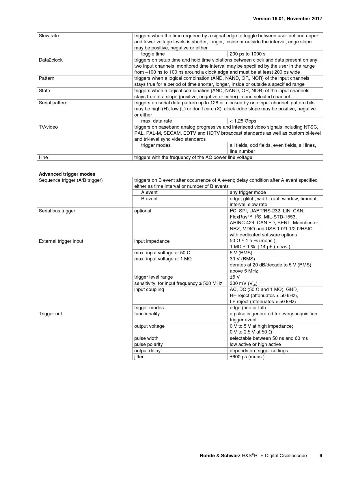

Slew rate triggers when the time required by a signal edge to toggle between user-defined upper and lower voltage levels is shorter, longer, inside or outside the interval; edge slope may be positive, negative or either toggle time 200 ps to 1000 s Data2clock triggers on setup time and hold time violations between clock and data present on any two input channels; monitored time interval may be specified by the user in the range from –100 ns to 100 ns around a clock edge and must be at least 200 ps wide Pattern triggers when a logical combination (AND, NAND, OR, NOR) of the input channels stays true for a period of time shorter, longer, inside or outside a specified range State triggers when a logical combination (AND, NAND, OR, NOR) of the input channels stays true at a slope (positive, negative or either) in one selected channel Serial pattern triggers on serial data pattern up to 128 bit clocked by one input channel; pattern bits may be high (H), low (L) or don’t care (X); clock edge slope may be positive, negative or either max. data rate < 1.25 Gbps TV/video triggers on baseband analog progressive and interlaced video signals including NTSC, PAL, PAL-M, SECAM, EDTV and HDTV broadcast standards as well as custom bi-level and tri-level sync video standards trigger modes all fields, odd fields, even fields, all lines, line number Line triggers with the frequency of the AC power line voltage
Advanced trigger modes
Sequence trigger (A/B trigger) triggers on B event after occurrence of A event; delay condition after A event specified either as time interval or number of B events A event any trigger mode B event edge, glitch, width, runt, window, timeout, interval, slew rate Serial bus trigger optional I2C, SPI, UART/RS-232, LIN, CAN, FlexRay™, I2S, MIL-STD-1553, ARINC 429, CAN FD, SENT, Manchester, NRZ, MDIO and USB 1.0/1.1/2.0/HSIC with dedicated software options External trigger input
input impedance 50 Ω ± 1.5 % (meas.), 1 MΩ ± 1 % || 14 pF (meas.) max. input voltage at 50 Ω 5 V (RMS) max. input voltage at 1 MΩ 30 V (RMS) derates at 20 dB/decade to 5 V (RMS) above 5 MHz trigger level range ±5 V sensitivity, for input frequency ≤ 500 MHz 300 mV (Vpp) input coupling AC, DC (50 Ω and 1 MΩ), GND, HF reject (attenuates > 50 kHz), LF reject (attenuates < 50 kHz) trigger modes edge (rise or fall) Trigger out functionality a pulse is generated for every acquisition trigger event output voltage 0 V to 5 V at high impedance; 0 V to 2.5 V at 50 Ω pulse width selectable between 50 ns and 60 ms pulse polarity low active or high active output delay depends on trigger settings jitter ±600 ps (meas.)
