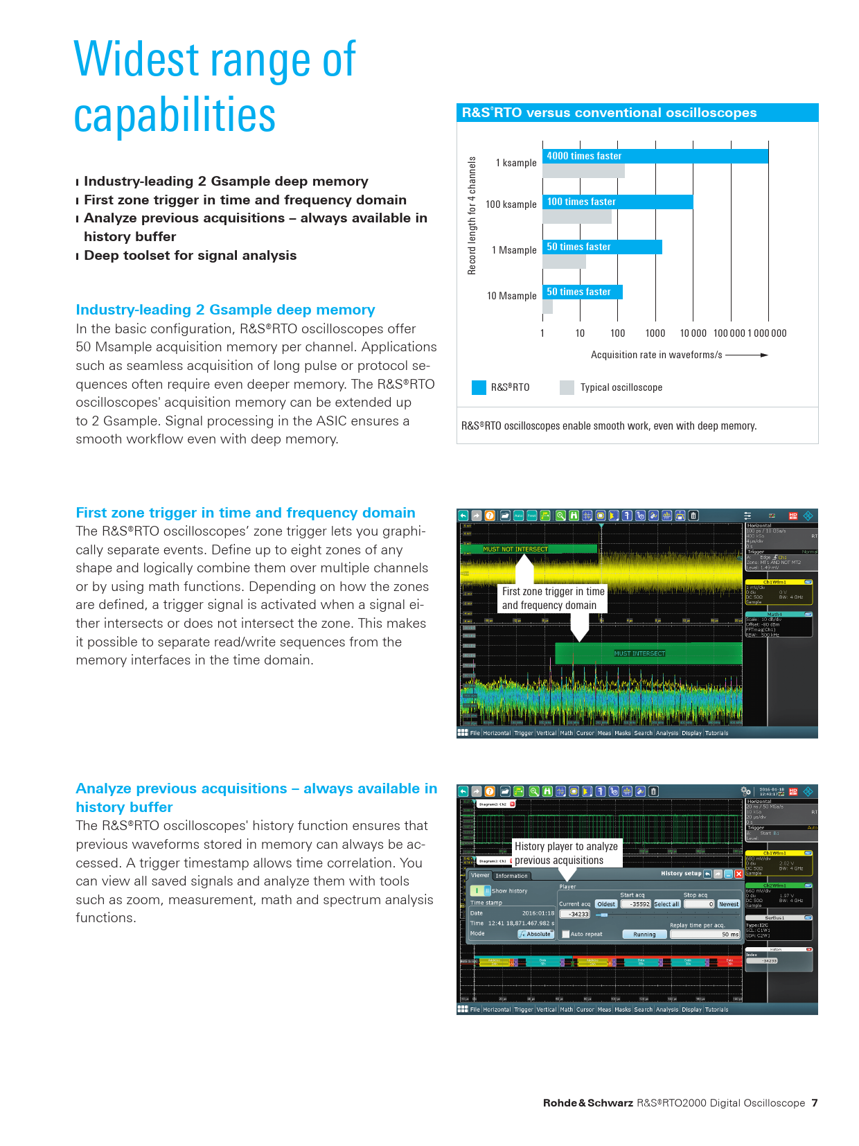

R&S®RTO versus conventional oscilloscopes. 4000 times faster. Industry-leading 2 Gsample deep memory
R&S®RTO versus conventional oscilloscopes 4000 times faster Industry-leading 2 Gsample deep memory
Widest range of capabilities
1 ksample ❙
hannels c ❙
First zone trigger in time and frequency domain
4 100 ksample
100 times faster
Analyze previous acquisitions – always available in
ngth for
history buffer
d le
50 times faster
1 Msample ❙
Deep toolset for signal analysis
cor Re 10 Msample
50 times faster Industry-leading 2 Gsample deep memory
In the basic configuration, R&S®RTO oscilloscopes offer 1 10 100 1000 10 000 100 000 1 000 000 50 Msample acquisition memory per channel. Applications Acquisition rate in waveforms/s such as seamless acquisition of long pulse or protocol se- quences often require even deeper memory. The R&S®RTO ¸RTO Typical oscil oscope oscilloscopes' acquisition memory can be extended up to 2 Gsample. Signal processing in the ASIC ensures a R&S®RTO oscilloscopes enable smooth work, even with deep memory. smooth workflow even with deep memory.
The R&S®RTO oscilloscopes’ zone trigger lets you graphi- cally separate events. Define up to eight zones of any shape and logically combine them over multiple channels or by using math functions. Depending on how the zones First zone trigger in time are defined, a trigger signal is activated when a signal ei- and frequency domain ther intersects or does not intersect the zone. This makes it possible to separate read/write sequences from the memory interfaces in the time domain.
Analyze previous acquisitions – always available in history buffer
The R&S®RTO oscilloscopes' history function ensures that previous waveforms stored in memory can always be ac- History player to analyze previous acquisitions cessed. A trigger timestamp allows time correlation. You can view all saved signals and analyze them with tools such as zoom, measurement, math and spectrum analysis functions.
