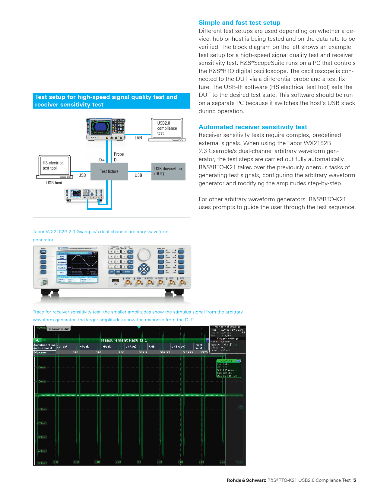

Simple and fast test setup. Test setup for high-speed signal quality test and. receiver sensitivity test
Simple and fast test setup Test setup for high-speed signal quality test and receiver sensitivity test
Different test setups are used depending on whether a de- vice, hub or host is being tested and on the data rate to be verified. The block diagram on the left shows an example test setup for a high-speed signal quality test and receiver sensitivity test. R&S®ScopeSuite runs on a PC that controls the R&S®RTO digital oscilloscope. The oscilloscope is con- nected to the DUT via a differential probe and a test fix- ture. The USB-IF software (HS electrical test tool) sets the DUT to the desired test state. This software should be run
on a separate PC because it switches the host's USB stack
during operation. USB2.0 compliance
Automated receiver sensitivity test
test Receiver sensitivity tests require complex, predefined LAN external signals. When using the Tabor WX2182B 2.3 Gsample/s dual-channel arbitrary waveform gen- Probe D+ D– erator, the test steps are carried out fully automatically. HS electrical test tool USB device/hub R&S®RTO-K21 takes over the previously onerous tasks of Test fixture (DUT) USB USB generating test signals, configuring the arbitrary waveform USB host generator and modifying the amplitudes step-by-step. For other arbitrary waveform generators, R&S®RTO-K21 uses prompts to guide the user through the test sequence. Tabor WX2182B 2.3 Gsample/s dual-channel arbitrary waveform generator. Trace for receiver sensitivity test: the smaller amplitudes show the stimulus signal from the arbitrary waveform generator, the larger amplitudes show the response from the DUT.
