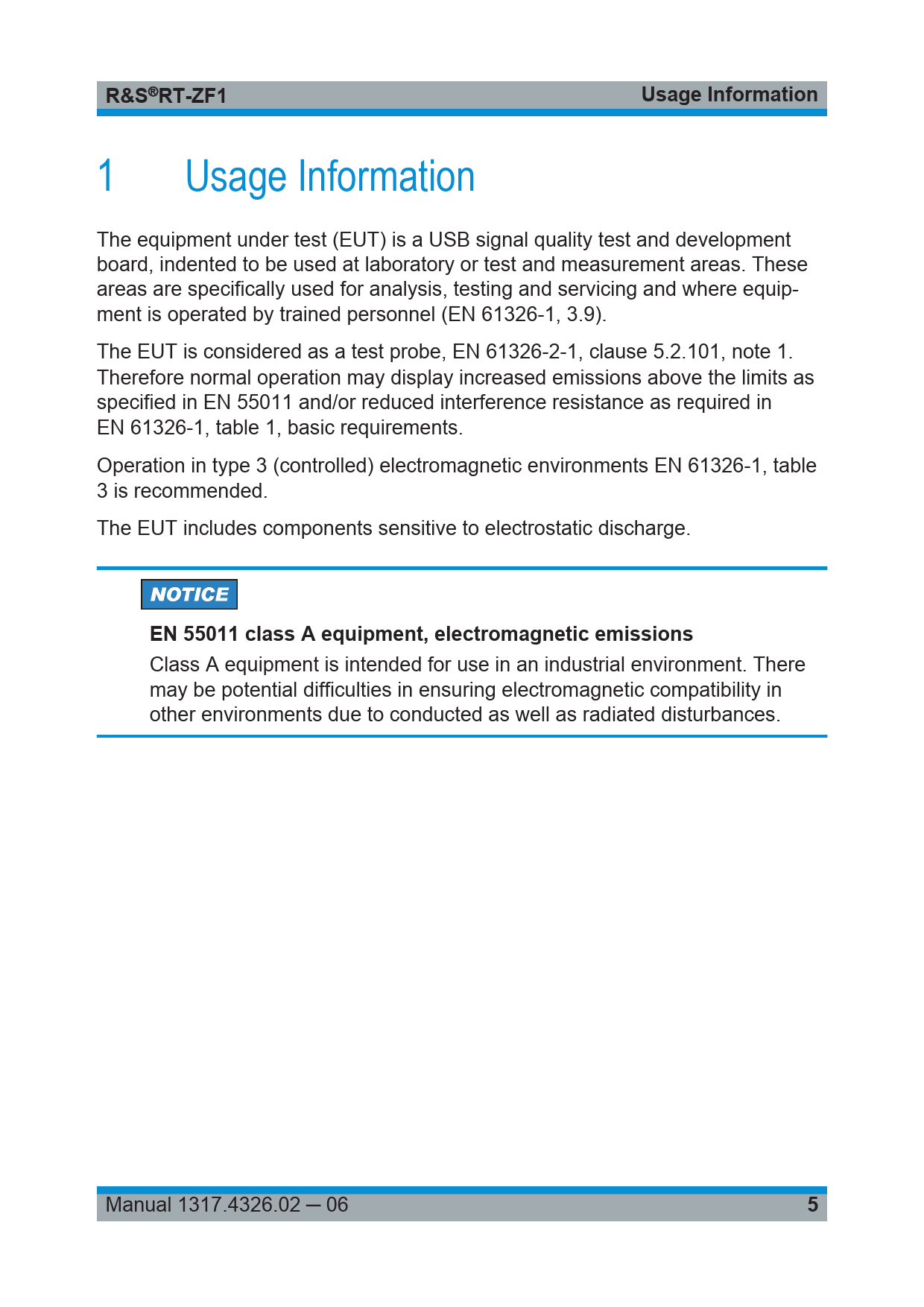

R&S. RT-ZF1. Usage Information. EN 55011 class A equipment, electromagnetic emissions
R&S RT-ZF1 Usage Information EN 55011 class A equipment, electromagnetic emissions
R&S
1 Usage Information The equipment under test (EUT) is a USB signal quality test and development board, indented to be used at laboratory or test and measurement areas. These areas are specifically used for analysis, testing and servicing and where equip- ment is operated by trained personnel (EN 61326-1, 3.9). The EUT is considered as a test probe, EN 61326-2-1, clause 5.2.101, note 1. Therefore normal operation may display increased emissions above the limits as specified in EN 55011 and/or reduced interference resistance as required in EN 61326-1, table 1, basic requirements. Operation in type 3 (controlled) electromagnetic environments EN 61326-1, table 3 is recommended. The EUT includes components sensitive to electrostatic discharge.
Class A equipment is intended for use in an industrial environment. There may be potential difficulties in ensuring electromagnetic compatibility in other environments due to conducted as well as radiated disturbances. Manual 1317.4326.02 ─ 06
5
