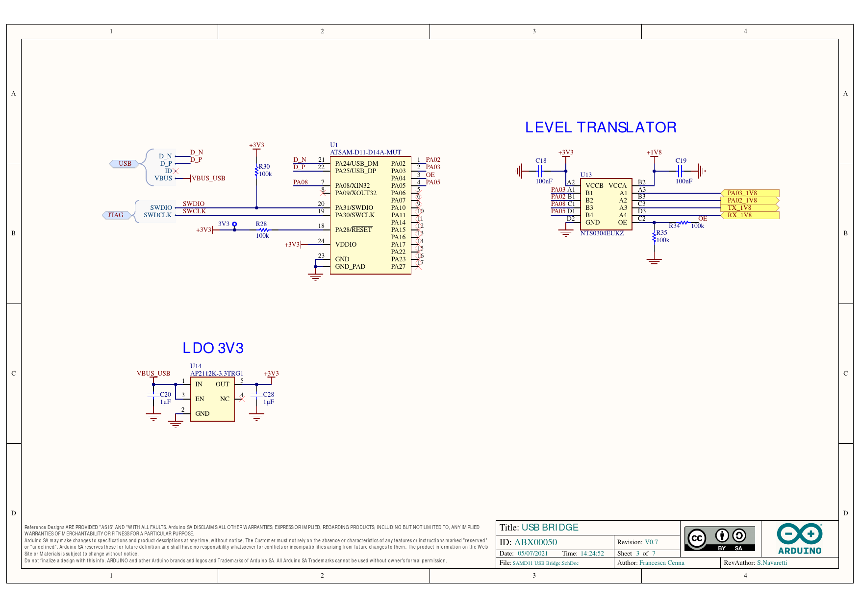

DescriptionThe Nicla Sense ME houses 4 low power sensors in a small footprint enabling powerful data fusion capabilities on the edge.
Pages / Page7 / 3 — LEVEL TRANSLATOR. LDO 3V3. USB BRIDGE
LEVEL TRANSLATOR LDO 3V3 USB BRIDGE
link to page 1 link to page 1 link to page 1 link to page 1 link to page 1 link to page 1 1 2 3 4 A A
LEVEL TRANSLATOR
+3V3 U1 D_N ATSAM-D11-D14A-MUT +3V3 +1V8 D_N D_P D_N 21 1 PA02 USB D_P PA24/USB_DM PA02 C18 C19 R30 D_P 22 2 PA03 ID PA25/USB_DP PA03 100k 3 OE U13 VBUS VBUS_USB PA04 PA08 7 4 PA05 100nF A2 B2 100nF PA08/XIN32 PA05 VCCB VCCA 8 5 PA03 A1 A3 PA09/XOUT32 PA06 B1 A1 PA03_1V8 6 PA02 B1 B3 PA07 B2 A2 PA02_1V8 SWDIO 20 9 PA08 C1 C3 SWDIO PA31/SWDIO PA10 B3 A3 TX_1V8 SWCLK 19 10 PA05 D1 D3 JTAG SWDCLK PA30/SWCLK PA11 B4 A4 RX_1V8 11 D2 C2 OE PA14 3V3 R28 GND OE 18 12 R34 100k +3V3 PA28/RESET PA15 B 13 NTS0304EUKZ R35 B 100k PA16 24 14 100k +3V3 VDDIO PA17 15 PA22 23 16 GND PA23 17 GND_PAD PA27
LDO 3V3
U14 C VBUS_USB AP2112K-3.3TRG1 +3V3 C 1 5 IN OUT C20 3 4 C28 EN NC 1µF 1µF 2 GND D D Reference Designs ARE PROVIDED "AS IS" AND "WITH ALL FAULTS. Arduino SA DISCLAIMS ALL OTHER WARRANTIES, EXPRESS OR IMPLIED, REGARDING PRODUCTS, INCLUDING BUT NOT LIMITED TO, ANY IMPLIED Title:
USB BRIDGE
