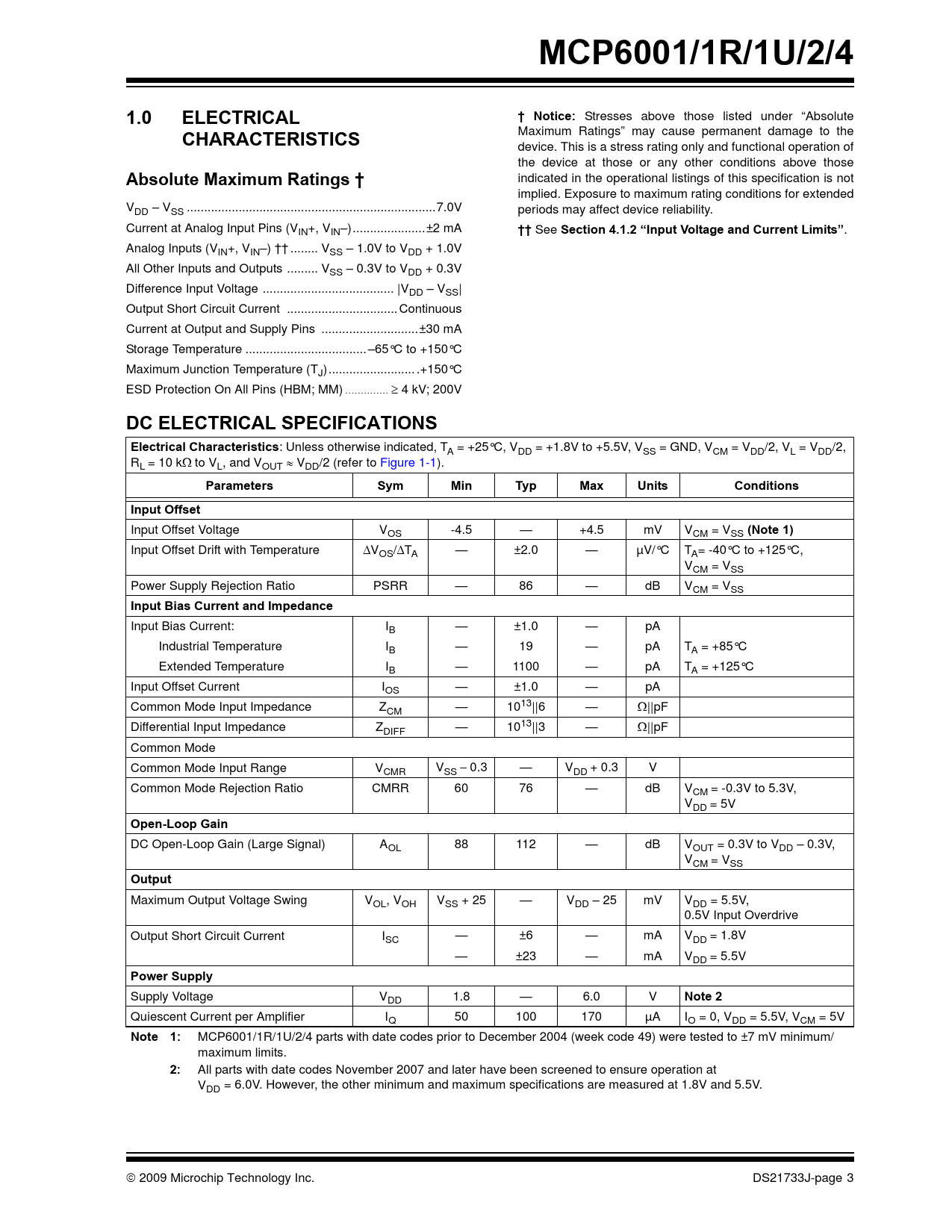

MCP6001/1R/1U/2/4. 1.0. ELECTRICAL. † Notice:. CHARACTERISTICS. Absolute Maximum Ratings †
MCP6001/1R/1U/2/4 1.0 ELECTRICAL † Notice: CHARACTERISTICS Absolute Maximum Ratings †
link to page 13 link to page 5 link to page 3 link to page 3
Stresses above those listed under “Absolute
CHARACTERISTICS
Maximum Ratings” may cause permanent damage to the device. This is a stress rating only and functional operation of the device at those or any other conditions above those
indicated in the operational listings of this specification is not implied. Exposure to maximum rating conditions for extended VDD – VSS ..7.0V periods may affect device reliability. Current at Analog Input Pins (VIN+, VIN–)...±2 mA
See
Section 4.1.2 “Input Voltage and Current Limits”
. Analog Inputs (VIN+, VIN–) †† .. VSS – 1.0V to VDD + 1.0V All Other Inputs and Outputs ... VSS – 0.3V to VDD + 0.3V Difference Input Voltage .. |VDD – VSS| Output Short Circuit Current .. Continuous Current at Output and Supply Pins ..±30 mA Storage Temperature ... –65°C to +150°C Maximum Junction Temperature (TJ)... .+150°C ESD Protection On All Pins (HBM; MM) .. ≥ 4 kV; 200V
DC ELECTRICAL SPECIFICATIONS Electrical Characteristics
: Unless otherwise indicated, TA = +25°C, VDD = +1.8V to +5.5V, VSS = GND, VCM = VDD/2, VL = VDD/2, R ≈ L = 10 kΩ to VL, and VOUT VDD/2 (refer to Figure 1-1).
Parameters Sym Min Typ Max Units Conditions Input Offset
Input Offset Voltage VOS -4.5 — +4.5 mV VCM = VSS
(Note 1 )
Input Offset Drift with Temperature ΔVOS/ΔTA — ±2.0 — µV/°C TA= -40°C to +125°C, VCM = VSS Power Supply Rejection Ratio PSRR — 86 — dB VCM = VSS
Input Bias Current and Impedance
Input Bias Current: IB — ±1.0 — pA Industrial Temperature IB — 19 — pA TA = +85°C Extended Temperature IB — 1100 — pA TA = +125°C Input Offset Current IOS — ±1.0 — pA Common Mode Input Impedance ZCM — 1013||6 — Ω||pF Differential Input Impedance ZDIFF — 1013||3 — Ω||pF Common Mode Common Mode Input Range V − CMR VSS 0.3 — VDD + 0.3 V Common Mode Rejection Ratio CMRR 60 76 — dB VCM = -0.3V to 5.3V, VDD = 5V
Open-Loop Gain
DC Open-Loop Gain (Large Signal) AOL 88 112 — dB VOUT = 0.3V to VDD – 0.3V, VCM = VSS
Output
Maximum Output Voltage Swing VOL, VOH VSS + 25 — VDD – 25 mV VDD = 5.5V, 0.5V Input Overdrive Output Short Circuit Current ISC — ±6 — mA VDD = 1.8V — ±23 — mA VDD = 5.5V
Power Supply
Supply Voltage VDD 1.8 — 6.0 V
Note 2
Quiescent Current per Amplifier IQ 50 100 170 µA IO = 0, VDD = 5.5V, VCM = 5V
Note 1:
MCP6001/1R/1U/2/4 parts with date codes prior to December 2004 (week code 49) were tested to ±7 mV minimum/ maximum limits.
2:
All parts with date codes November 2007 and later have been screened to ensure operation at VDD = 6.0V. However, the other minimum and maximum specifications are measured at 1.8V and 5.5V. © 2009 Microchip Technology Inc. DS21733J-page 3 Document Outline 1.0 Electrical Characteristics 1.1 Test Circuits FIGURE 1-1: AC and DC Test Circuit for Most Specifications. 2.0 Typical Performance Curves FIGURE 2-1: Input Offset Voltage. FIGURE 2-2: Input Offset Voltage Drift. FIGURE 2-3: Input Offset Quadratic Temp. Co. FIGURE 2-4: Input Offset Voltage vs. Common Mode Input Voltage at VDD = 1.8V. FIGURE 2-5: Input Offset Voltage vs. Common Mode Input Voltage at VDD = 5.5V. FIGURE 2-6: Input Offset Voltage vs. Output Voltage. FIGURE 2-7: Input Bias Current at +85°C. FIGURE 2-8: Input Bias Current at +125°C. FIGURE 2-9: CMRR, PSRR vs. Ambient Temperature. FIGURE 2-10: PSRR, CMRR vs. Frequency. FIGURE 2-11: Open-Loop Gain, Phase vs. Frequency. FIGURE 2-12: Input Noise Voltage Density vs. Frequency. FIGURE 2-13: Output Short Circuit Current vs. Power Supply Voltage. FIGURE 2-14: Output Voltage Headroom vs. Output Current Magnitude. FIGURE 2-15: Quiescent Current vs. Power Supply Voltage. FIGURE 2-16: Small-Signal, Non-Inverting Pulse Response. FIGURE 2-17: Large-Signal, Non-Inverting Pulse Response. FIGURE 2-18: Slew Rate vs. Ambient Temperature. FIGURE 2-19: Output Voltage Swing vs. Frequency. FIGURE 2-20: Measured Input Current vs. Input Voltage (below VSS). FIGURE 2-21: The MCP6001/2/4 Show No Phase Reversal. 3.0 Pin Descriptions TABLE 3-1: Pin Function Table 3.1 Analog Outputs 3.2 Analog Inputs 3.3 Power Supply Pins 3.4 Exposed Thermal Pad (EP) 4.0 Application Information 4.1 Rail-to-Rail Inputs FIGURE 4-1: Simplified Analog Input ESD Structures. FIGURE 4-2: Protecting the Analog Inputs. 4.2 Rail-to-Rail Output 4.3 Capacitive Loads FIGURE 4-3: Output resistor, RISO stabilizes large capacitive loads. FIGURE 4-4: Recommended RISO values for Capacitive Loads. 4.4 Supply Bypass 4.5 Unused Op Amps FIGURE 4-5: Unused Op Amps. 4.6 PCB Surface Leakage FIGURE 4-6: Example Guard Ring Layout for Inverting Gain. 4.7 Application Circuits FIGURE 4-7: Instrumentation Amplifier with Unity-Gain Buffer Inputs. FIGURE 4-8: Active Second-Order Low-Pass Filter. FIGURE 4-9: Peak Detector with Clear and Sample CMOS Analog Switches. 5.0 Design AIDS 5.1 SPICE Macro Model 5.2 FilterLab® Software 5.3 Mindi™ Circuit Designer & Simulator 5.4 Microchip Advanced Part Selector (MAPS) 5.5 Analog Demonstration and Evaluation Boards 5.6 Application Notes 6.0 Packaging Information 6.1 Package Marking Information
